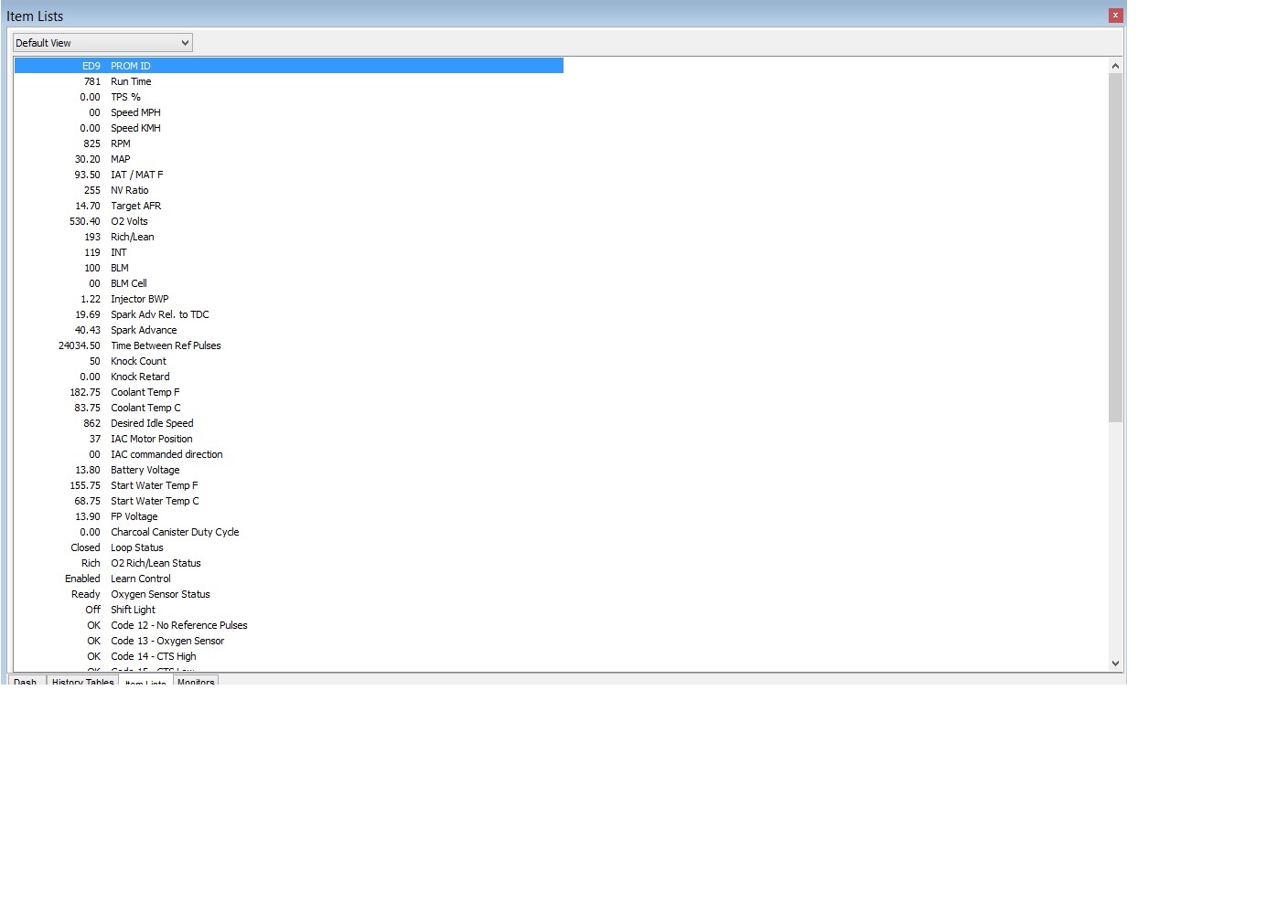

Re: 3.1 engine ignition(?) problem
Heres a quick pic of my datalog of my beretta idling (warm). I have some dataloggin files around but will take even more if needed.
Heres the warm idle file
I'll let someone more knowledgeable comment on your readings.
