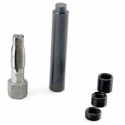

I prefer knurls, but heli-coil is good ,no doubt.

Do knurled pressed in inserts hold up well on Quad 4 heads? Would you use steel ones?

Yes, they do hold up well. And yes I did. On the SCX. Number three spark plug hole was stripped I discovered upon changing the spark plugs shortly after getting it. I knurled it and it held up terrific. I even removed the plug several times to check on it.ErichZ26 wrote:SuzukiGhostRider wrote:If anyone is unsure what a heli-coil is or how to do it, it's SLIGHTLY involved. I found a video for anyone who needs a demonstration or tutorial.

I'm not a fan of a pressed in insert since its a non threaded mating surface your now relying on holding. Granted they probably work great for some applications, but for a part thats taking a lot of clamping force I prefer to use the helicoil.
Really with the helicoil all your adding is the steel threads between the part you are installing and un-installing on a repetitive basis so they wont wear out as easily as the aluminum ones would have.

How is it non threaded?3X00-Modified wrote:I'm not a fan of a pressed in insert since its a non threaded mating surface your now relying on holding. Granted they probably work great for some applications, but for a part thats taking a lot of clamping force I prefer to use the helicoil.

Is your take on a knurled thread insert different from the catalog?

Your pressing in the insert into the material correct? that would make the insert and the mating surface not threaded together. If your not pressing it in then its not a knurled insert. I feel something like that can be pulled out eventually since its only friction holding it in and not the physical interference of a thread.SuzukiGhostRider wrote:How is it non threaded?3X00-Modified wrote:I'm not a fan of a pressed in insert since its a non threaded mating surface your now relying on holding. Granted they probably work great for some applications, but for a part thats taking a lot of clamping force I prefer to use the helicoil.
Think of it this way, you press the insert in, you bolt the headers to it... that insert is now holding the headers to the head, but if the insert begins to slip out then the headers are not flush against the head anymore but your bolt is still tight as hell.

This is what I'm referring to, and what we call a knurl set around here. Note the threads , both inner and outer.
