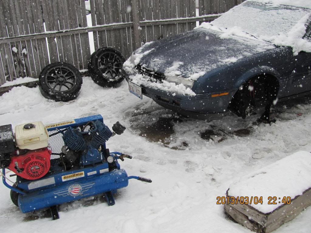

hahaha, yep, right there with you! It makes no sense, but I see it as an adventure! Beretta and man vs the elements. Remember earlier this year when I installed my Wilwoods in the middle of a snowstorm:LOL 2nd that. Why am I trying to seal the cowl in temps that are not good for it? Gee, some people have no self control.

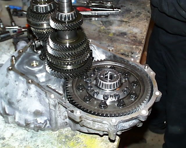

Got my inserts today...score! I figure since I got to remove the tranny to get my complete slave cylinder out and replaced, I might as well take advantage of it. New clutch and a lightweight Fidanza flywheel is in order for operation "Save Abigail." Anybody have some good clutch disc/pressure plate brand suggestions that I should look into?

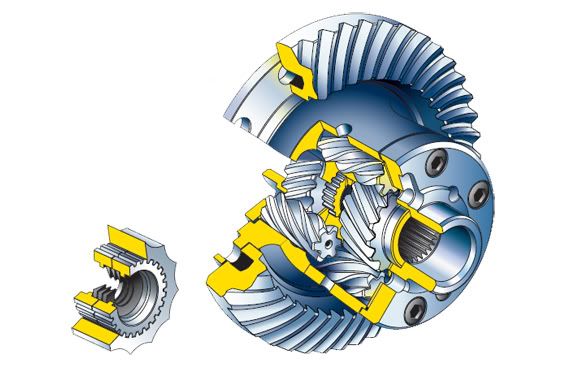

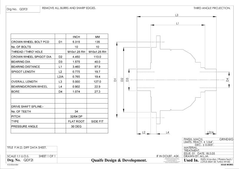

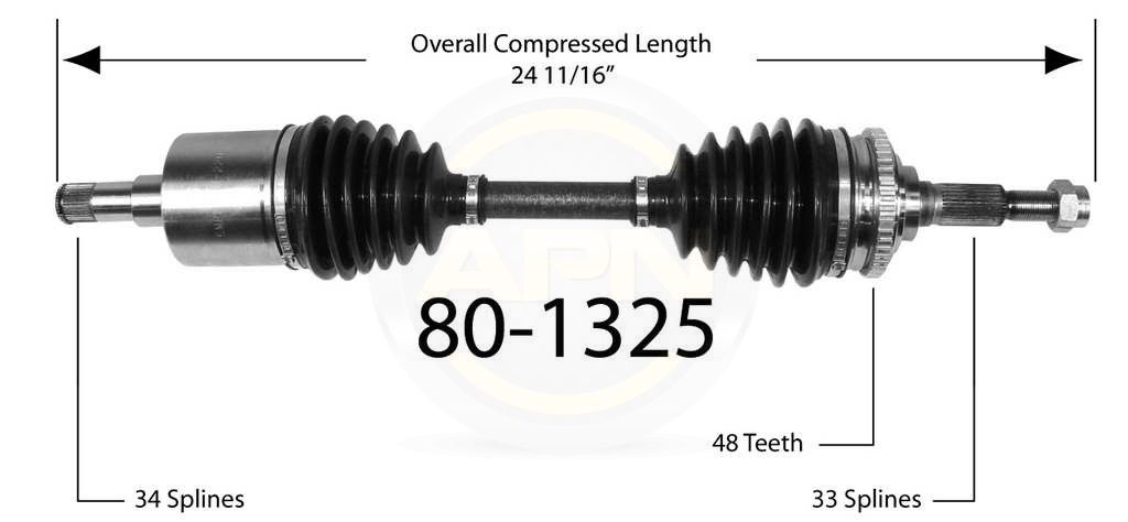

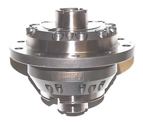

Now I'm debating to upgrade a few things, it's a decision point that I have to responsibly plan out. While the transmission is pulled out to address all the important issues, I'm debating whether to put in a Fidanza lightweight aluminum flywheel ($350) or bite the bullet to be the first person to install a Quaife QDF2I LSD in a 2.2L Beretta ($1200). It's experimental, and an expensive one at that if It doesn't work out. All my research points to it working as its compatible with isuzu derived transmissions (i.e. impulse XS, stylus XS, elan M100).
The spline count matches up with the Beretta half-shafts;
I won't be ready to order the parts until at least next Friday, so it'll give me time to think this through. It drives me crazy because I want that LSD to dramatically improve my cornering speed, but that money I will be putting up gives me cold feet!

Limited slip, especially being a gear type is one of the best upgrades I ever did.
