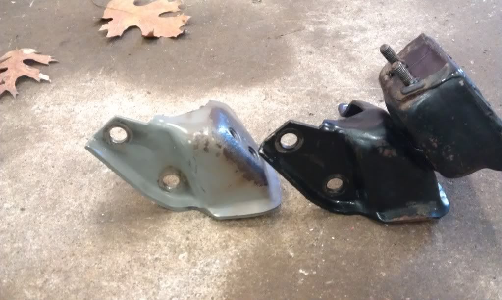

I've only ever seen that style on j bodies... and i think most were 2.2 5speeds.
Alpinestar10
- Posts: 452
- Location: GRAND RAPIDS MI
Re: Roberts 89GT Engine build.
2.2 cavalier 5 speeds Never came with a jackshaft... they had a long axle on the passenger side. Barry the 94 jackshaft is Bracket specific you can use a stamed steel bracket on this shaft but the cast Steel "not aluminum" Bracket "like some j body guys have said" is only 94...
EVERY 94 bracket ive seen have been cast
- scd88ga
- Posts: 1828

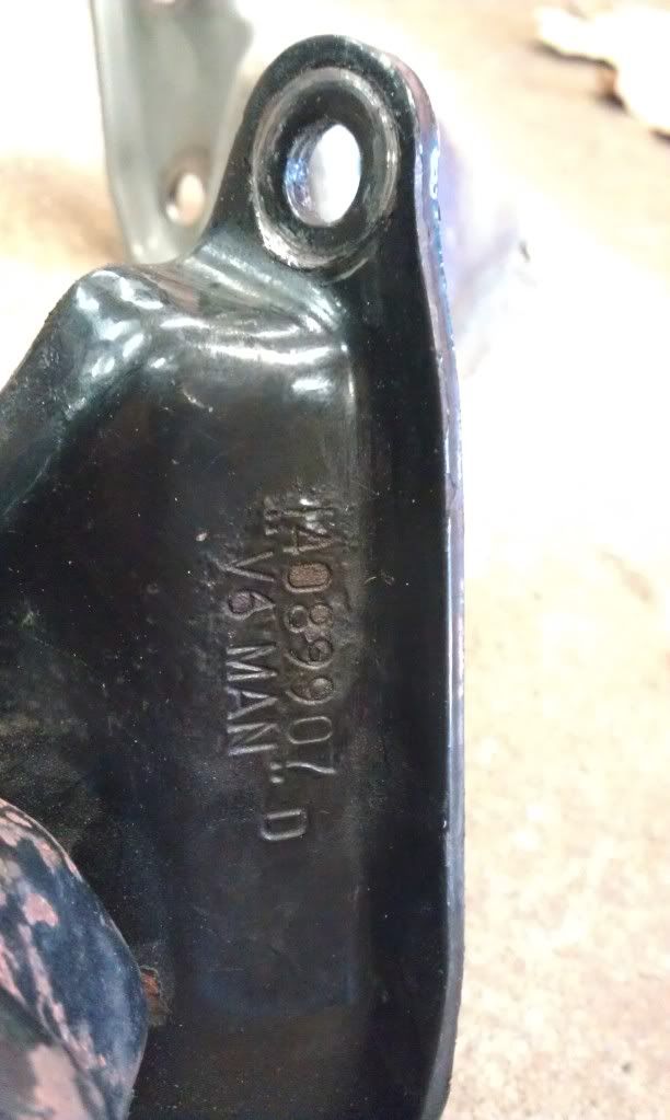

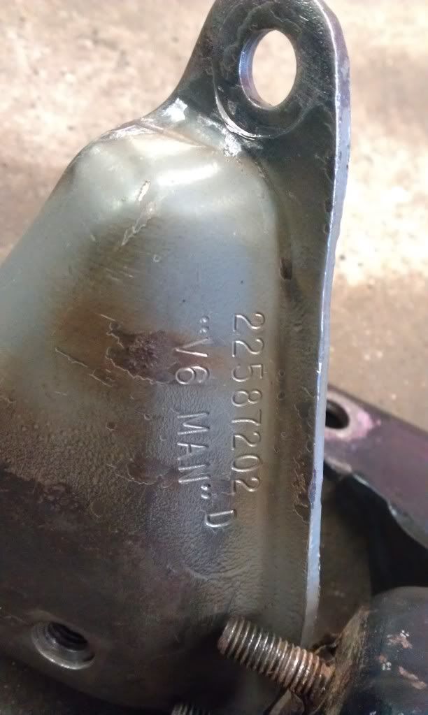

This style was used only on V6 5 speed J bodies in 94, and Quad 4 HO 5 speeds in 94, but do not interchange with each other due to obvious reasons (cast bracket shaped different for the mounting holes). I thought that providing pictures in this thread for both of these would have been sufficient... I guess not...1988GTU wrote:I've only ever seen that style on j bodies... and i think most were 2.2 5speeds.
Thanks you thank you thank you! I don't know why this is still even being discussed after I have already verified this by photo evidence, and by part number on both parts!Alpinestar10 wrote:2.2 cavalier 5 speeds Never came with a jackshaft... they had a long axle on the passenger side. Barry the 94 jackshaft is Bracket specific you can use a stamped steel bracket on this shaft but the cast Steel "not aluminum" Bracket "like some j body guys have said" is only 94...
I have been told of a possible variation in the exterior casting of the 3400 block on 02+ engines. This would coincide with my theory of why the jack shaft did not sit flush with the block when Jon test fitted it. It's takes a fairly simple modification to make it work because of this.
I really don't need to be told I'm wrong and to have my knowledge second-guessed when it comes to parts, especially when adequate information has been already provided.
Can we please move on from this now!

Part Number may be different but that could be due to it being an 89 Mount vs a 94 mount.
