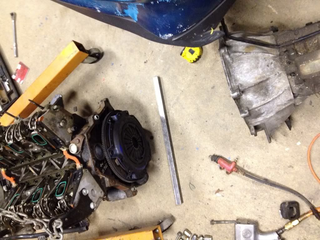

Pulled motor and trans back out and started playing with clutches and flywheels. The FWD flywheel is not campatible with the t5, even though the disk fits the shaft. So I got a camaro flywheel and almost new LUK clutch today. The camaro flywheel is thicker and offset. Hopefully I can use that flywheel with my FWD spec stage 3 clutch, because it may grab better than a stock 2.8 camaro clutch. If not, then LUK it is. Drifting is real hard on clutches....

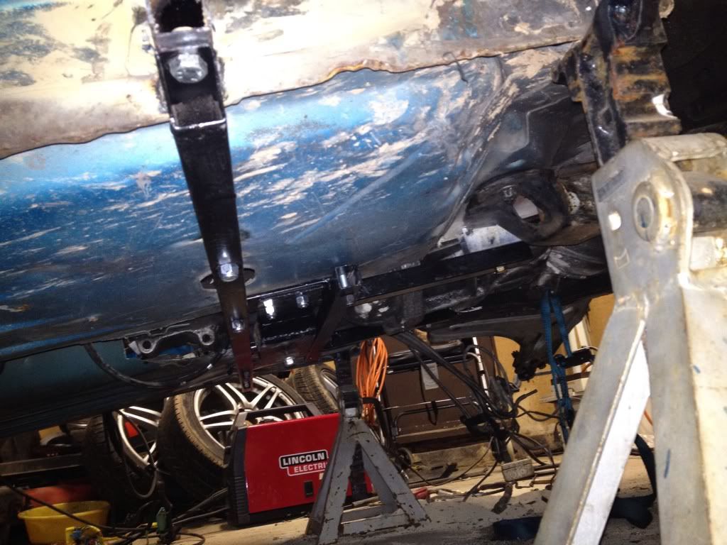

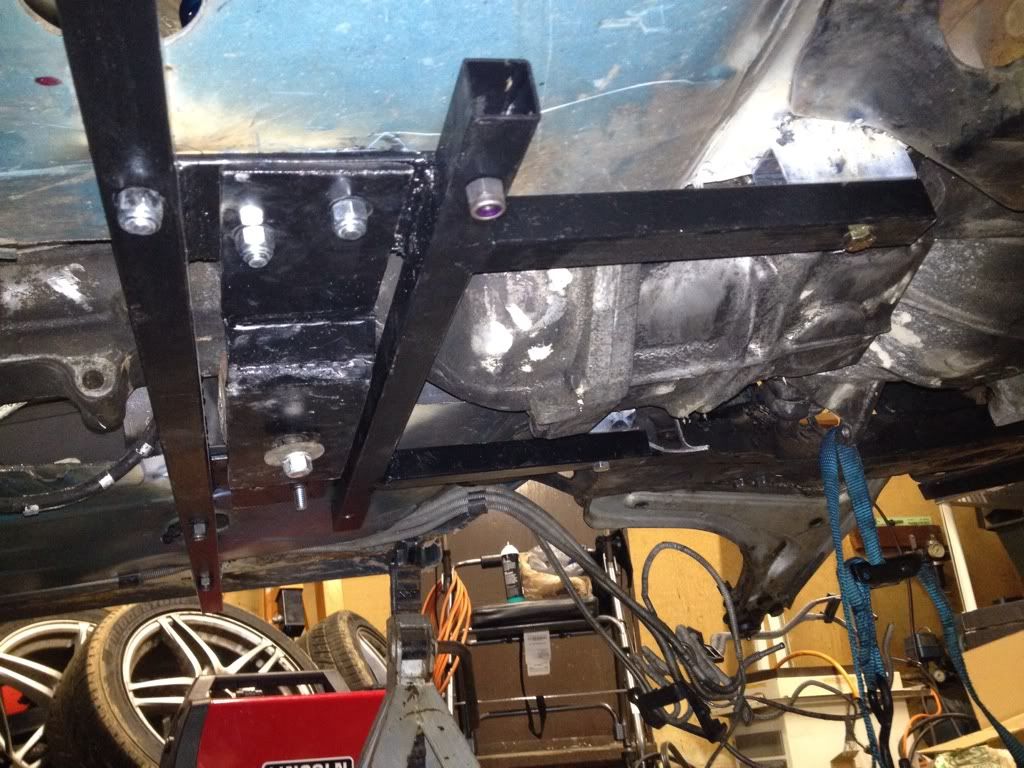

Heres my under car floor/trans/tunnel/subframe connector. I can jump on the floor now with minimal flex. I love it. I would of welded it but went with bolts to make trans removal easier.
Starting on tunnel. Making it out of 1/8" sheet is a waste of my time and adds weight but oh well, its what I have.

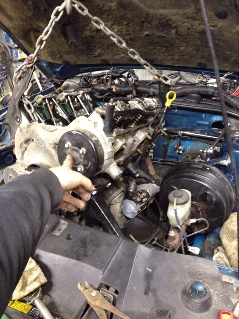

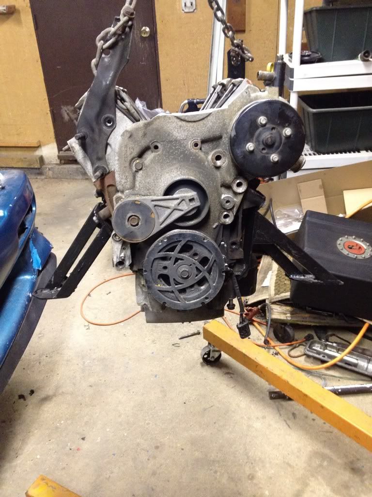

My motor has feet does yours?

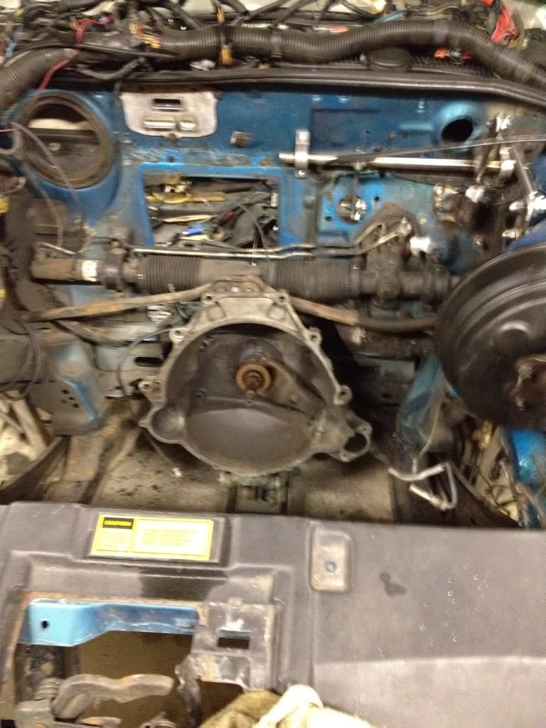

Trans still in
Playing with clutch combos
Clutch is gonna be fun. Toyota hydraulics, fwd clutch, rwd flywheel. Fun Fun

Another issue I will need to cross is the fact that my TCE crank trigger wont work with the camaro front pullies. Its either make megasquirt work with the stock 3500 sensor which some people are doing now, or mount the tce trigger a different way

use a internal trigger and sell the external one superdave and marsman hacked up their trigger wheel and made that would which imo is a waste/.
