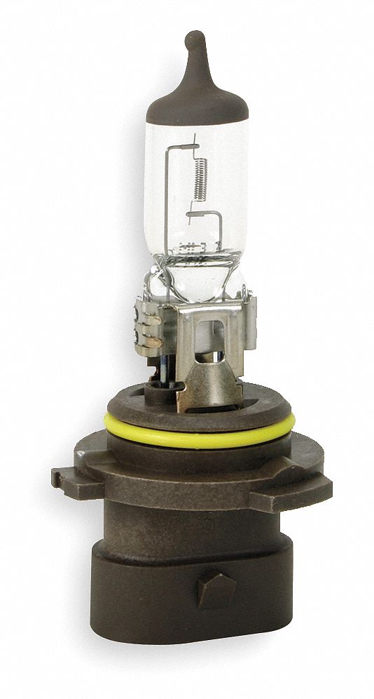

heavywoody wrote:Getting the truck lenses for like an 88 GMC truck from LMC trucks allows to use the factory bulbs so you don't have to mess with the wiring. Just a heads up!
Explain this one to me... With the 90* bend on the back of the stock bulb I was unable to use those with my LMC lights... I had to use the straight 9005/9006 variation... Granted yes I was able to keep the factory plugs, but the bulb itself was different..
I have this style now...
Vs stock
Re: The Derretta, 1994 base with some attitude.
I'll look on my car, but I don't remember having that issue. I may have noticed it when I cut the header panel and made appropriate cuts to compensate for it.
Posts: 10915
I don't believe it was the header panel that was in the way... I feel like it was the Euro headlight housing itself.
Nicjensen
Posts: 38
Re: RE: Re: The Derretta, 1994 base with some attitude.
Post by Nicjensen »
3X00-Modified wrote:I don't believe it was the header panel that was in the way... I feel like it was the Euro headlight housing itself.
Your right, you have to notch out the euro housing to use the right angle plug. Here's a picture of mine.ImageImageImage

Posts: 10915
Ok, I'm not going crazy... :)
I also tried the LED lights in my Euro housings... I was far from impressed on the light output from them... Looked cool, but did not provide enough light so that's why I went back to Silverstar bulbs... 9006xs and 9005xs... Not many brands make the XS version.
