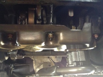

- My LQ1 is super-clean inside. Not enough miles on it yet to worry about carbon build-up, and zero sludge.
I completed the oil-pan install, turbocharger's oil return line, and 95% of the oil supply line -I still need to get a Tee fitting to feed the OPSU and the supply line, and attach the bracket to mount the oil-cooler to. I ultimately reused the car's original transmission cooler-lines to supply oil to the cooler then on to the turbo -I already know they handle high temperature petroleum under pressure, and I only had to rework the ends a little. The cooler itself was pulled from a Chevy truck IIRC, with the quick-connect fittings swapped out for inverse flare.

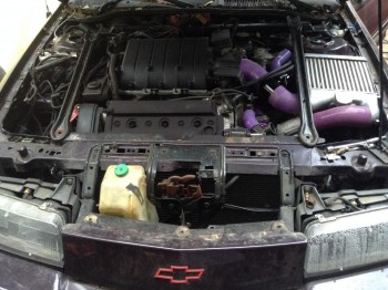

- This is how the bay looks right now.
I plan on using stainless steel straps to hold the silicone intake fittings to the intercooler, with the T-Band clamps attaching the assembly to the throttle-body and the turbo. Should be very secure, clean, and compact. I still have to fab-up a bypass pipe from the valve to the intake pipe between the MAF and the turbo inlet, but I have a few of these silicone hose pieces from the Civic hose kit I bought. The color of the silicone couplers look very different in the picture, and there has been some UV fading from the parts sitting in the car, but it is all the same color except for the intake pipe from the turbo to the intercooler, which is unfortunately a shade off. I also have to make the dump-pipe from the wastegate, and build the exhaust system. Additionally, I need to install the clutch pedal assembly, but the hole for the master cylinder has already been cut.

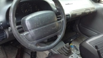

- 5-Speed Z-26! Almost...
Still a long way to go, but it is getting close to the first test-start...

I know you talked about it, in terms of ducting air over the Intercooler...are you doing a Z34 cutout or run cool air from the bottom. Its super duper tight in there as it appears...
Re: Finally...
Posted: Tue May 29, 2018 2:28 am
by Rettax3
nocutt wrote:DANG!! fast indeed...
280ZX Turbo hood-scoop, just like the one on my '90 Turbo 'Retta. A NACA-style inlet in the front (these have virtually no drag, yet allow air in and since the path widens, air slows down and
increases pressure -perfect for both heat transfer and ram-air induction) will pull fresh air in, just in front on the intercooler. This will feed ram-air to the intake air filter, and push pressurized air under the intercooler. More air will be supplied to the same area from the 3.5" hole that sat under the original battery tray, that air comes from the high-pressure area in front of the radiator that then goes in front of the splash-guard. This high-pressure air under the intercooler will be happy to rise up through it and extract through the back half of the 280ZX hood-scoop, which is a large vented grill. If I am not happy with the amount of air-flow through the IC, I could attach a small air-dam in front of the grill to create an even lower-pressure area, but I don't want to if I don't have to. So, the air will actually rise up through the IC to escape to ambient.

Car is officially a five-speed Z-26! Yay! My Master Cylinder looks like it is leaking. Boo! It may just be caused by an air-bubble that got in there from sitting, I don't know. I will give it a chance to heal itself (yeah, right) after bleeding the system out. So far as Master Cylinders go, has anyone figured out what the differences are between the early '88 design (like mine) and late '88-92 design? On the slaves, the difference is obvious, but the masters have the same bore and stroke, and I can't see any difference in the housing, unless the new ones have more of an angle tilting them downward?
I have also ordered a set of #3 AN adapters for the Slave and Master cylinders, but rather than going with the steel braided clutch line, I will be fabricating my own (shocker) out of rigid steel brake line and new AN tube-nuts -absolutely nothing to dry-rot out other than the X-rings in the fittings and of course the packings in the cylinders themselves. In all, I should have my new all-metal clutch line in for less than $30, not including the 37-degree AN flaring tool I had to buy for this to fab the line, which I am sure I'll use elsewhere too. The turbo practically rests on the original plastic hydraulic line. On my '90 Turbo 'Retta, I had soldered copper tubing onto the OE clutch line fittings to reroute away from the T-04's heat and get rid of the plastic -meant as a temporary solution, it has been 100% for me for several years now, so I am not in any hurry to replace that setup, but nor do I want to duplicate it.

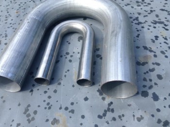

Slow work on the LQ1 this week -a lot of other work going on. I got the wrong U-bend pipe -I was trying to get a 2.25-inch pipe for the passenger-side tail-pipe from the muffler to the tips, but was sent a super-tight radius 1.5 inch pipe instead -okay, I'll use it then! So, I have it rough-cut for the waste-gate dump-pipe, and it is tight enough that I can run it under the turbo and still meet up to the 3-inch downpipe without interfering with the transmission shifter linkage.
- Honda Civic vs Turbo LQ1 -not good for a down-pipe, but 1.5 inch is perfect for the dump-pipe.
I have also been having some difficulty matching up my T-04's outlet with the right size flange for the downpipe -partly because I haven't tried very hard, partly because I don't want to spend very much, partly because my old setup with this turbo used a 2.5-inch downpipe. So, reduce (not the exhaust size though), reuse, and recycle!

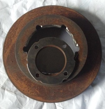

- Not used for stopping anymore, this brake rotor at least helped keep me going today.

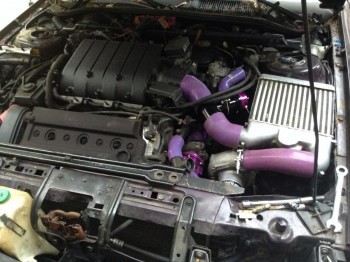

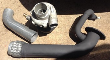

Down-pipe and dump-pipe assembly is finished. I have some hesitations about this not having a flex-joint of any kind in the dump-pipe, but I'm hoping the 1.5-inch pipe itself has enough flexibility not to bugger things up. I'm also not crazy about the fact that the turbocharger needs to be removed to get the dump-pipe out from under to remove the down-pipe assembly, but this is a compromise for ditching another joint in the assembly that could eventually leak, and still keep everything tucked-in tight, with as little extraneous piping as possible.
- Using a new-type welding wire. Not sure I like it as much as the old stuff I've used for years, I'm learning a few tricks with it though. VHT will hopefully keep it protected, and I'll wrap it later to control the heat.
I've got it routed well away (relatively) from the ABS and master-cylinder, I think it will be fine with just the header-wrap. Still might need a turbo blanket though... I'll likely also insulate the bottom of the ABS unit, so long as it can still dissipate its' own heat.
