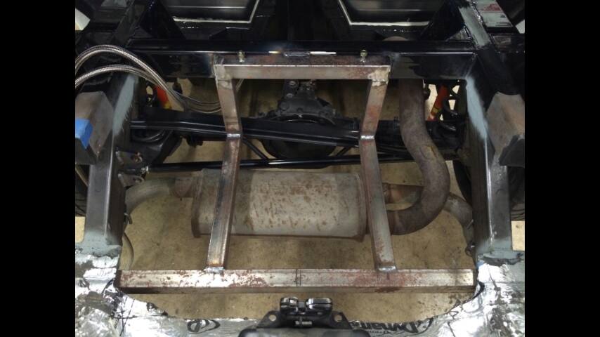

hey guys !!!! thought i posted these a while back.....
All stainless braided fuel lines ran, stealth 15 gal aluminum fuel cell, and exhaust re routed and re hung

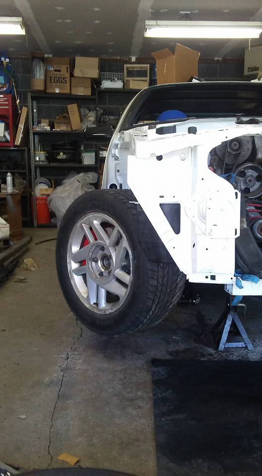

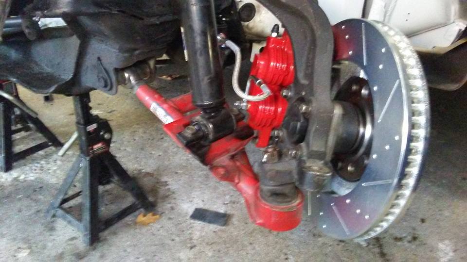

by jjanke
Super pumped to finally be making some progress on the front steering and suspension upgrades the Beretta/ Camaro..... Modded spindles/ knuckles by Jenson Keyes. Spohn Lower Tubular control arms, flaming River power steering rack. With custom made lines by Pirtek hydrolics, LS1 power stop brake kit.
Gonna smooth out some flanges on the engine cradle to ease the tires where they rub at full lock. But over all really happy with the new steering angle. Thanks also to Drew Meyer for his tech tips and the hook up on these driftmaro parts !!!

by weba
That is most likely biggest steering angle ever in anything that even remotely looks like Beretta

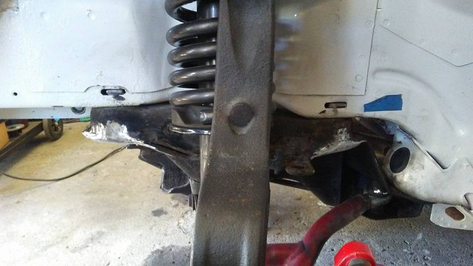

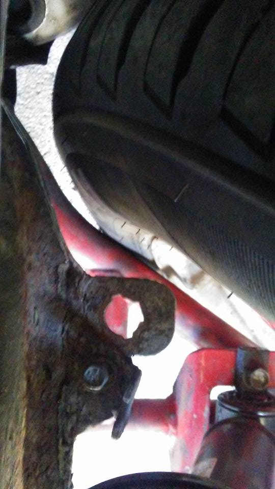

by jjanke

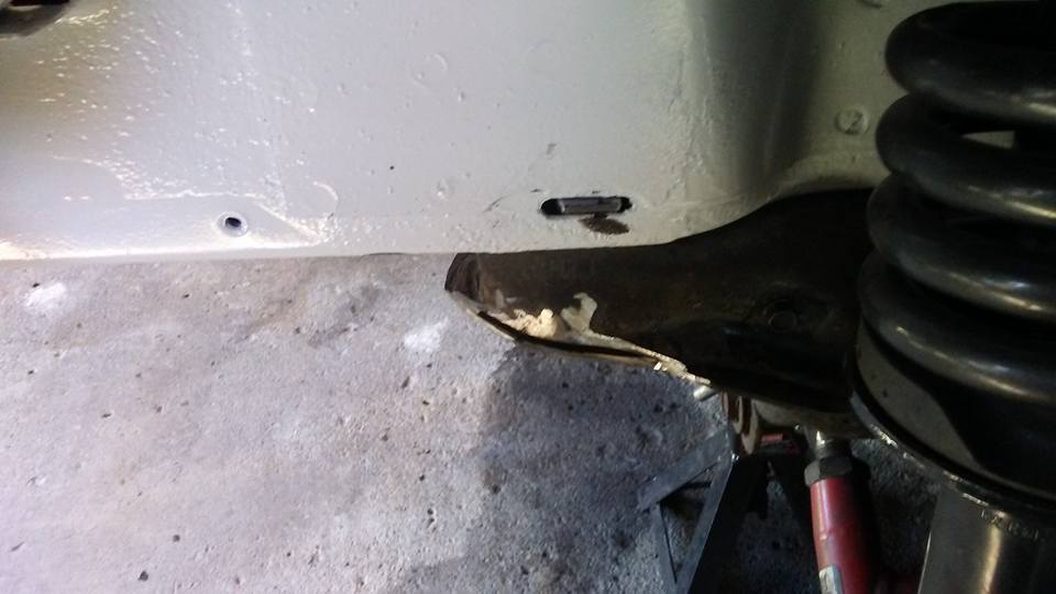

Smoothed out some flanges on The engine cradle and welded em up to prevent the tire rubbing at full lock. And squeeze another degree out of the steering angle.

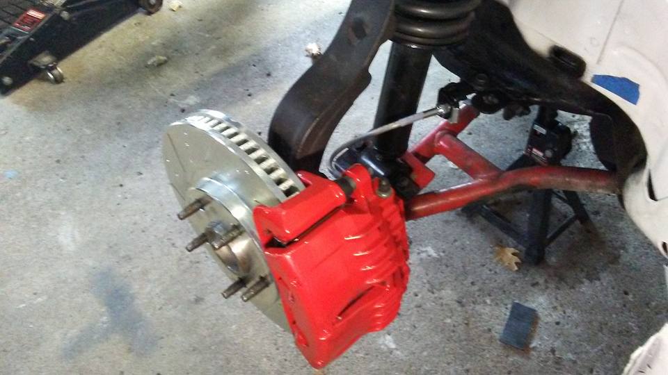

by jjanke

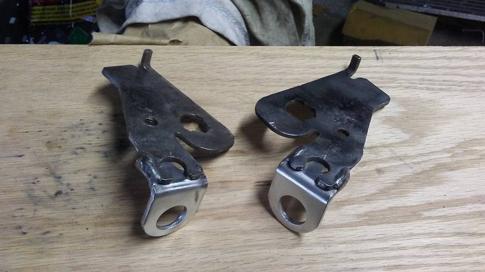

Modified the front brake hose bracket to accept the hose from the face instead of the top and was able to make these SJM performance braided steel brake hoses work from lock to lock.

by bonecrrusher
Are the lower arms still powder coated?
I know its a drift car - but clean them up with some degreaser - the new calipers make them look terrible!
LOL...
Re: Beretta Z28
Posted: Mon Oct 17, 2016 7:38 am
by jjanke
Believe it or not .....I tried......they might need a fresh coat of spray paint :/
