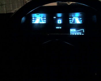

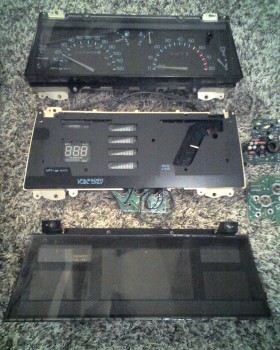

I was pushing to the point of wanting a sledge-hammer for the '90 Turbo 'Retta a couple of weeks ago -I just couldn't get her to stop bleeding oil. Until I finally switched-out the aluminum tubing for the turbo's oil-supply with copper -I think I mentioned that here already, just not the extent of my frustration with it. I've also ordered a Dakota Digital SGI-5 to correct the speedometer issues, that way I can use the Cavalier Z-24 Getrag 282 with the 'wrong' VSS and use the original instruments from the car. I have given up finding another good Z-24 digital instruments cluster for a reasonable price. Too bad, it looked really good in the car...
Top to Bottom:<br />-Original Gauge Cluster from the Turbo 'T-Type' 'Retta.<br />-Modified Z-24 Digital Instruments (Analog Tach).<br />-OE Digital Beretta Instruments.
Top to Bottom:
I made a translucent blue cover-lens for the cluster too.
Or, I can use the SGI-5 on the S-15 Blazer digital instruments I have in the car now, but I still wouldn't have a functional tach since the Blazer uses a distributor, and I would have to tinker with a pickup-coil to make a signal generator for the instruments.
S-15 digital instruments, currently in the '90 'Retta.
