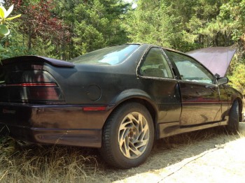

Found a BRM (Black Rose Metallic) Z-26 at a local yard, and got a bunch of parts for the Zs (both of my '95 Z-26s are BRM). Washed the old '95 Z-26, and replaced the deck-lid that was on loan from the Teal Indy (that car has a replacement deck-lid with a Fiero GT wing spoiler). Then, I started peeling the flat-black Plasti-Dip from the spare white rear bumper-cover the Z was wearing, and will replace it with the salvaged BRM cover. Lastly, I will switch-out the damaged right-side ground effects for the new one, and see if I can replace the quarter-window rubber trim without too much trouble. I wish I had gotten to the yard early enough to snag the front bumper-cover too, but I think the car has been crushed now.

Got all the body-work pieces installed yesterday, and decided to attack the failing water-pump. Replaced the Duralast that has been in there for the last decade (I think) and put in a Gates. Sadly, the Duralast pump is probably fine -the pulley has a slight wobble to it (I thought it was the pump), and the noise I've been hearing is mostly the A/C compressor -I should have checked it out better. BUT, it is a good thing I got into it, because I found that the tensioner was completely stuck. I couldn't find the near-new spare one I have that came with the new Z's engine, so I tried rebuilding the old one. It was packed with corrosion and dried-out antifreeze (this car suffered severe engine-damage with the previous owner due to coolant loss and overheating). It moves now, but not smoothly (pitting maybe or just a problem with the plastic pivot bushing?). I found another spare tensioner with a chip in the case -it will work fine for now. I really hate the newer-style engine-mounts though, having to dismantle the whole thing just to deal with the belt is idiotic, and I still think the design-team at GM responsible should be forced to work for Ford.
Or should have to change these belts five times per week, if working for Ford doesn't qualify as cruel an unusual punishment...
- This is the last remaining exterior damage from the fire. Even replacing the quarter-window trim will help further.
