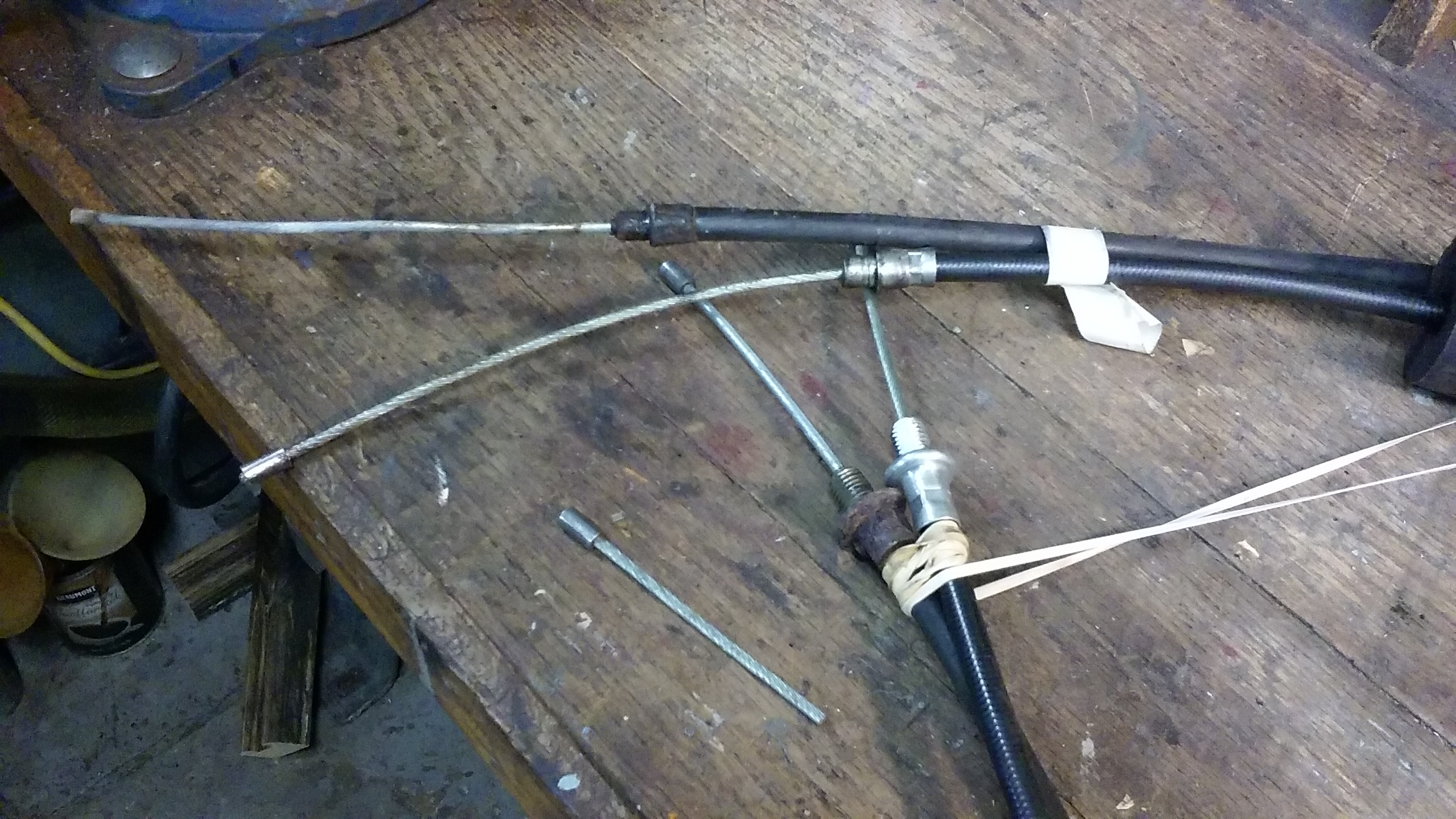

ifixalot wrote:I'm replacing the front parking brake cable. Raybestos BC94603 I got it from Rock auto.
The damn thing is too long. I don't have enough adjustment to tighten it up.
I guess I have to pull it back out and see if I can mod an end to make it shorter.
I bought way back in July so I can't return it but it Raybestos says it's right for my car.
Go figure.
Go figure.
The reason I had to replace the cable was mice ate some of the plastic off the outside and the inside rusted causing the cable to bind.
Here is the old and new cables taped together. One can see how the sheath is shorter and the inner cable was longer. The piece of inner cable
is the amount I had to cut off. I made and end, drilled it through, crushed it onto the cable and wire welded it to the cable.
While working on this, I noticed my fuel filler neck was real rusty, sure enough, I poked a hole in it. I got the new one in today.
I'm seeing other rust and it may be time to let go of this car in the spring.
Posted: Wed Nov 28, 2018 6:53 pm
by Rettax3
That is a lot of work to have to do to make a new part work... Glad you got it squared away though. I'm sorry to hear about your rust problem. I hope you are able to cure it and save the car. Do you intend to replace it if you do decide to let it go?

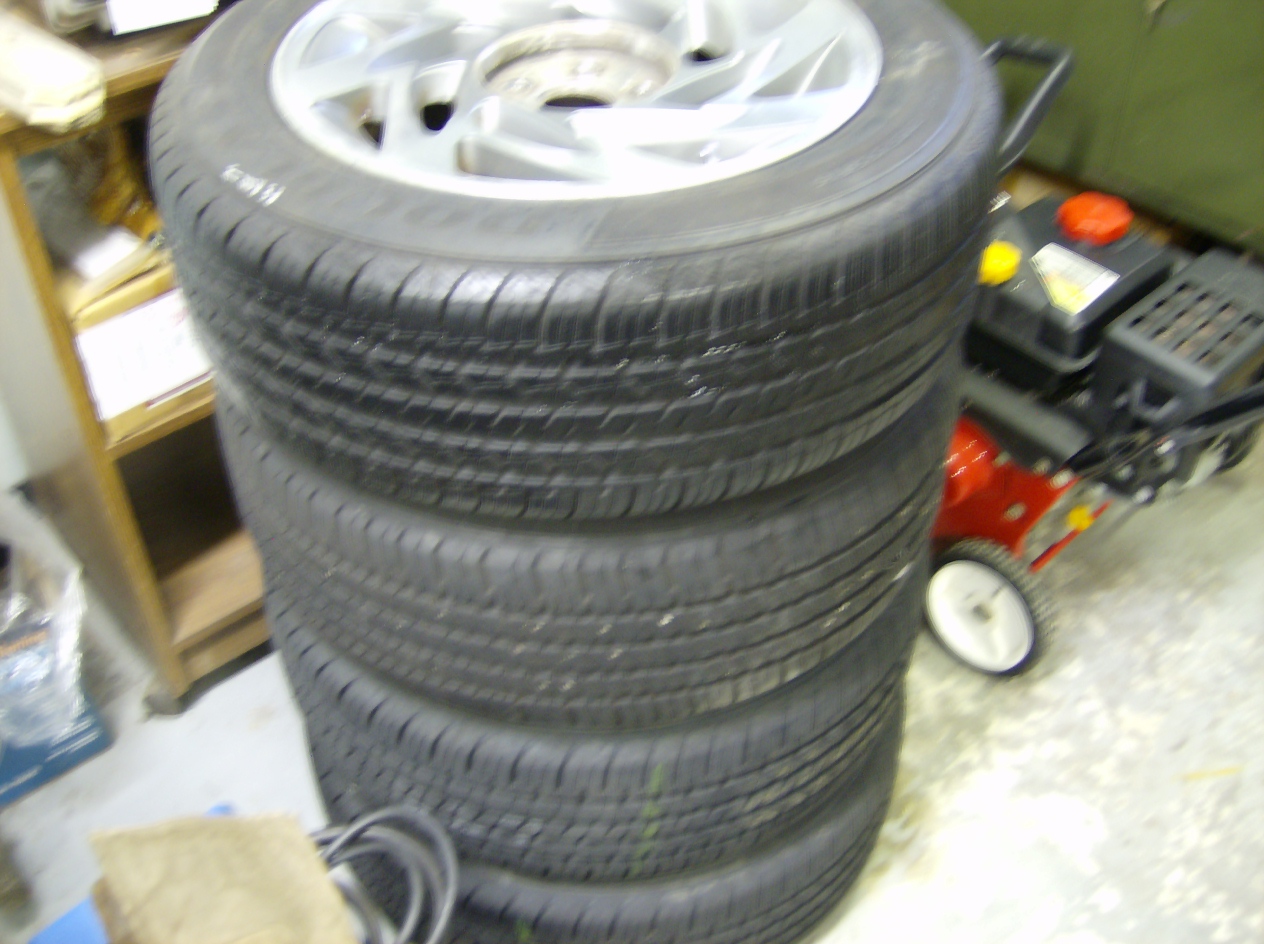

I'm thinking I need some new tires due to dry rot.
Posted: Thu Dec 13, 2018 10:43 pm
by Godlike
ya, those look like they've seen better days. One of my Nankang NS1s grew a huge blister out of the sidewall this fall. The rears on my 17" wheels are origional so.....almost 19 yrs old.
Posted: Sat Dec 15, 2018 1:10 am
by woody90gtz
Wow...that looks...really bad. haha I got some old studded Goodyears on my car right now to roll it around and the dry rot is nowhere near that bad. But they leak like a sieve at the bead. They are DEAD overnight.
