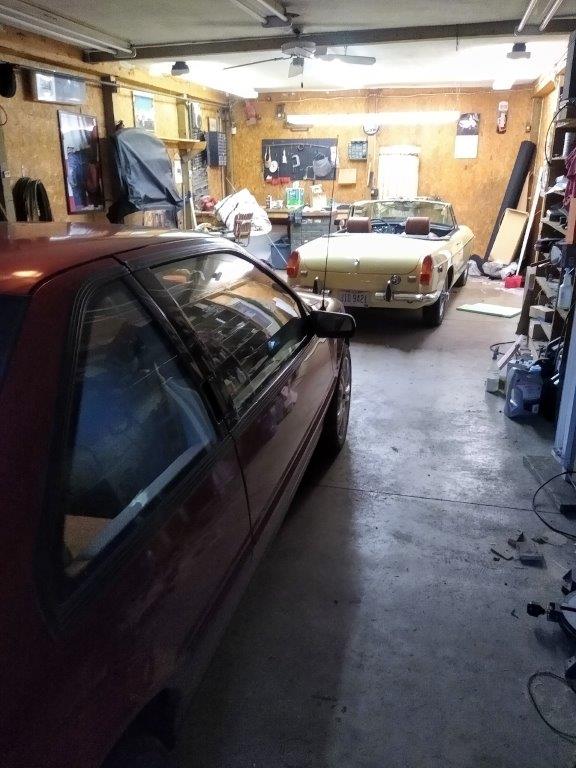

Finally have finished the resto on my MG, so the Beretta gets to share the garage with it! The Beretta is still running great, just oil changes. The only thing I've done lately is the lower dog bone. It had a crappy Anchor one I had put on when I first bought it. It had about an inch of play in it, so I put the OEM one back on. I noticed that I've been driving it for years with the front bolt in the "M" hole instead of the "A". Oops! Or maybe it was like that already and I just repeated the mistake.

Can't see much of it from that shot, but what I CAN see looks like a really clean little MG! Must feel pretty good to see so much effort turn into so much progress towards the end and finally turn a corner on it. I don't know if I ever do look at one of my cars and say, "Well, that is
done.." Congrats!

I didn't show much of the roadster since it's non-beretta, but thanks it's been a long time coming.
