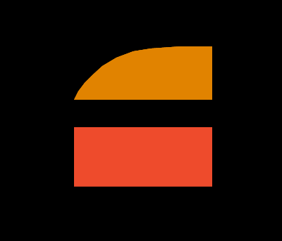

...this is what I already have:

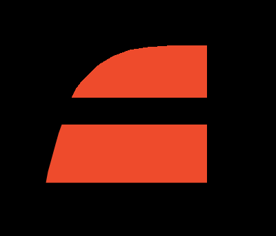

and this is what I'd like to get: :D

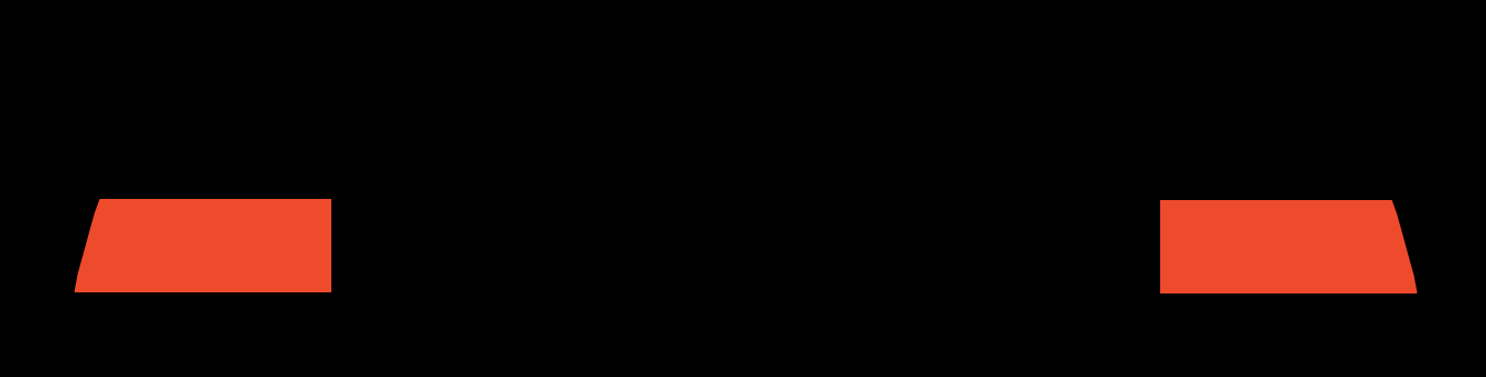

yeah, you are right. but there is a little difference between "original" euro:

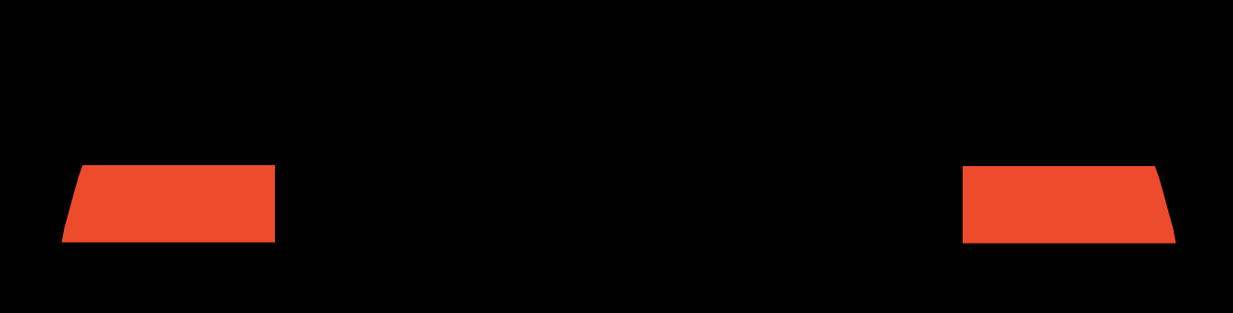

and the "remake" of euro taillights:
I like the "remake" much better than the "original" euro tails

And your diagram is actually wrong, the tiny corners you added to the tail part do not get brighter when the brakes are applied, they are only 194 running lights in that area so they are constant brightness.

is the new diagram now right?

Yeah that's what a "euro" addition to US lights would do...
