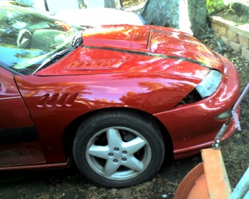

'97 Z-24, notice the fender is the only clean spot on the car, because the steel Z-3 fenders are new!

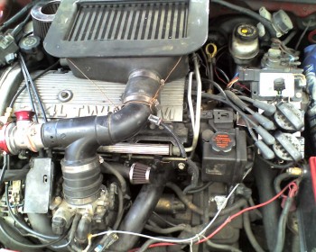

The intercooler is small, but so is the IHI turbo feeding into it.  It receives cold air directly from the functional hood scoop.
