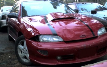

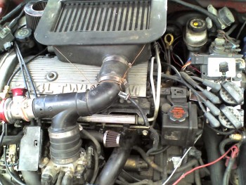

Anyways please elaborate more on your turbo LD9 project. What car are you running it in? Im currently building a turbo LD9 in a jbody.
If only tuning were as easy as those honda folks. Finding a tuner is hard for us 4 cylinder GM enthusiast. Best i can say is research and learn to do it yourself.
Re: TGP LG5 Turbo 3.1 ECU/MAP/Injectors
Posted: Tue Oct 22, 2013 7:30 pm
by Rettax3
DOHC_tuner wrote:yeah tuning is required to get the full power of added modifications. Wish it was like the old days (at least ive been told) just with a screw driver you can tune a V8.
Mine is in a j-body too, a 5-speed '97 Z-24. I bought the car for $120 with a grenaded engine, hobbled together a 2.3 SOHC with a LD9 head and ~$75 worth of gaskets, head-bolts, and a few other new parts, and drove the car around for about a year until the oil-pump seized and damaged the already worn (180k+ miles) bearings. I bought a good low-mileage '01 LD9 (no EGR and higher compression that the older 2.4 Twin Cams) for something like $300, dropped about $100 worth of turbo parts into it from a 2.3 Ford Turbo-Coupe Thunderbird and other sundry items like a cone filter and some piping, and ran stock ECM programming for a few years at 6,000-9,000 feet above sea-level -the first 5-7 pounds of boost just make up for the thinner air, so I had no problems at all. Even at 9 PSI of boost and driving down the mountains to 5,000 feet altitude, I had no problems even with low-grade gas (extensive testing trying to find the boundaries of safe operation discovered no problems here, although the testing was a bit shade-tree without datalogging). Now that I am down at a lower altitude, I am having issues running much more than 5 PSI, but it could actually be the ICM going out (the ICM is almost certainly going out, I experienced a serious spark-loss that started causing severe after-fire through the exhaust after it loaded up the last time I drove it, even without boost) or knock-retarding due to the need for premium fuel with this configuration. Before, the car really had no need for a tune, now it really does need one. I was starting to mess with an AFPR, but the unit I have blew-out the internal diaphragm after only a few days' use, so I am back to factory pressure, which is another problem at this altitude.
I am currently tinkering with the idea of installing a mass-airflow fuel-control system, I just haven't decided if I want that computer to run spark too, or if I will let the car's original ECM control that. Or I can just tune the computer I have now, if I can get a DHP :roll: . But I prefer to use parts I already have on my builds, and I do like the challenge of making things work together that aren't supposed to, that is one of the reasons I've gone the direction I have on some of my builds...
