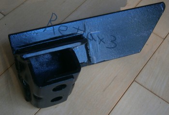

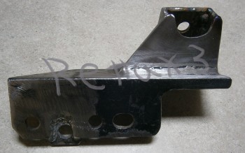

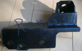

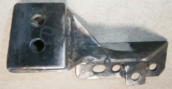

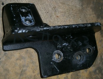

I would say all else being equal, go with the 2.8. Both cars you are looking at are five-speed, so you are all right there. The 2.8 will (again, all else being equal) be less finicky, require slightly less attention, and is slightly less likely to have a cataclysmic failure if the maintenance does get away from you. They are easier to upgrade, and although the transmissions between those two engines are essentially the same internally, the bell-housings are different, and the 2.8 has many more interchangeable engines that will bolt onto it, whereas the Quad only has one other block that will bolt directly in place (the lower powered 2.4 Twin Cam 'LD9' engine). That said, the GTZ that the Quad came in is a sportier car, typically has better suspension (unless the 2.8 car you are looking at is a Z51-equipped GT, look at the RPO codes on the sticker in the trunk on the spare-tire cover), has nicer seats, and is usually worth more, so all else isn't necessarily equal. The Quad can also get better fuel-mileage, if driven nicely.
For interchangeability, the 3.1 MPFI bolts on, but isn't really much of an upgrade, 3100 SFI isn't too hard to adapt, except for the front mount, dito for the 3400, 3500 will go in, 3800 and 3800SC (I have one of those in a car that was a 2.8 ) but requires a bit more fabrication, even a 3900 should go in with some work (I can't say for certain, though), and the 3.4 Twin Dual Cam 24-valve engine will also bolt in, but will be fairly difficult to fit into the car (no one has actually done it, to my knowledge, and that engine uses a timing belt and earlier versions also require partial engine disassembly just to change the rear spark plugs). The 2.8s are also fairly cheap to turbo-charge, whereas the Quads have a higher compression-ratio which tends to make forced induction costly to make reliable.
BTW, I also have made some of the front-mounts for adapting the 3X00 SFI engines into the older Berettas, and I am willing to make more if there is a demand for them...
(Mark 'II') -currently installed in my '90 turbo 'Retta.  Industrial-duty 3" angle steel, 1/4" thick.  Total over-kill...
(Mark 'III') -currently being used as a template.  A lot stronger than the frame of the car it bolts to...
(Mark 'IV') -already sold.  Heavy-duty build compared to the Mark 'III'.
These are not as complex as the ones sold on the other site, and they are able to accept the older-style A/C bracket.
