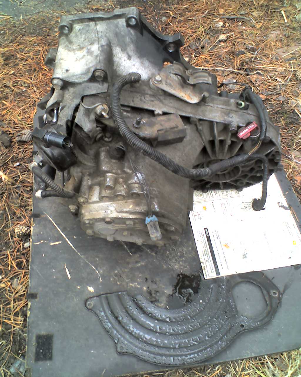

Second. I have a hard to find Z34 5speed transmission with 150k on the clock. I bought this to swap my GTU over but I am putting that on hold for now due to space and time constraints. Everything works as mechanically as you can tell without being attached to a running motor. All the gears move smoothly from one to the next.
I'm asking $500 for this transmission and again I'm willing to deliver to within 100-150 miles of central Wisconsin.

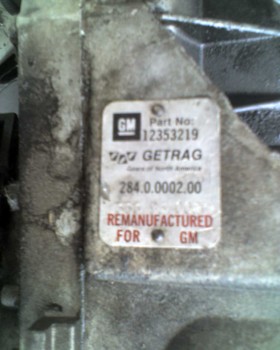

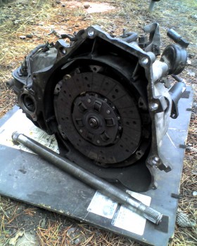

Umm, the 284 has a slightly LARGER case than the 282, and weighs a bit more too. I don't recall what the shift-cables are like, but the CVs are completely different as is the jack-shaft, and let us not forget about the almost-impossible-to-find pull-type clutch that costs like $250 for a stock version... Yes, I have a 284 sitting waiting for the right project... The reason the Fieros liked them is that they are slightly stronger than the 282s, and have an ever-so-slightly taller gearing (better highway gearing) IIRC. Fieros also have a much larger engine-bay than Berettas do, and so do not care about tranny size as much... Yes, I have a Fiero also, waiting for the right project blahblahblah... Either way, it is a cheaper, easier, (and physically smaller trans) than the F40 six-speed swap.
284s are VERY rare, but not necessarily the golden-chalice some people think they are.  It takes special equipment to rebuild these things, so even if you have the ability to rebuild a 282, the 284 cannot be done 'at home'.  Parts are hard or impossible to find, and even the clutch is hard to track down, so plan on something custom with the appropriate price-tag.
Input and output shafts are WAY bigger than the 282 though, so there is something to the thoughts that these are a stronger trans.  Still, the 282s don't tend to break easily, even the Fiero crowd has had good longevity with them next to mildly built SBCs...

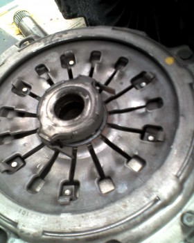

The 284 clutch is a pull-type diaphragm, like the one used in the T-56 six-speed trans used in some 'Vettes and fourth-gen F-bodies.  Rare, okay, really RARE.  No other tranny used this thing either, so you cannot find it for another application.
Mine has less miles than Travelor's, and has been rebuilt already.  I would buy another in a heartbeat though, if I already knew exactly what it would entail to drop one into a Beretta.  I still have a 3.4 TDC waiting for my Z-26 (or possibly the Fiero GT), but would love to have another one.  Mine was sourced from a Grand Prix GT of the same era.  The 284 ONLY came with the 3.4 TDC (Twin Dual Cam) engine, which ONLY came in W-bodies, and ONLY for a few years.  There were only a couple thousand of them built.  The exception was the Chrysler TC model that had them as an option for a year or two, but they were also very rare and obviously used a different bellhousing.

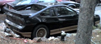

This is my Fiero.  Not a big deal unless you like them, and this isn't the site for this car, but here it is since I mentioned it.  Crappy photo, sorry.
If you just want to 5-speed swap your Beretta, this is NOT the way to go, sorry. If you need a stronger trans, or if you want something really unique, this is a rare opportunity on this option. I doubt there are two other Berettas out there with 284s in them. Someone please show me I'm wrong on this, but I don't think this was really done, and it won't really become popular now. Now, you can get an F40, or some of the other easily-obtained newer 5-speed trannies that use more common clutches and direct bolt-in CVs. But also consider the gearing in the 284 -IIRC the first couple of gears were lower -which means a quicker jump off the line- because the 3.4 TDC had a significantly higher red-line than its' pushrod cousins. The taller highway gearing in fifth is awesome if you don't want the utter nightmare of swapping in an F40, or can't get an F40 with the right gearing (the issue that the other F40-equipped Beretta here has -sorry Shawn :oops: ).
Pics and some more details, like if you have the CVs to work with as a start for custom fabrication of ones that will fit a Beretta, and if you have the clutch components, cables, hydraulics, etc might help with that price-tag too. Good luck with the sale.
