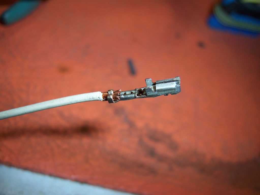

Pull a connector from a un-used connector you have lying around, remember it has to be the same type of pin, TPS, Crank position, IAC, and a few others are all the same, I cut up a old crank position connector to get the pin out of it.
I cleaned it up trimmed back the wires, threaded the white wire through the ICM connector first at PIN C, and then put the pin on the wire and soldered it together.

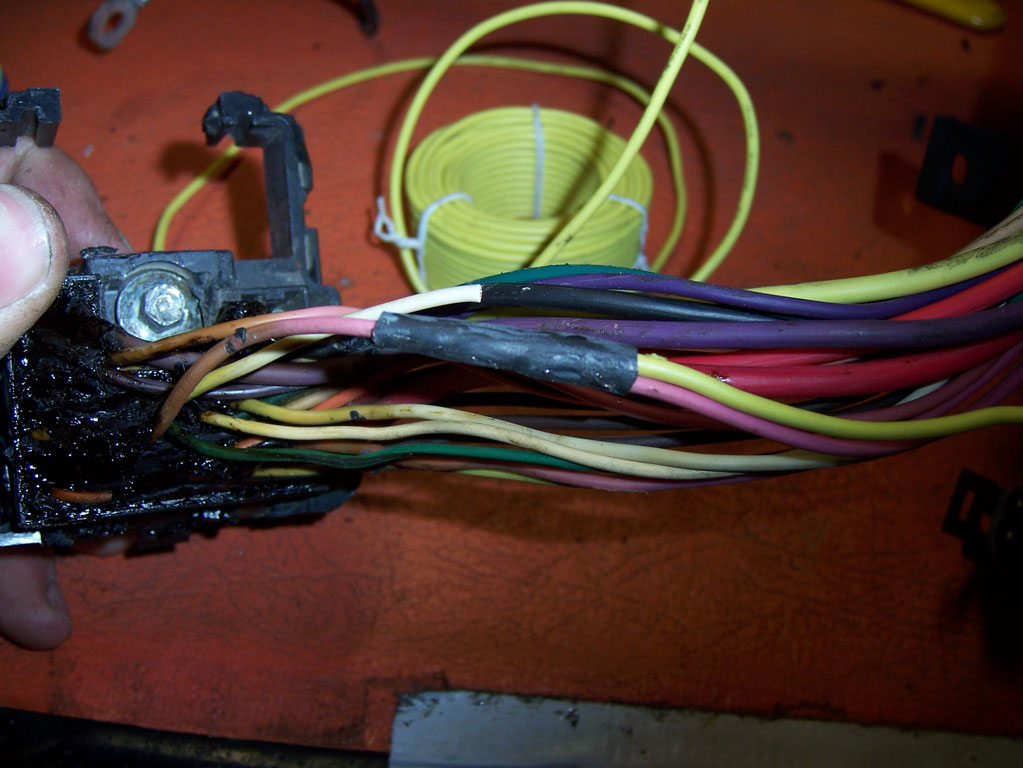

Cut the white wire on the driver's side body harness connector, PIN G5 AKA top row second from left, Looking at the back side of connector, as pictured, (natural wire curve aiming down)
Pull this wire back through the harness to the ABS ECM plug.
Stage this wire there for now.
