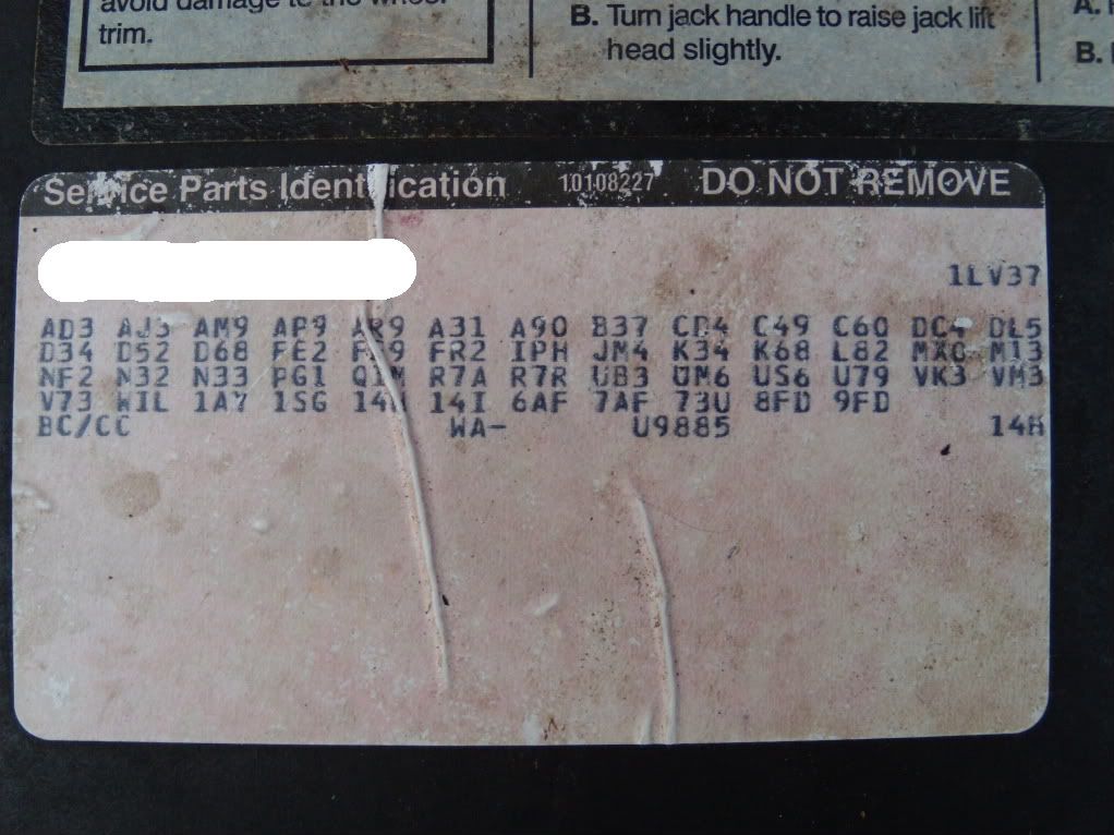

Keep in mind that my girlfriend said that the use of Eibachs will not happen because of the way they ride on the Cav. My stock springs have 150k on them, so I'd say that anything would be better. I'm not sure what I have stock. I will post a pic of my spare cover tag.

Go over to Bstuff and download the factory spring rate charts I have posted there. Find you original ones via your option label spring codes, then by gauging where they are within the spring rate range, you can judge for yourself which of the OE replacements might work best as replacement. Or, you could choose a few by spring rate code and head off to the JY and start searching. That would certainly be lot cheaper than Vintage. For what you'll pay at Vintage you could buy another entire car with the springs you want.
