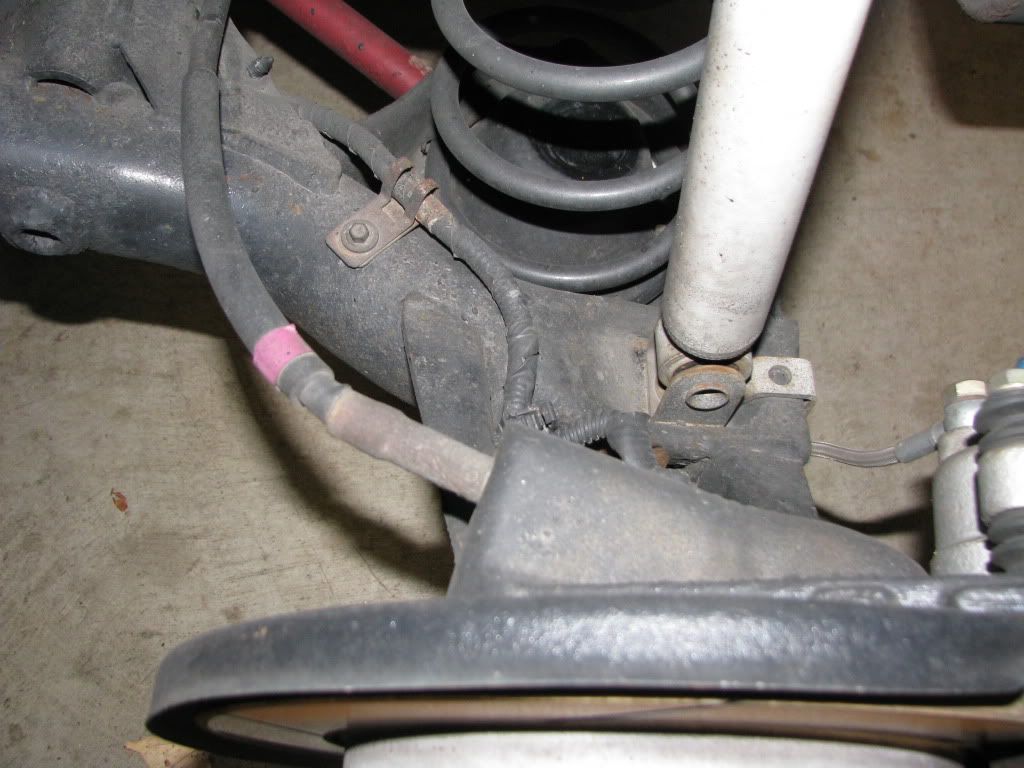

Saab upper studs are 12mm where the beretta is 10mm... you have to ream out the upper mount to fit the new shaft, or come up with a new design for that mount... I'm not positive on what it was made of but I think it was a steel collar thats molded in rubber so if you ream it you need to be careful heat wise and not burn the collar out of the rubber mount.
Also on a 95+ you need to make a lower bracket that will hold the base. The 94 and older shocks mounted with a horizontal bolt, the 95+ ones have a bracket that is fixed to the base of the shock with a vertical stud that goes into the rear axle.
Notice in this pic how base of the shock mount is part of it, vs the one pictured in the J-body thread using a standard horizontal bolt mount.
You could remove this part from a set of these shocks and just get the right bolt to fit that to the Saab shock and the problem will be solved.
