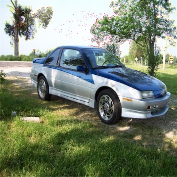

Hi all I need to ask all the Beretta guys and Gals a question to try and help guide me on this awesome car. Well I am getting a 1991 Beretta GTZ with the 3.1 with only 106,000 miles and a new tranny well a racing tranny with only 2k. The car does need some work which I'm ready for but heres the problem. The guy told me " I believe the entire wiring harness is needed to be replaced sine the headlights were having issues staying on and for the issue with the engine related wiring it would start and drive for a little while and then the engine would die. There is a fuse on the firewall that if I would let cool down and adjust it would allow the car to start again and would be play for a little while." Thats what I was told but when i called a wiring shop that only deals with this they told me that it didn't sound like that it was a bad harness. Said could also be a ground shorting things out or something being the ground. So what do you all think and please be blunt and say what you think it is and thanks!
Britney is her name!! 1991 Beretta GTZ

Interesting paint. 3500 that bitch
