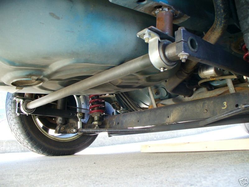

Here's a custom setup on an Achieva SCX! Slight overkill perhaps!

Except we can't see it! lol

Hmmm... I could see it just fine... But I guess I will load it to my photobucket and edit the post for ya!DTMAce wrote:Except we can't see it! lol

That bar on that Achieva is about what some run on Modifieds at a race track... VERY aggressive.
