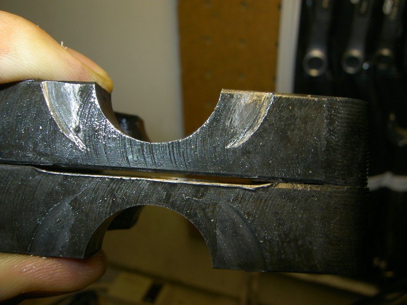

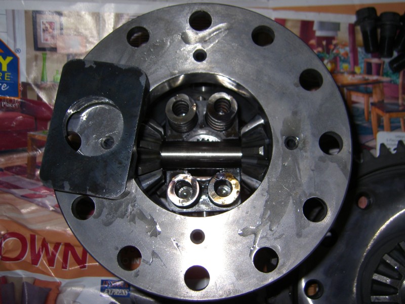

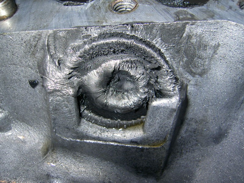

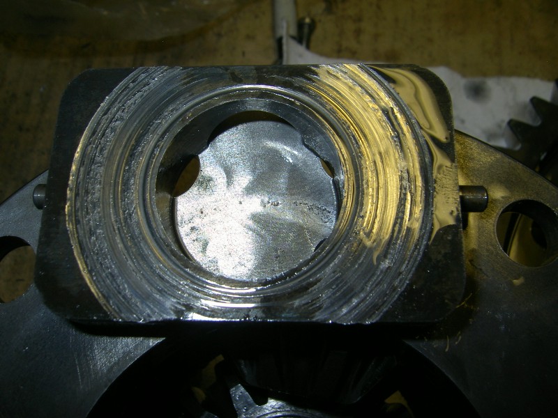

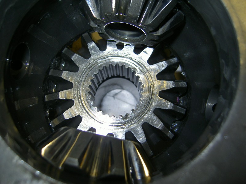

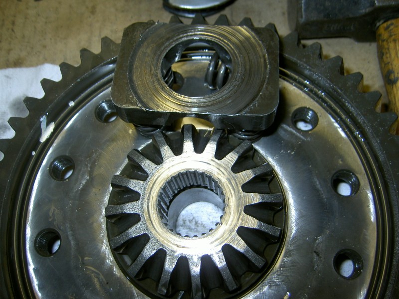

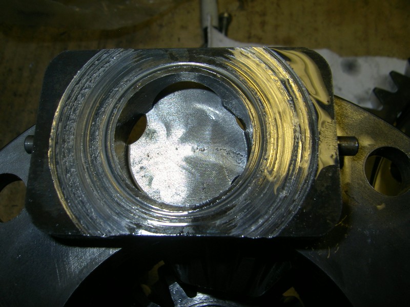

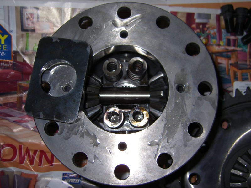

Along with replacing your diff... There are no clutches between the spider gears and the diff carrier they are using only the STEEL plate shims that are there stock and putting force against them... you will destroy the entire unit when it begins to wear those areas.Koots wrote:Seems the PG is good for a toy/weekend racer car, that will probably see a ton of maintenance just to keep the parts costs down and keep racing. You could just replace it, if it wears, in a weekend.
I think i'll stick to building one with a spare.
I disagree with the statement of there are not a lot of differences. Because yes they are all of the same "theory" but they are all designed differently and will wear parts differently. I JUST replaced my spider gears last year for the first time since I've owned the unit and it probably had 40k on it of daily driving. All of the differential carriers I used though are still 100% intact and re-usable. when a PG or TG unit wears out the shims your carrier will be toast.
Here are pictures of what happens to a PG... Others have posted carrier damage photos as well.

I know the Team Green has puts a huge load on the spider gears and when it does eventually slip it will do this.
