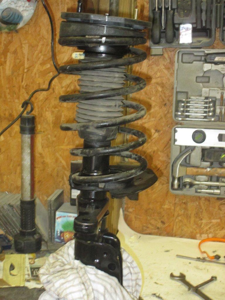

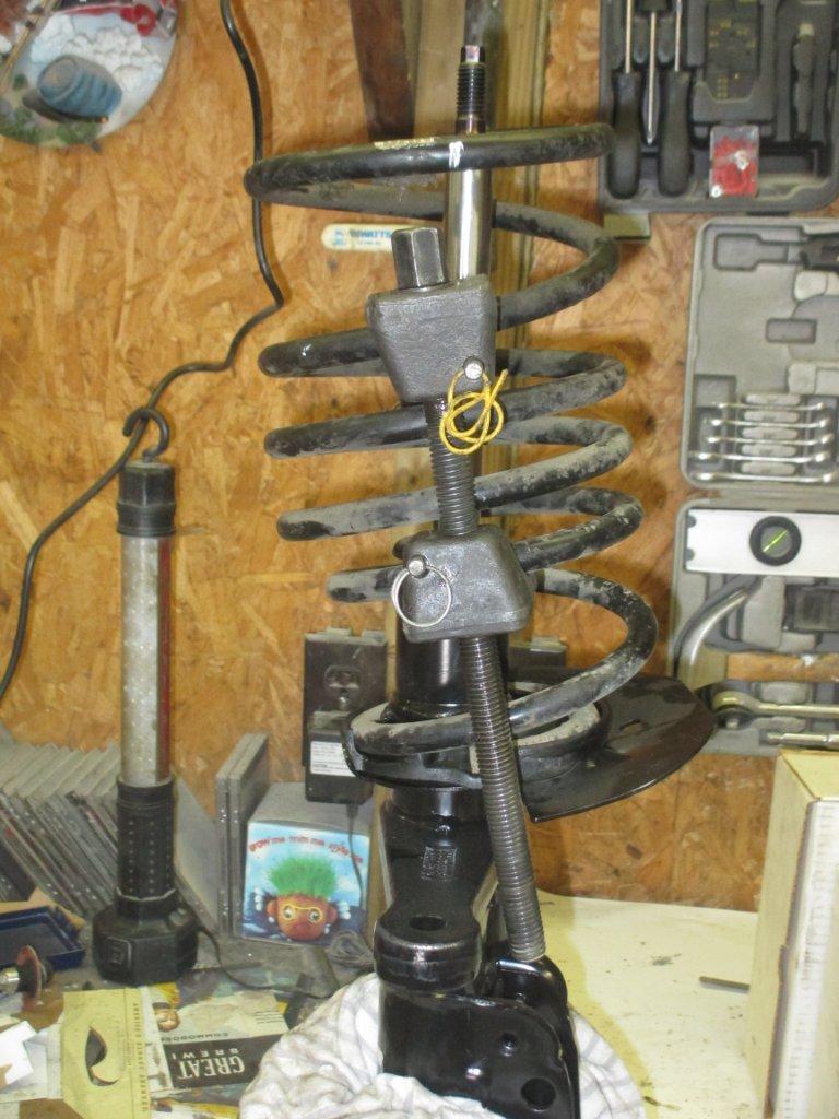

After ordering/returning 11 total struts I have a pair I am satisfied with and installed on Sunday.
Car is off of jack stands finally and I even gave it a quick wash (a rare occurrence).
I got to take it for a test drive! Went to my parents and had a beer with Dad, then stopped at Advance and returned the strut spring compressor.
Feels a lot different, only about 5 miles, its at the alignment shop today. I didn't want to drive it much with the camber out of whack. Hopefully the alignment goes OK, I'm worried for some reason. I put a level against the rotors to try and get it near vertical and it didn't seem like there was enough adjustment, but that's not really valid.
New tires, struts, strut bearings and upper isolators, drivers side stabilizer link, right upper and lower motor mounts, UI gaskets and pcv hose, rear shocks and mounts, pulled pass door panel and oiled everything up so the window cranks up smoothly and the power locks work, trimmed the rear wheel well flanges for tire clearance, rustproofed the rear cross member and strut perches with used oil, I'm sure there's more.

Those are Monroe struts, P/N 71921 & 922.woody90gtz wrote:11?! Wow. So what brand are those that you settled on?
ACDelco strut mounts, nice. I put Monroe on mine and one of the studs broke on the 2nd or 3rd tightening. I'm not super impressed.
I actually just put my suspension back in tonight. Gonna be strange on the ground...
Not my first choice, but..
Some of the 11qty were good ones I had returned so I had a matched set. I broke it down in a thread on the suspension forum.
The ACDelco mounts seem nice even though they are made in Taiwan, and the bearing had a made in India sticker..
They were on closeout so I got em cheap.

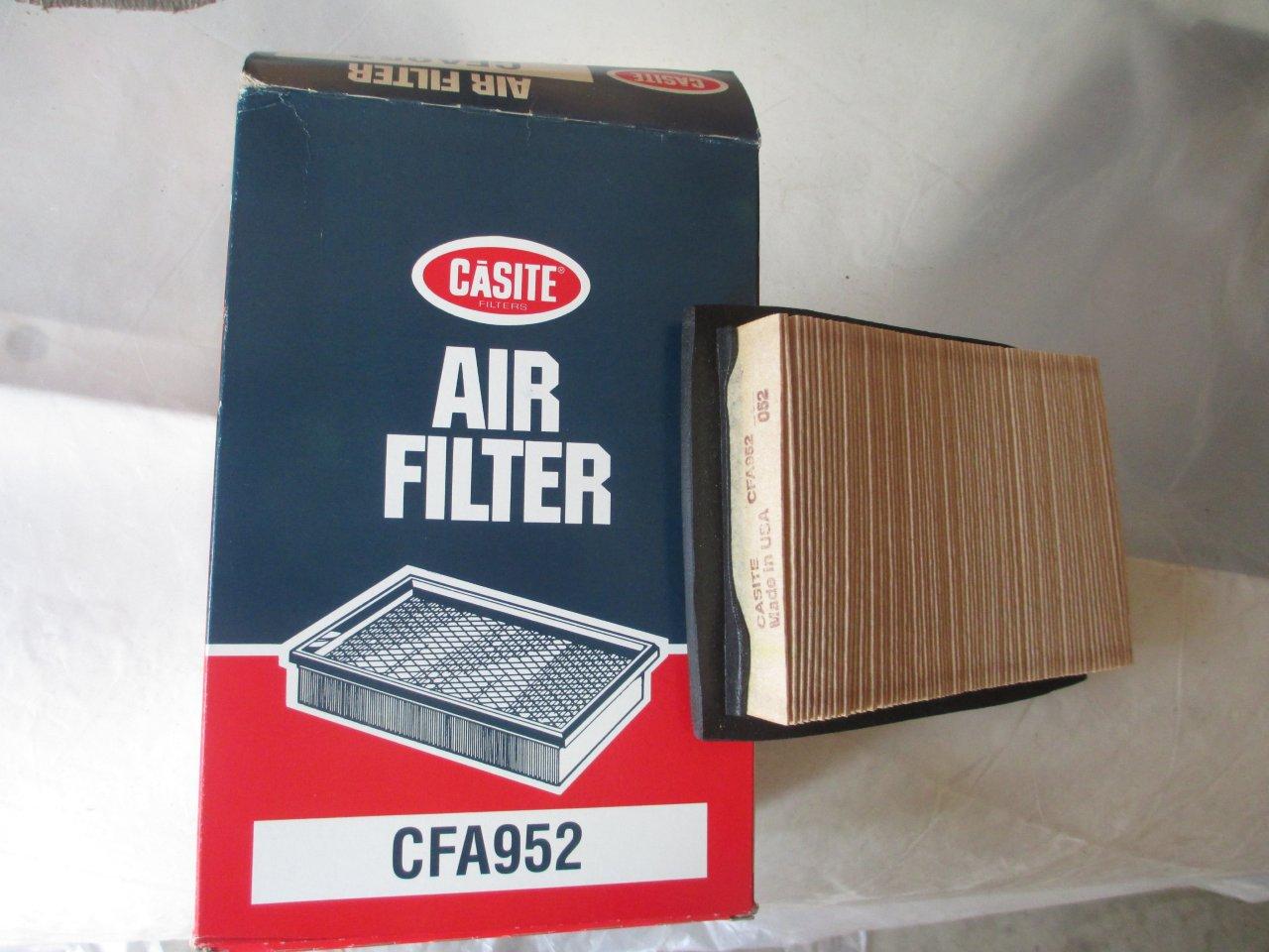

Ready for vacay with my vintage Hastings AF
I completed my pre-flight checklist now that I have my RA closeout $1.79 Hastings Casite air filter installed.
You'd think I would avoid the closeouts after the strut debacle, but I figure an air filter is pretty safe.
Wonder how old this thing is? Made in USA so that's cool. I was a stockperson at an auto parts store in the mid '90's, we carried Hastings but they didn't look like this. Private label maybe.
