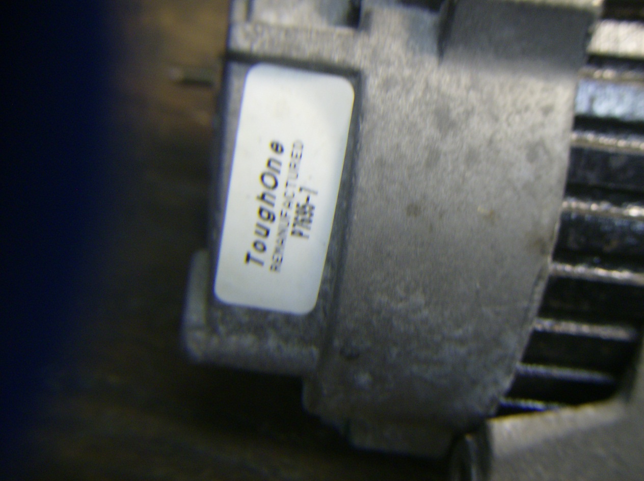

I swapped it with a good used one off my mini van, swapping the pulley. Now I have 13.4 volts with the AC on.
When removing the bad alternator, I see it was a rebuilt unit. I wonder if it was bad after the rebuild or died in service.
I've had aftermarket parts go bad after very little use.

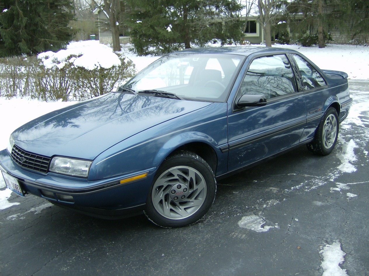

Anyway, I'm enjoying this little ol 88 since it's my only Beretta since selling the 96. It gets looks as I drive around.
I had a guy comment he hadn't seen a Beretta in years and mentioned how mine looked so clean inside and out.
