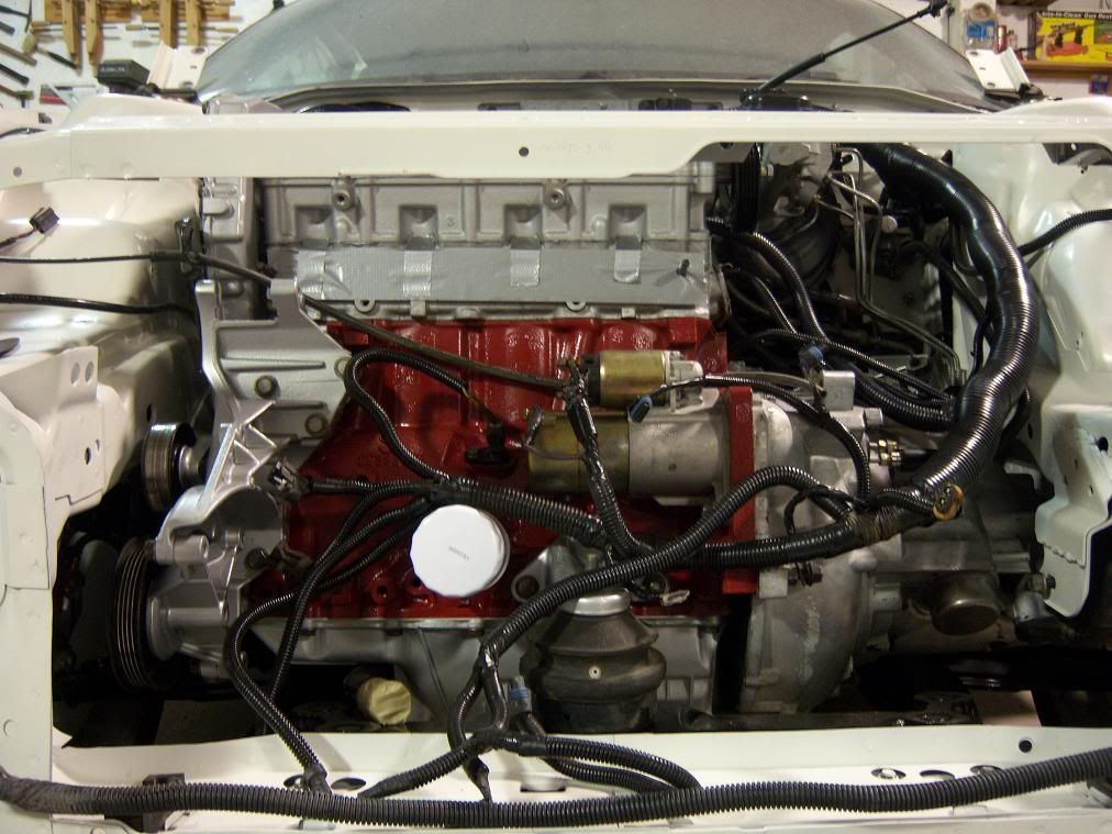

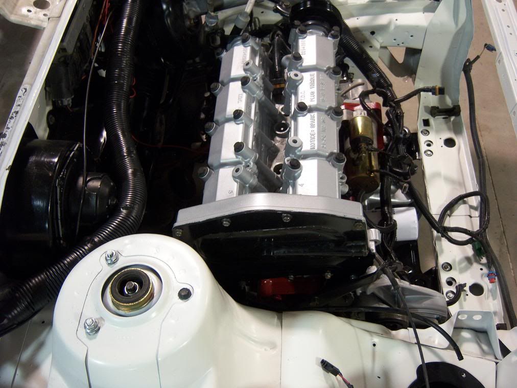

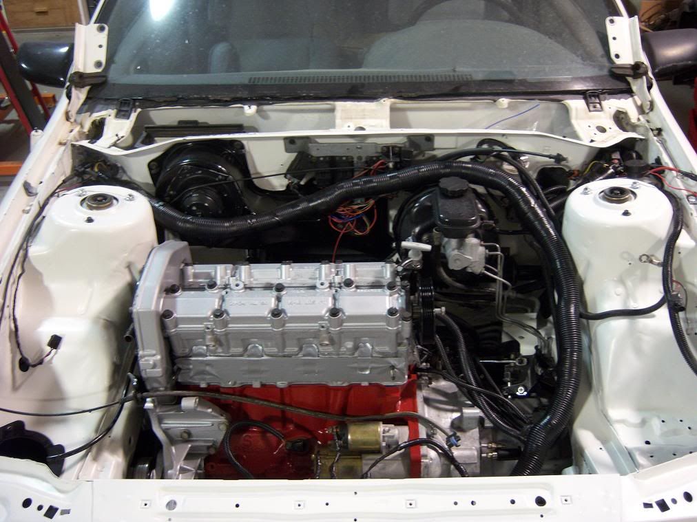

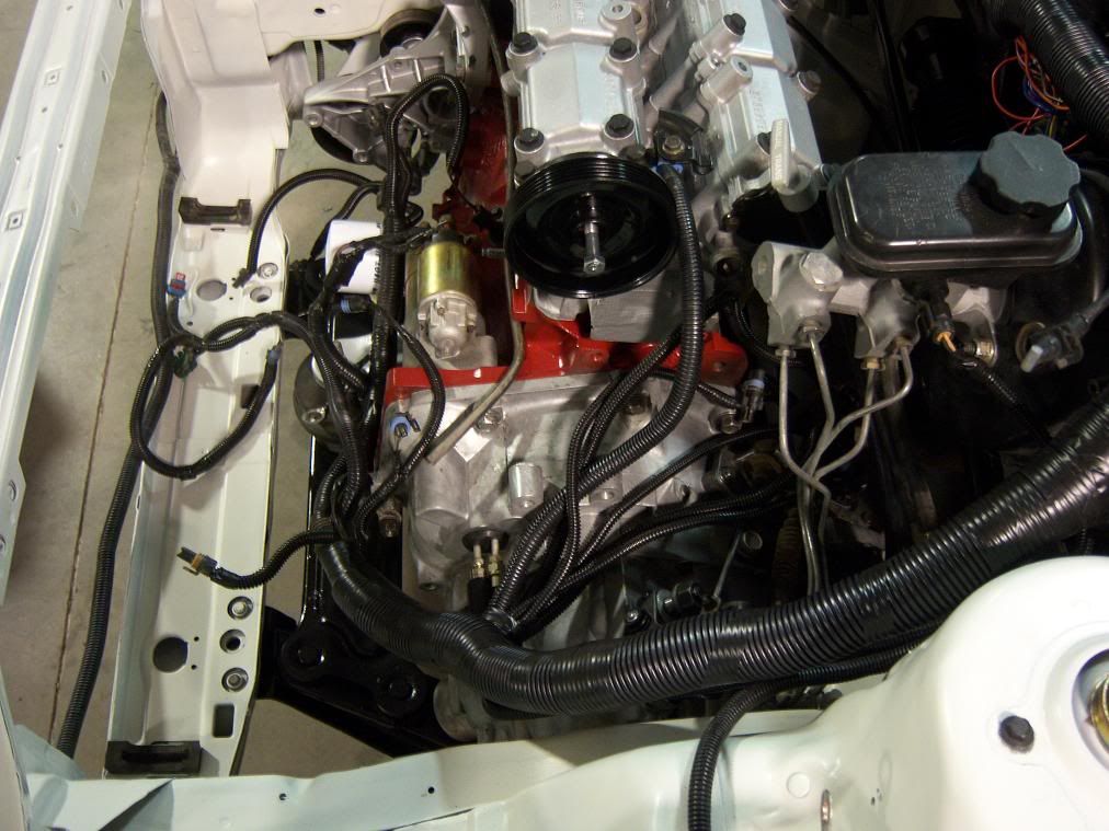

First order of business i took care of was the wiring. The original one was was in such bad shape appearance-wise i had to do something about it. I spent about an hour or so removing the bad parts, and redoing most of it. Wasn't too bad to do, just time consuming. The end result made me smile. It now matches the rest of the engine bay on the cleanliness factor.

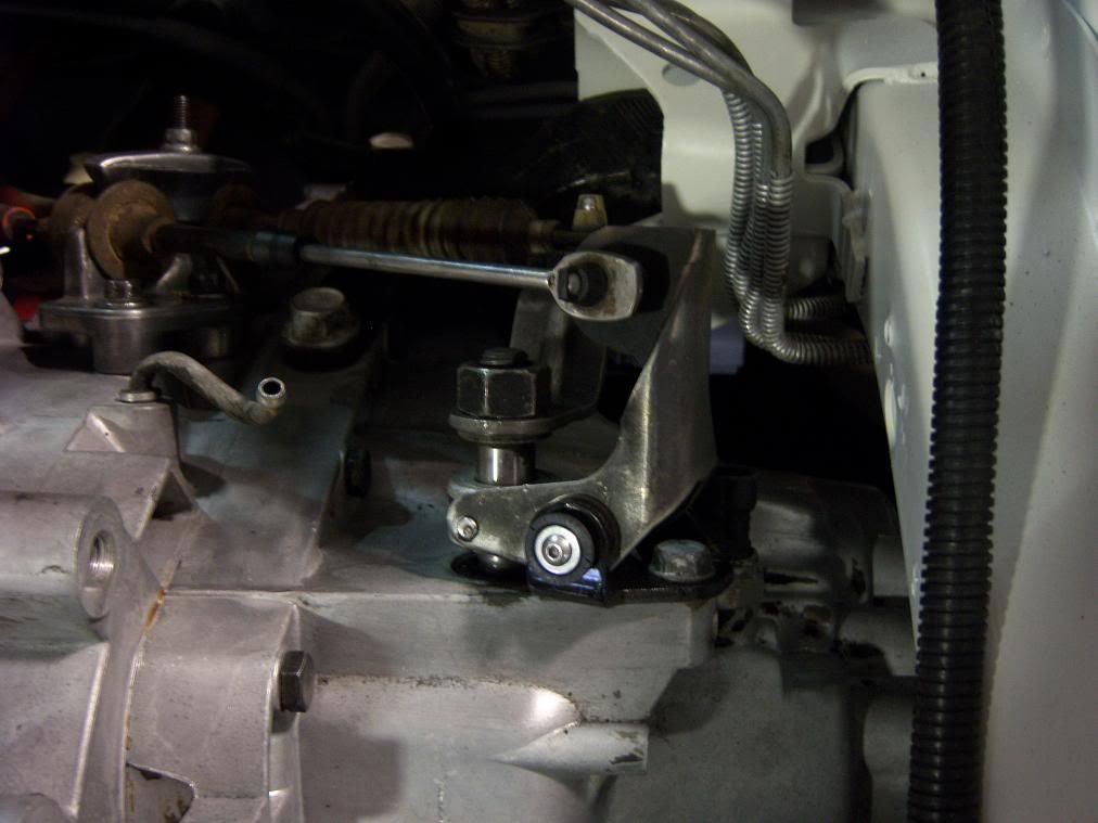

Second thing i dealt with was the 1-2 selector cable issue. Since the stock selector arm is rather tall, it requires a longer throw to put the lever thru all 3 shift points. Since the N-body cable is a hair longer than the L-body cable, i put in the 94 NVT selector arm to remove some of the distance the cable had to travel so i could get the car in 1st and 2nd from inside the cabin. After a couple tweaks, i had it installed and it works great! I now have full range of gear selection again
and the bonus, i have ALOT less selector/side to side movement in the shifter.

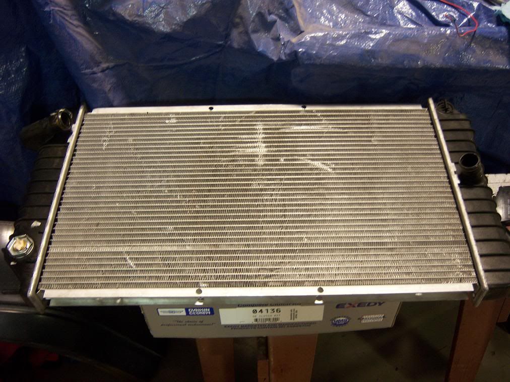

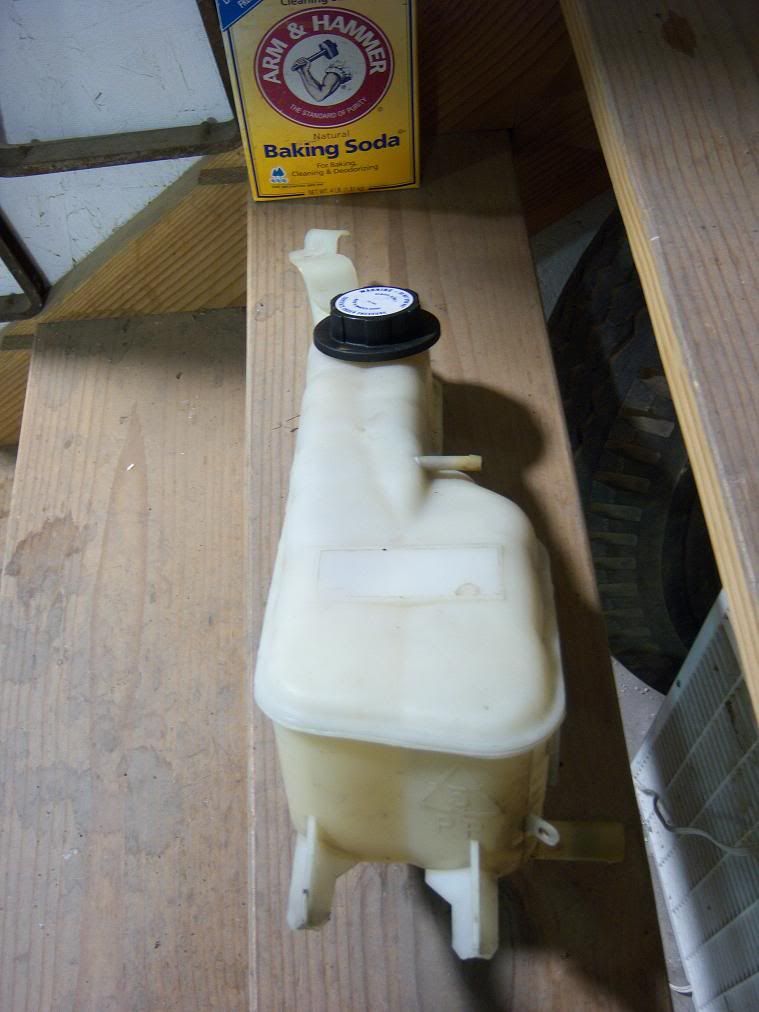

I also got the power steering pump drive pulley repainted so i can get that reinstalled to cover up the end of the intake cam. Thats nothing really special but something else i did. I also managed to grab a pic of the radiator and the coolant overflow tank. I also remembered while i was in my shed this morning, that i have a perfect/mint set of door hinges that i was going to install on my car as mine are kinda getting to that point. When i pull the fenders, or when i find better doors, i will swap those in.

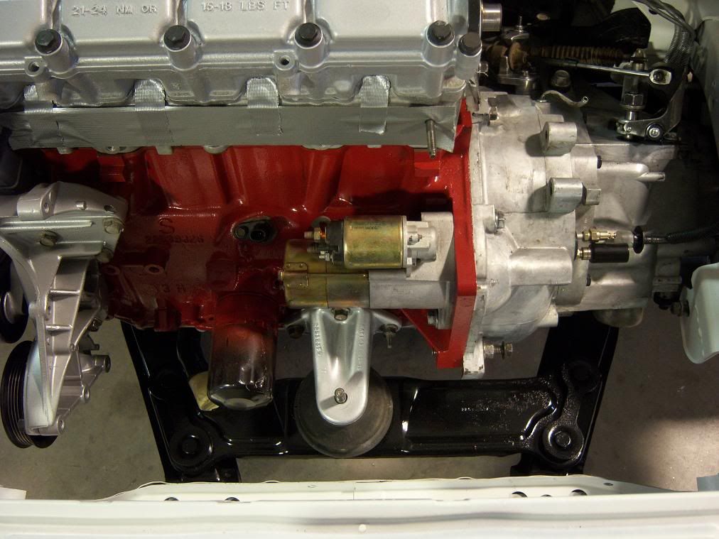

I installed the smaller 00+ starter today too. Its so much smaller looking when its attached to the motor. It will be interesting to see how it sounds on my engine. I hear on the Quads, they sound alot different than they do on the 2.4's.

2000 2.4 starter installed
94 NVT selector arm
Harness ready to go back in, didnt reloom the lighting harness as it was in great shape, other than a lil dusty.
94 NVT selector arm

The harness back in the bay. Most of the harness is just hanging there, but once the rest of the parts are installed, it will look nice and tidy in there
94 Radiator and Beretta overflow tank

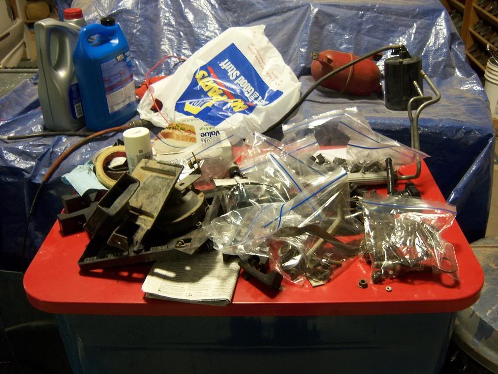

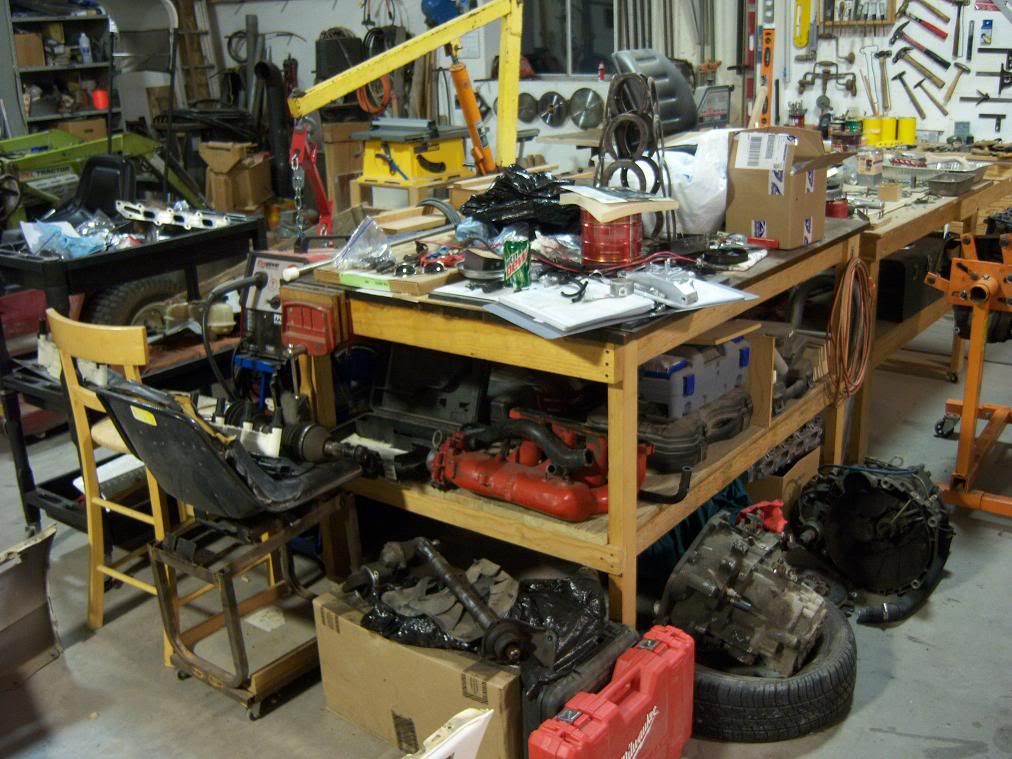

The mess i have made since i have been working on her. You can see a rolling shelf unit in the background with cavy 2.4 parts all over it.
The pile with stuff that still needs to be installed under the hood.

Looks awesome Geoff!!! I'm glad to see that i'm not the only one who puts nuts and bolts in bags!!!
- Posts: 10923
Re: My GTZ Returns--Update 2/16 Lots of Pics!
I used to do that, but now I've gotten to the point that I've taken it apart so many times as long as I just put all the bolts in one dish I can figure out where they go when going back together... it's kinda sick. However if I just lay them down somewhere... I'm typically f-ed and loose them. LOL
I think i would be able to figure out where they all go too but i didn't want to take any chances!!!
Yeah same here, i just like covering my bases. I also have a 2.4TC motor torn down close by, so another reason for the bags.
