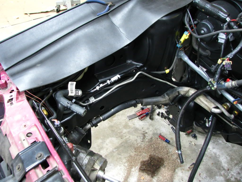

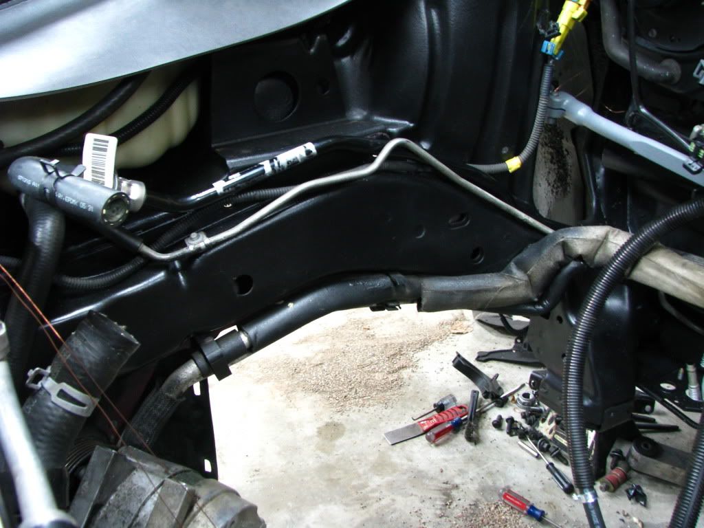

Cliff your right, I picked up the pipe last night and the two rubber hoses were already attached, they are clamped to that pipe like a hydraulic hose and they came with two new clamps for either end.
I positioned it in the bay last night and it looks like it will work with what I have there currently, I just need to figure out where I want it to run near the upper motor mount, as well as where it has to run to have the hose reach, and then I need to secure it in some way in a few spots... I don't need that thing rattling around.

3X00-Modified wrote:Cliff your right, I picked up the pipe last night and the two rubber hoses were already attached, they are clamped to that pipe like a hydraulic hose and they came with two new clamps for either end.
On the older cars, it just clips in the same plastic clips the A/C line is in. (the other A/C line goes around the drivers side on the 87-91)
You can see it in that diagram.
Posts: 10923
Re: 1996 Mr.Pink
My AC line is slightly different.... I messed with it a little bit and I think I have it in a spot that will work for now. Vibrations later will let me know for sure. If I get any then I need to re-make the evap line that goes back to the fuel tank since thats what runs right on top of the frame rail and is making it hard to position this line.

My Line routing.
