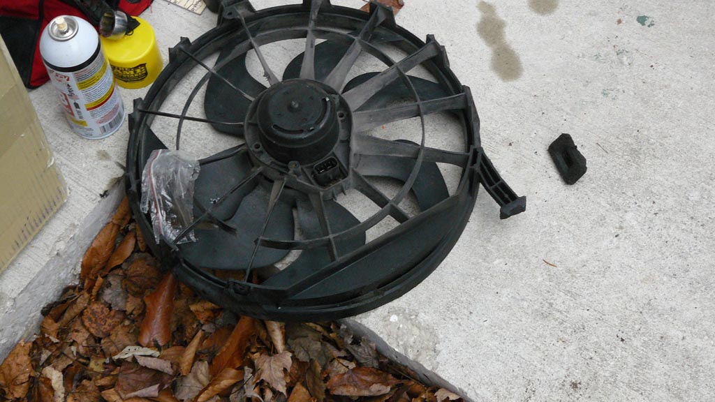

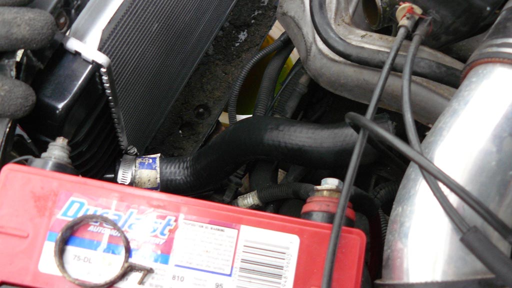

Can you see what is wrong with these pictures?
Yep. Broken fan mounts. Been broken actually for a while.
As for the other picture..... Hose is now too short, cause the radiator inlet opening is in the MIDDLE not the TOP! Arg.... So I have to replace the hose... But that is the only issue for the cheap radiator.
I also removed the condenser and cut back the A/C line. Not going to need it, the condenser was all bent in anyway from a previous accident. I have it all back together, just need the new hose, fill and bleed the system.

Well, radiator is done.
Installed a new hose for the return, filled her up. Still burping out some trapped air, but overall its fine. No leaks yet that I have found. New bleeder works good. BTW I have spares if anyone needs one! lol 5 bucks shipped.

Looks like you got a 96 radiator and not a 95 one. They moved the inlet to the middle on 96. Also you could have just used a 96 hose and it would fit perfect.

Sorry, missed your post.3X00-Modified wrote:Looks like you got a 96 radiator and not a 95 one. They moved the inlet to the middle on 96. Also you could have just used a 96 hose and it would fit perfect.
Also the low coolant thing is a magnet sensor, so I would guess the magnet is goo'd up in there and just doesn't move.
That makes sense, I did not know they had a different fitting style for 96. Interesting. Had I but known, I would have done exactly that! LOL Where were you earlier when I first put the pics up???
