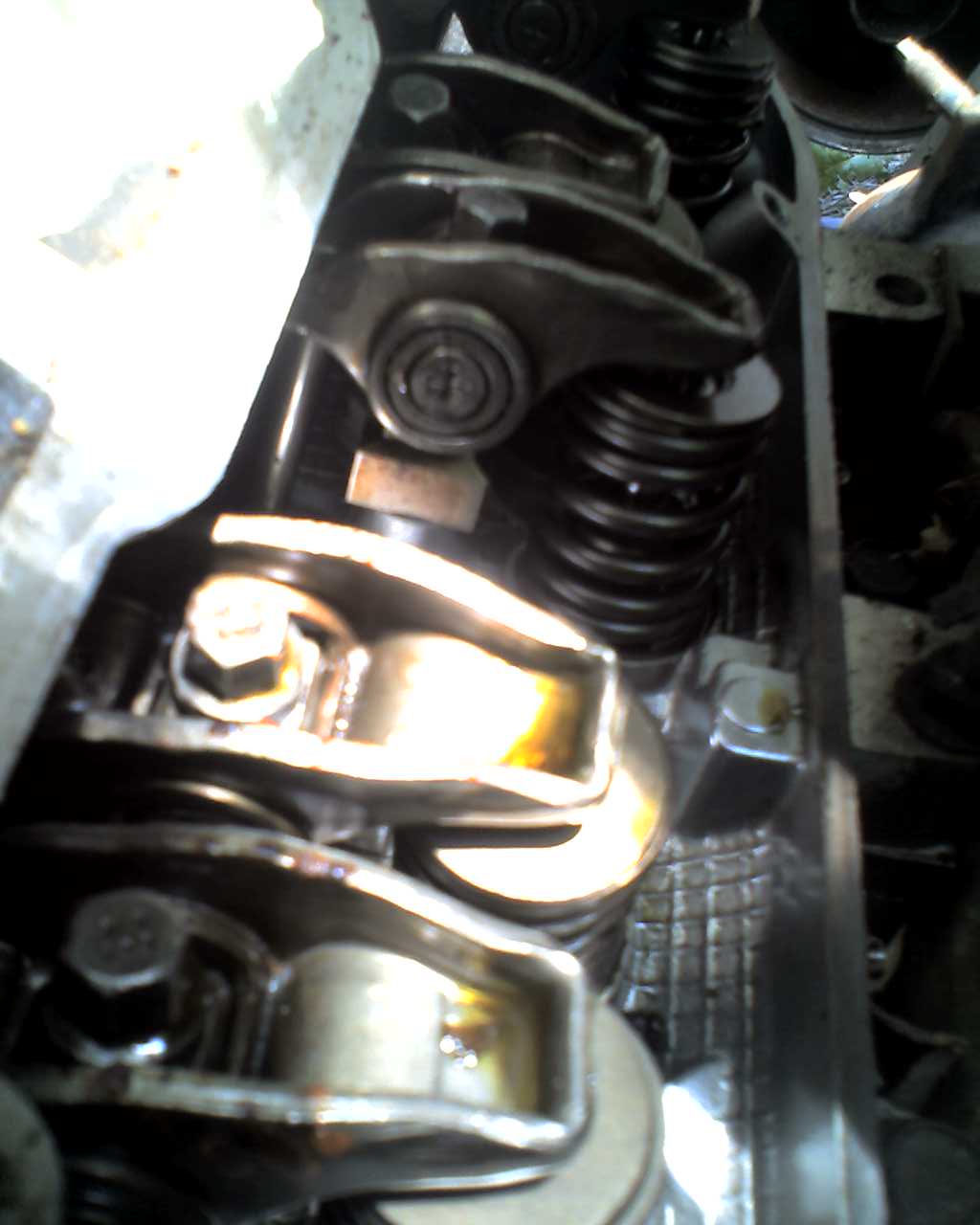

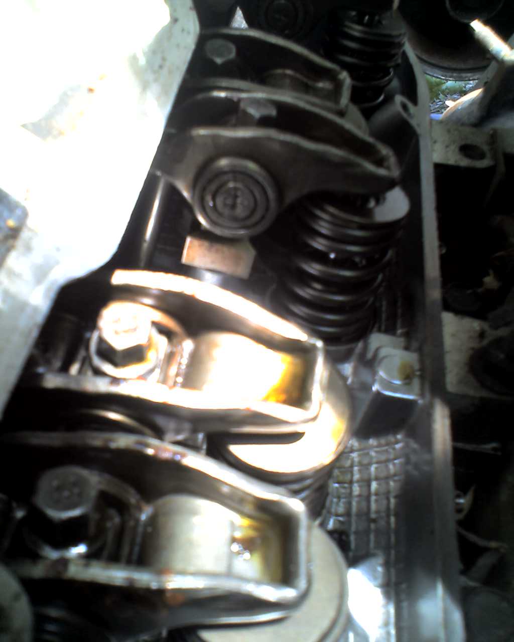

all 94-95 3100's had the stamped 1.6 ratio rockers... it was 96 that was hit or miss depending on when the engine was built. They could have the roller fulcrum rocker that requires the pedestal that the 3.1MPFI heads can't accept.
Re: To rebuild or not to rebuild? Thats the dilemma!
I've ran into a few 95 GP's with the non stamped rockers. Late year production, but still 95
They CAN accept them with a little modification, but no, they are not bolt-and-go... These are from a '99 GAGT LA1 'VIN-E' 3400, and are in the 3.1 MPFI heads on my '90 turbo 'Retta. They work great -I just don't recall which push-rods I had to use for them. I probably get 1-2 HP over the stamped pivot-ball rockers, but it is 1-2 HP for free.3X00-Modified wrote:all 94-95 3100's had the stamped 1.6 ratio rockers... it was 96 that was hit or miss depending on when the engine was built. They could have the roller fulcrum rocker that requires the pedestal that the 3.1MPFI heads can't accept.
