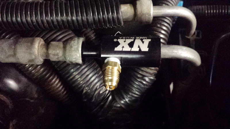

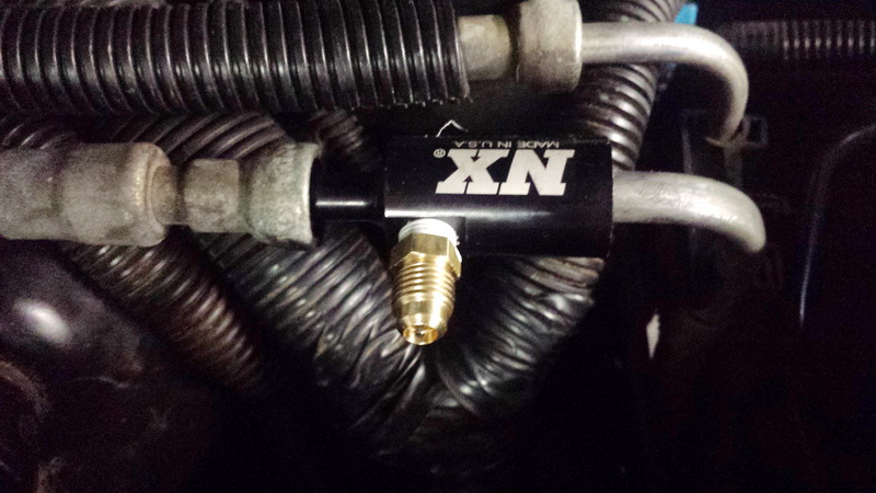

Got my schrader valve and adapter setup installed on the GTZ - Worked like a champ, BTW. My fuel pressure @ idle is 35psi. My fuel pressure under load jumps a few psi at initial rev and then levels back out right around 35psi again. Shouldn't it be more like ~43psi? I haven't had a chance to drive it with the gauge hooked up but I expect results to be similar.

weak fuel system. Change fuel filter with a new non fram one and recheck.

pull the vacuum line off the regulator and see if it stays solid at 43-45
Re: GTZ _STILL_ running rough
Just tried it - The fuel pressure jumps to ~42ish psi when the vacuum line is removed.
We've driven the car with this vacuum line off and it didn't seem to make any difference.

This is why I honestly don't feel it's the fuel system... I've experienced weak fuel systems and they very rarely cause a skip like this... Especially when registering 35PSI at idle. The most you will usually feel from a weak system is just basic power loss... that can be scanned and found when at WOT by just looking at the O2 voltage.

If the regulator is not to spec you can't just dismiss it. Replace it and go from there.
Pulling the vacuum line won't help the car run better.
After all, they designed it to have a vacuum line for a reason.
It might not be all the problem but it is most likely part of the problem.
An injector will spray a certain amount of fuel over a certain amount of time at a given pressure.
If you alter the pressure, it's going to spray less fuel. The ecm can compensate but if too far off
maybe it's out of the designed range of adjustment of the ecm.
- Posts: 10923
How is that regulator not to spec? Why do people feel it's wrong? I told him to pull the VAC line to see if it would go to peak pressure and hold while running. His rev test it responded just the way it should with a drop in VAC then immediate increase which raised and then decreased the fuel pressure. Fuel pressure is directly related to engine vacuum so with an instant rev the vac drops to zero or close to it which causes the fuel pressure to rise, if you hold the throttle steady the vac levels off and gets higher which in turn drops the fuel pressure back down. The only time you will see 42-45PSI is at WOT conditions, or with the vacuum line removed from the regulator.
I'm sorry but troubleshooting this car in person I really disagree with all the talk of it being a fuel pressure issue alone.
OK, your right, the service manual says engine off, ignition on, pressure should be 41-47 psi,
so with no vacuum, 42 psi would be the low range of normal. (41-47psi)
It seemed 35psi running, sounded low to me.
- Posts: 10923
35psi running is completely normal... that's what the vacuum line does. It drops the pressure at idle so the injectors will flow less allowing the ecu to have more control over idle quality.
