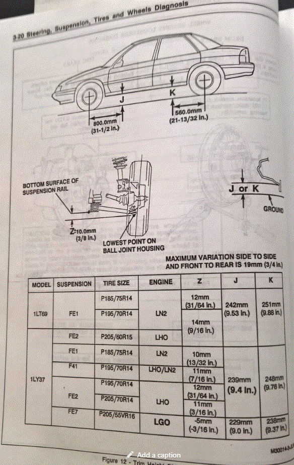

Re: Various vehicle and spring heights....
Here's what 1992 book had:

I suggested the fender to ground method of measuring because everyone want's to just know how far off the ground their car is.... You give them a number from fender to center of wheel now they need to figure out the radius of their tire and add that to it and take into consideration all the elements you left out. I do like the method from the book measuring forward/back of the wheels from a set point on the rocker to the ground. But that will take into consideration the wheel/tire combo again... Which in all honesty is something I want included so people know what it does when they put on oddball size tires.
- Posts: 1775
- Location: Long Grove, IL
Wow, so a GTZ starts out with a negative Z height. That's not very good for the roll center.
Well that would be measured to bolt in actual suspension geometry I think.
- Posts: 1775
Yes, the Z height is the relationship between the bottom of the suspension rail to the bottom of the ball joint. The spec has the bottom of the ball joint higher than the suspension rail for FE7.
