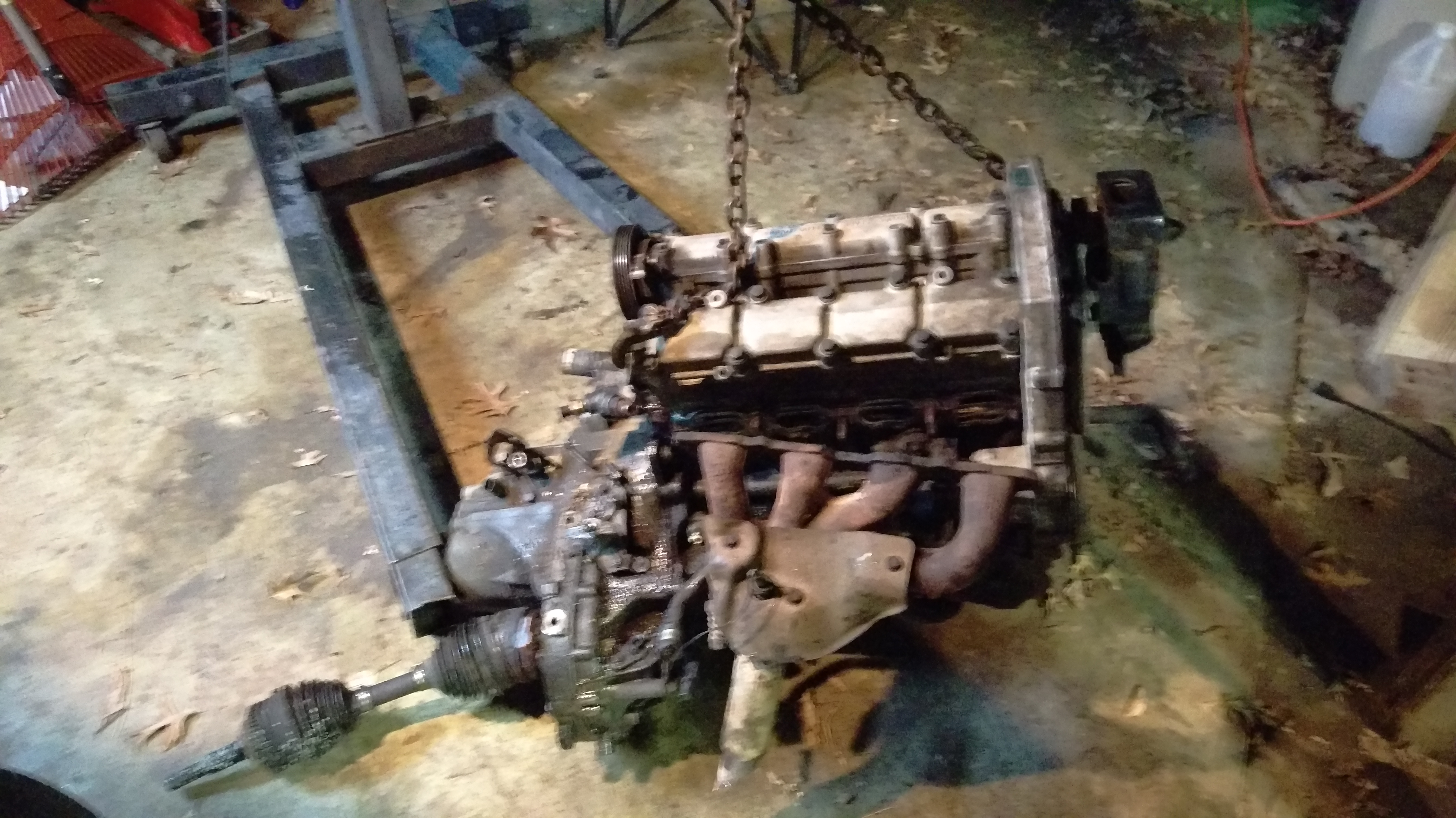

Motor will be pulled after Christmas. Cleaned up and start the turbo project

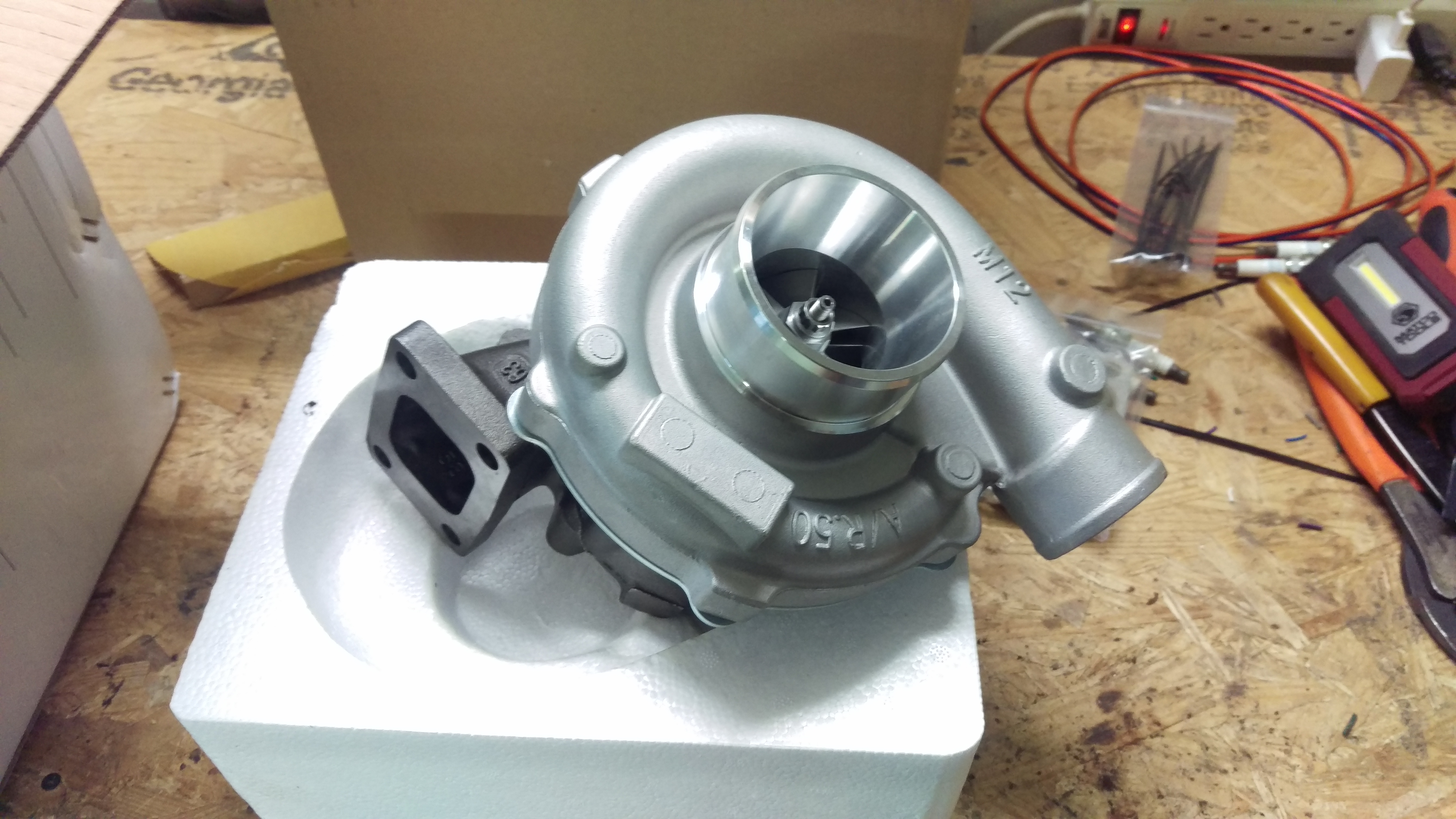

I was checking his out today on a FB post. Im not going that big just yet. Phase one will be to get about 8 lbs and driveability, while learning how this stuff works. Phase two probably next winter forr building bigger boost.

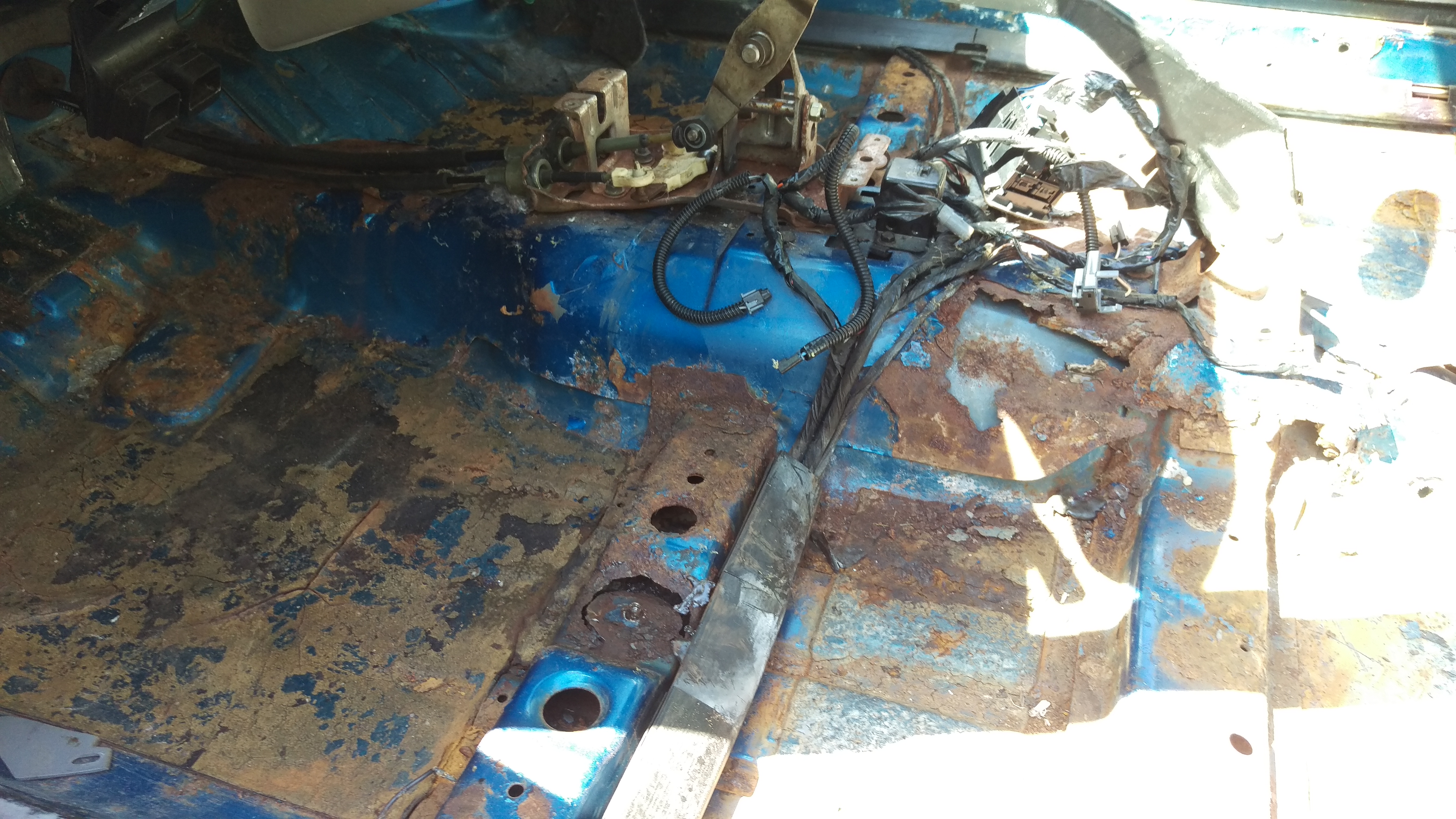

The majority is in the rear around the spring perch. So il dig into it when I do suspension. I didd notice that the door jams have been repaired before. Worst part is the tunnel under the center console. Its gone, but only on the interior side. Under the car you can't tell. Im assuming it was because the leaking sunroof

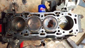

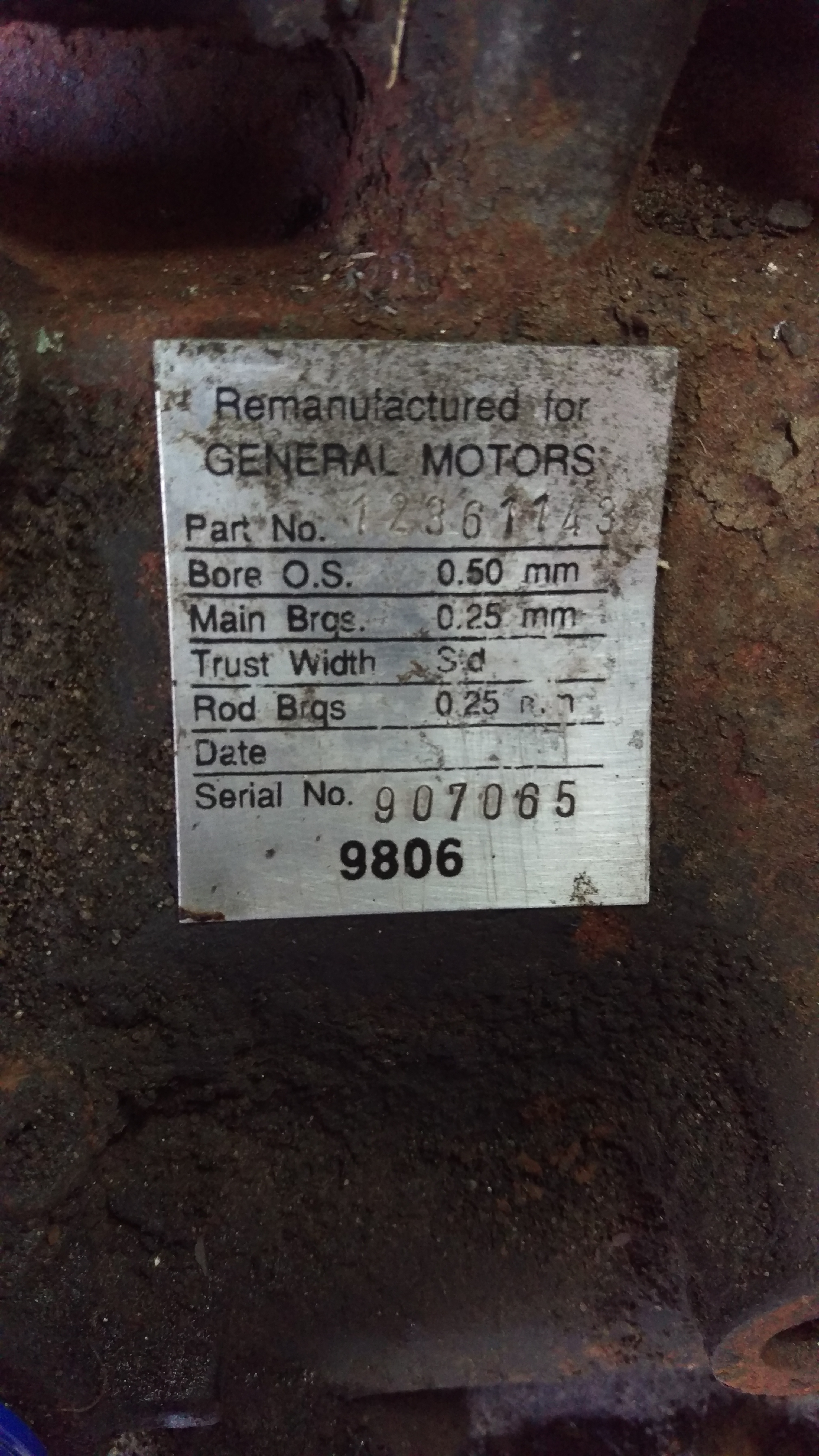

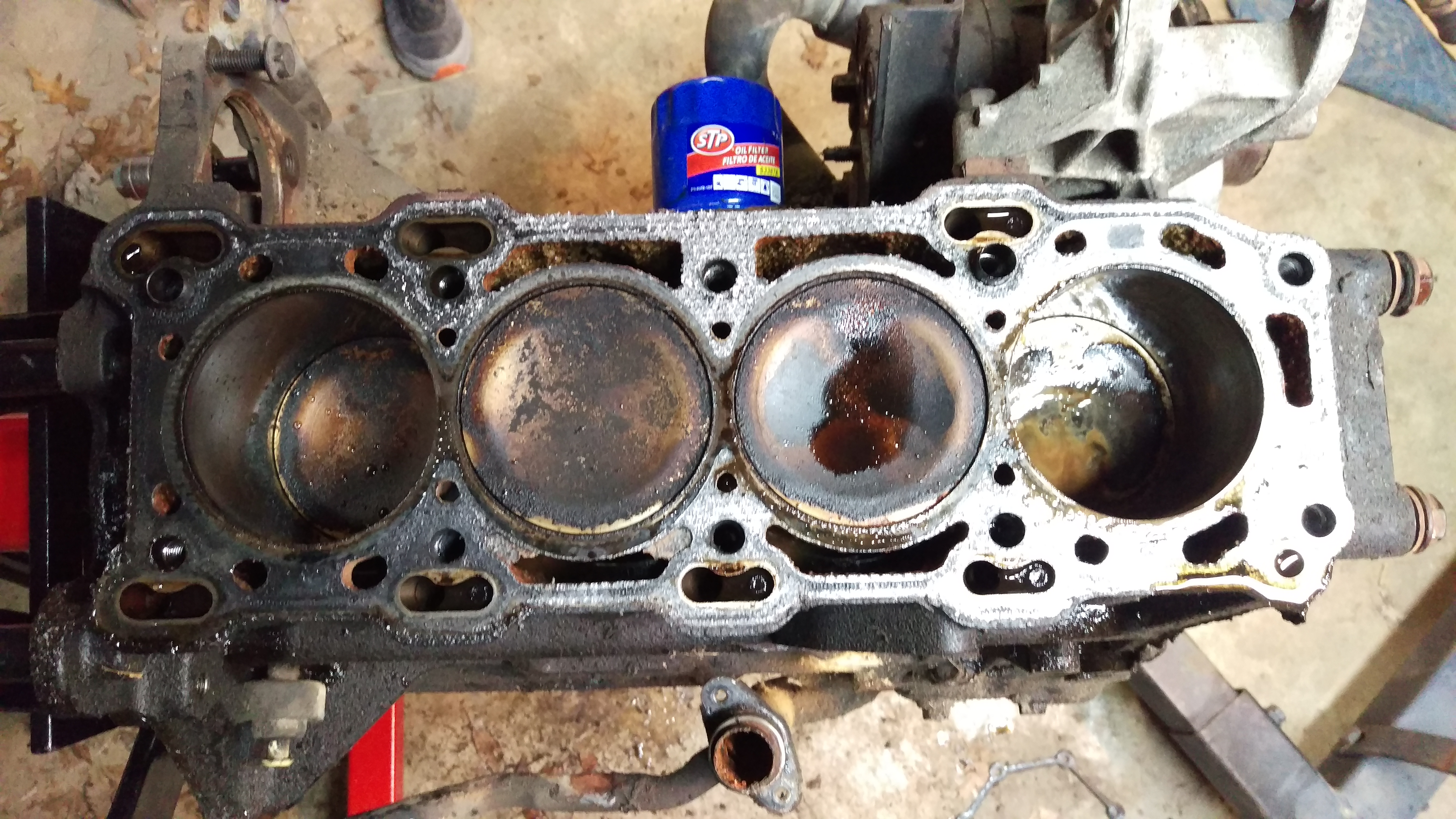

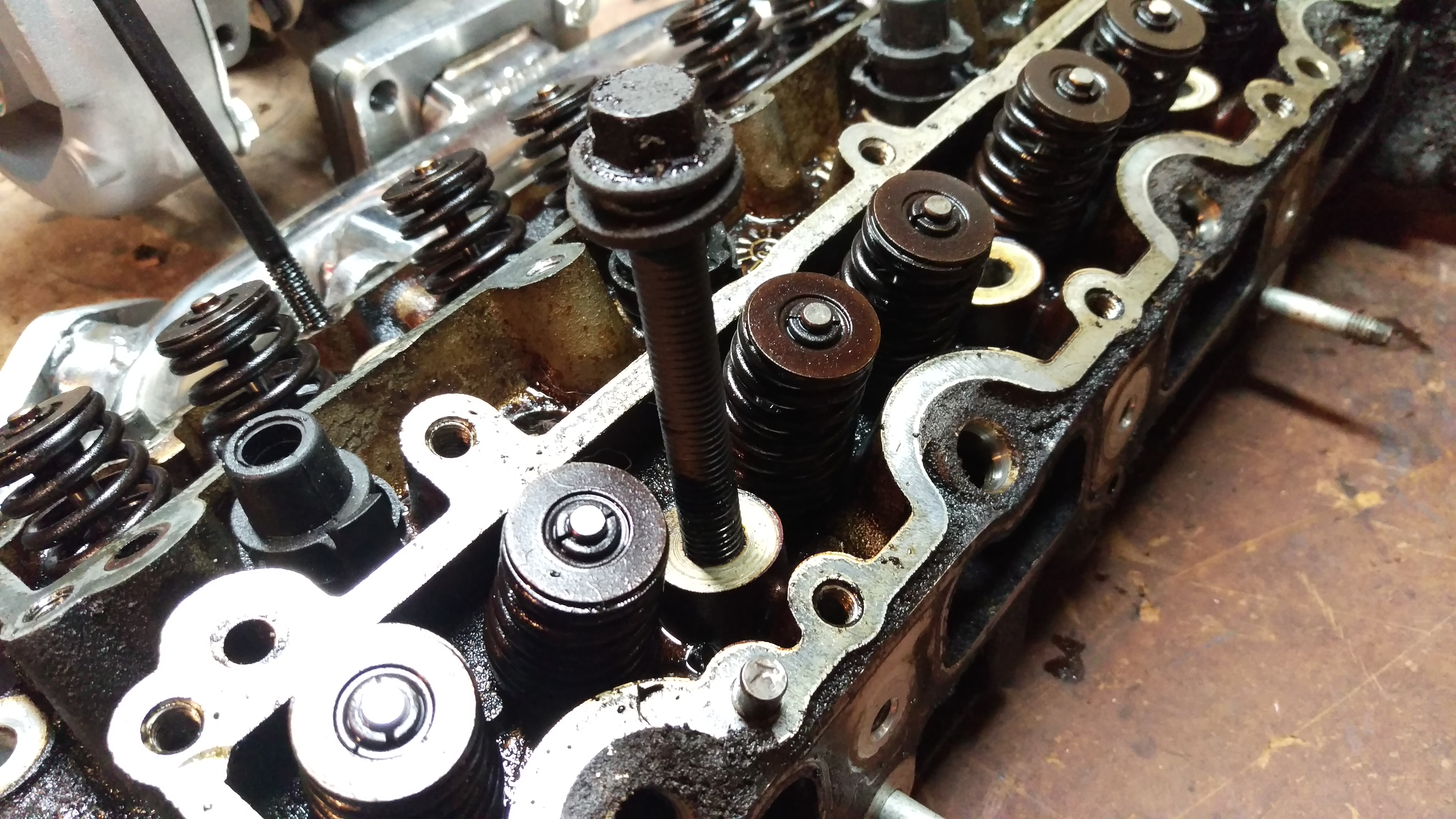

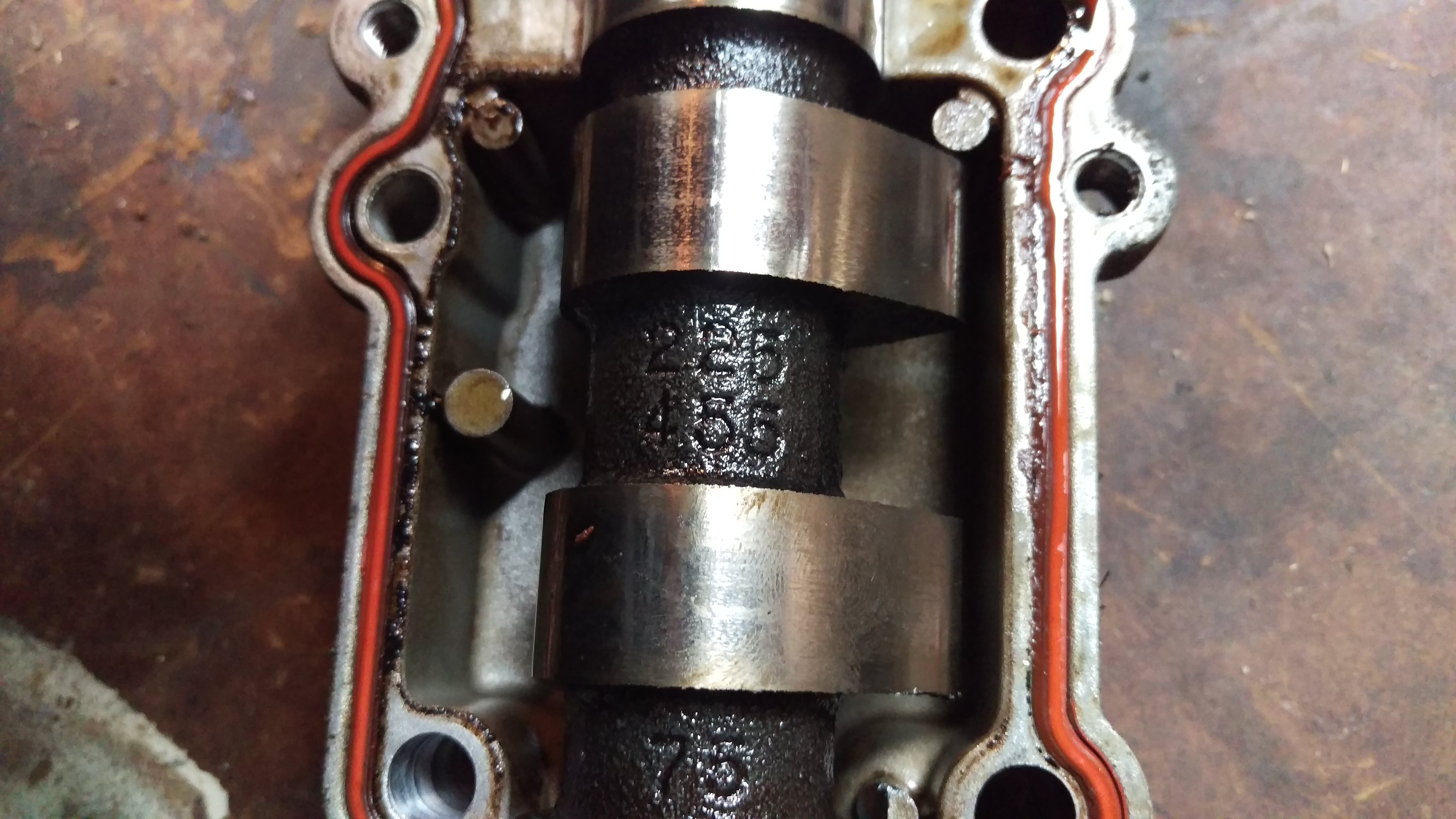

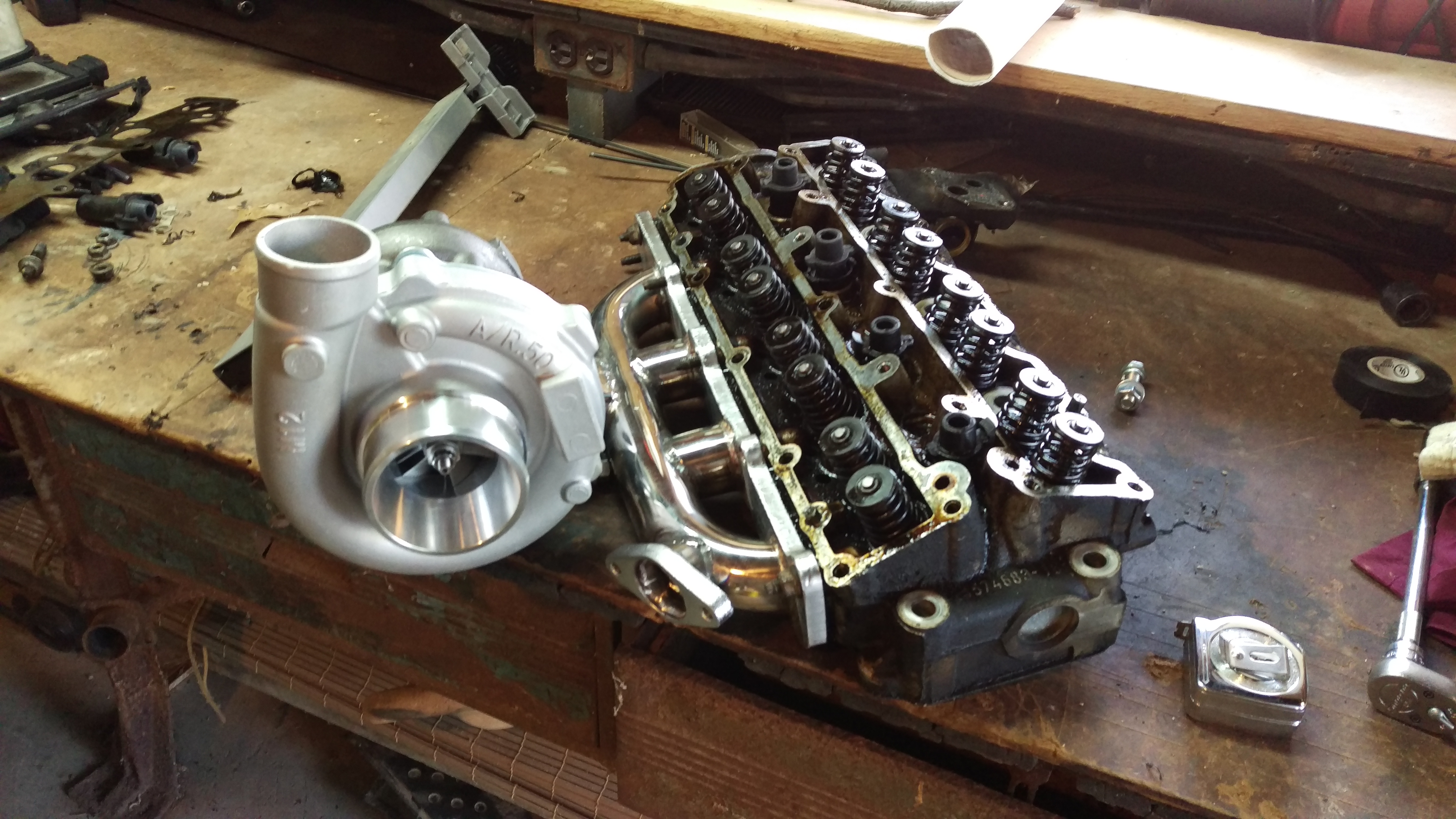

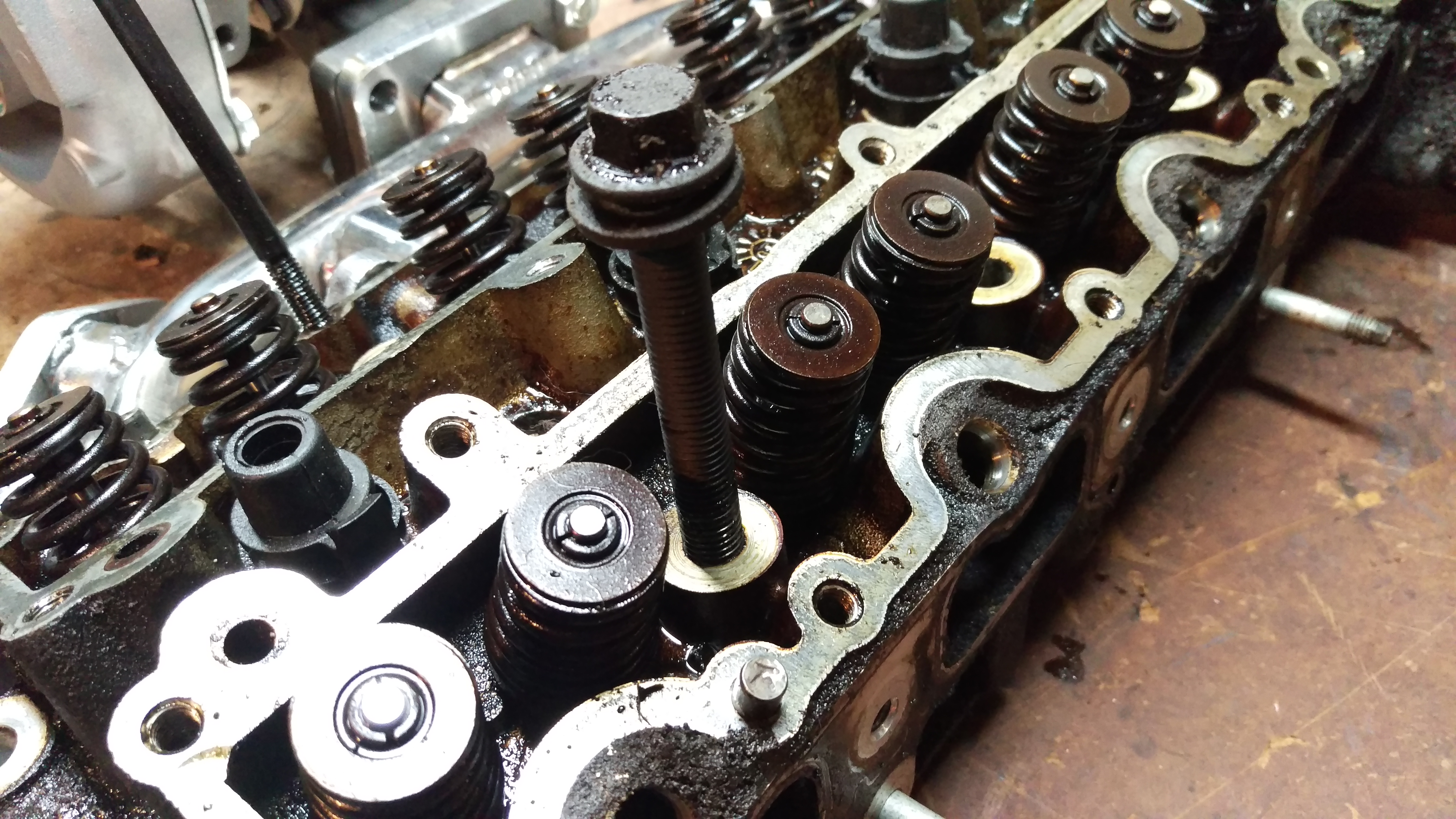

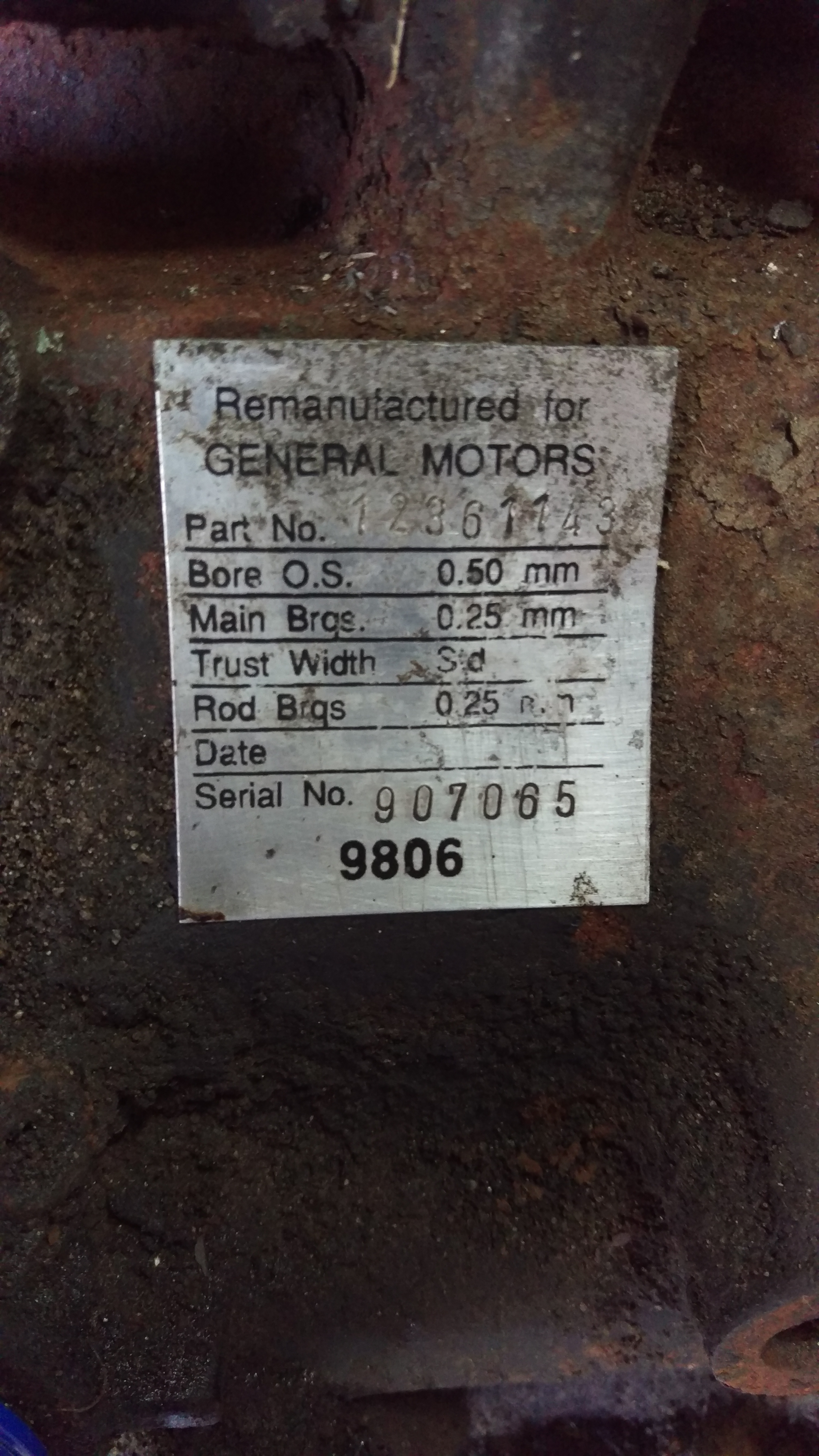

Tore the motor down tonight. Goods and bads. Timing housing was broken at the bottom. Most the water jackets were clogged. But everything else in great shape. Test fit the 2.4 head. Looks like only major difference other than chamber size and valves is the slot for the head bolts. 2.3 bolts barely dont fit.
Ron

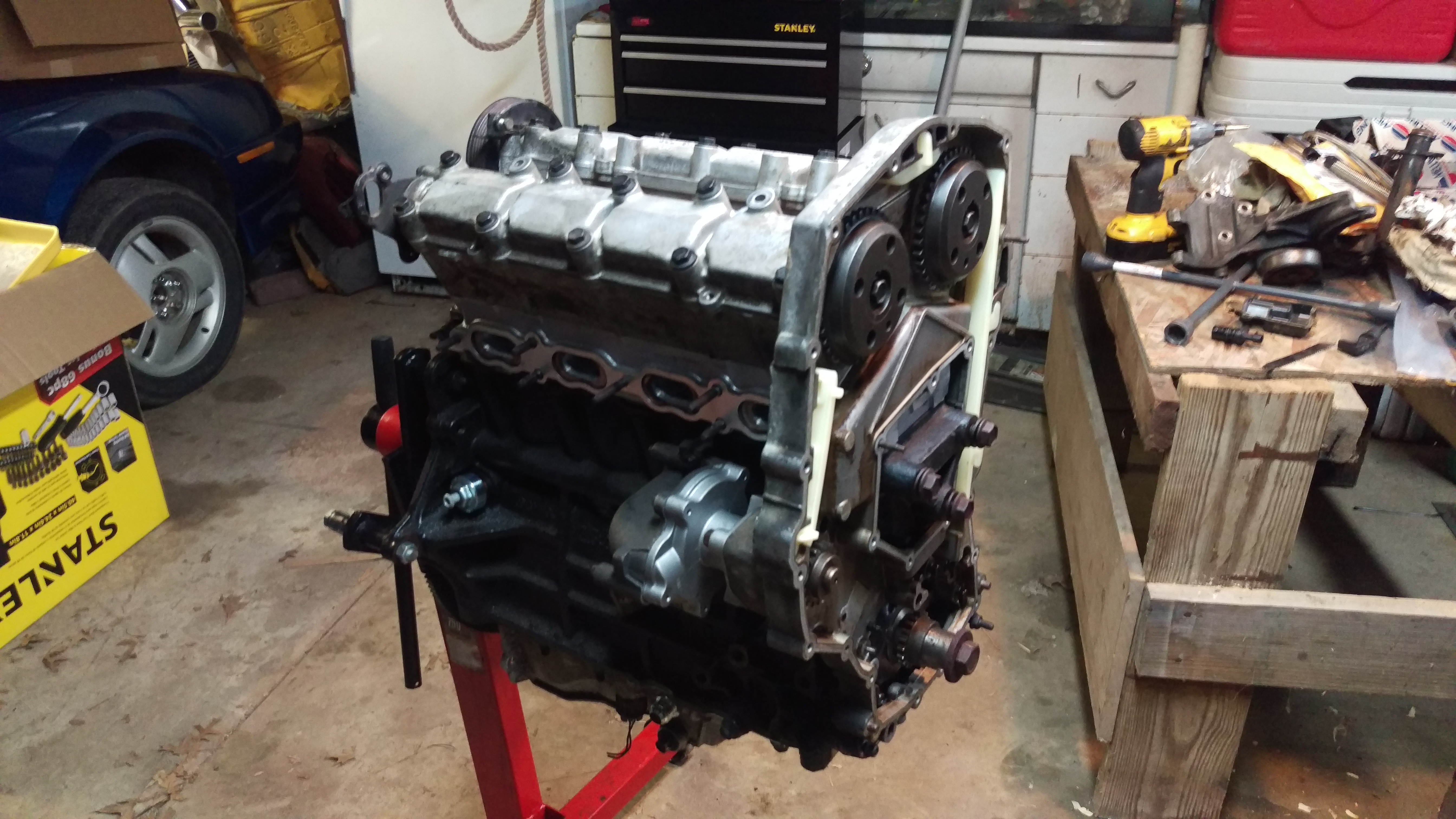

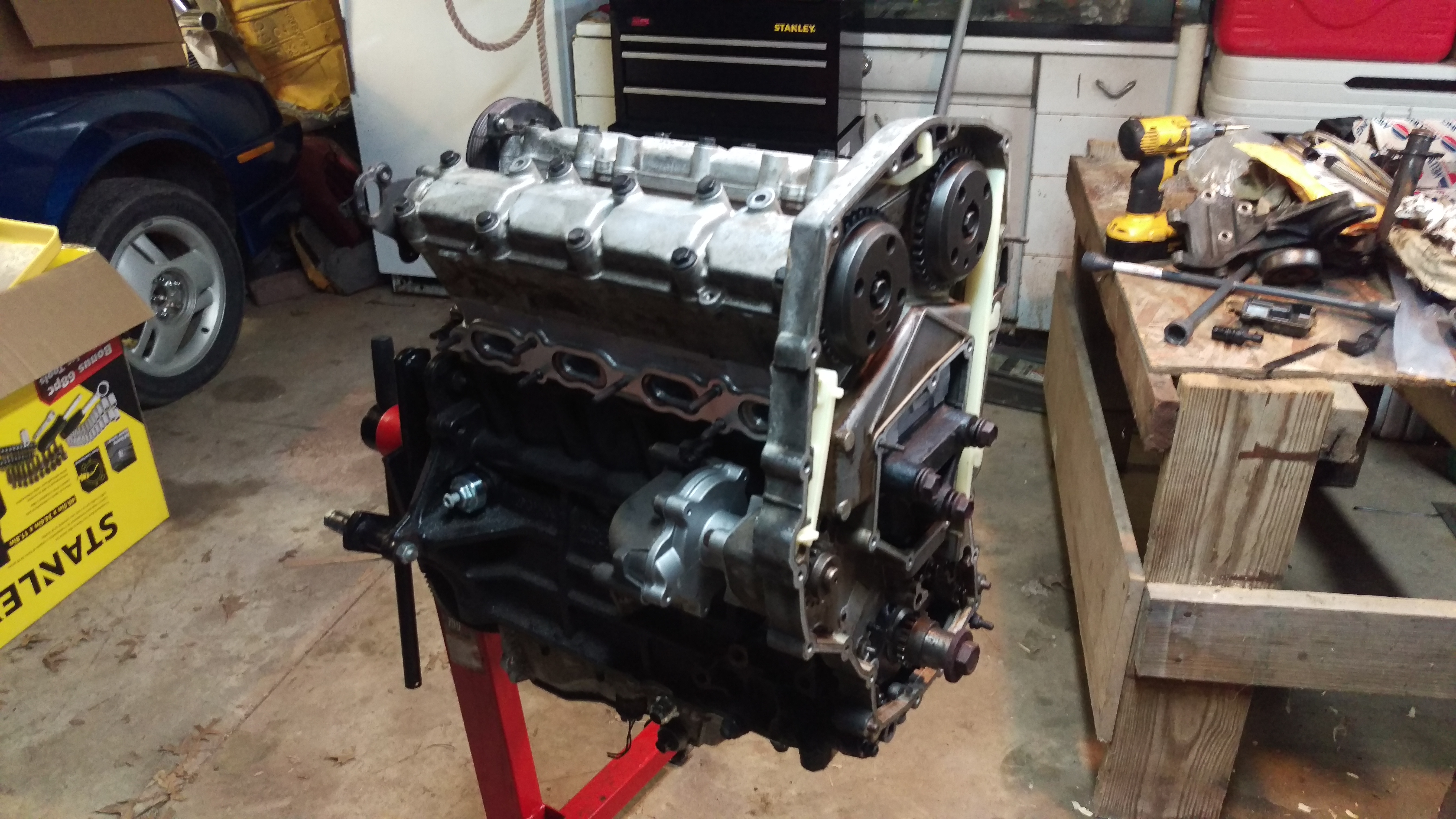

Haven't posted in a while. Life got busy. But motor will be completely together this weekend. Next steps are to clean up engine bay and repair floor boards. Hopefully get it trailer to a shop next week for new brake lines. Rate im going ill be assembling this car while on the road to branson.

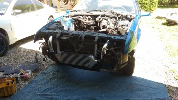

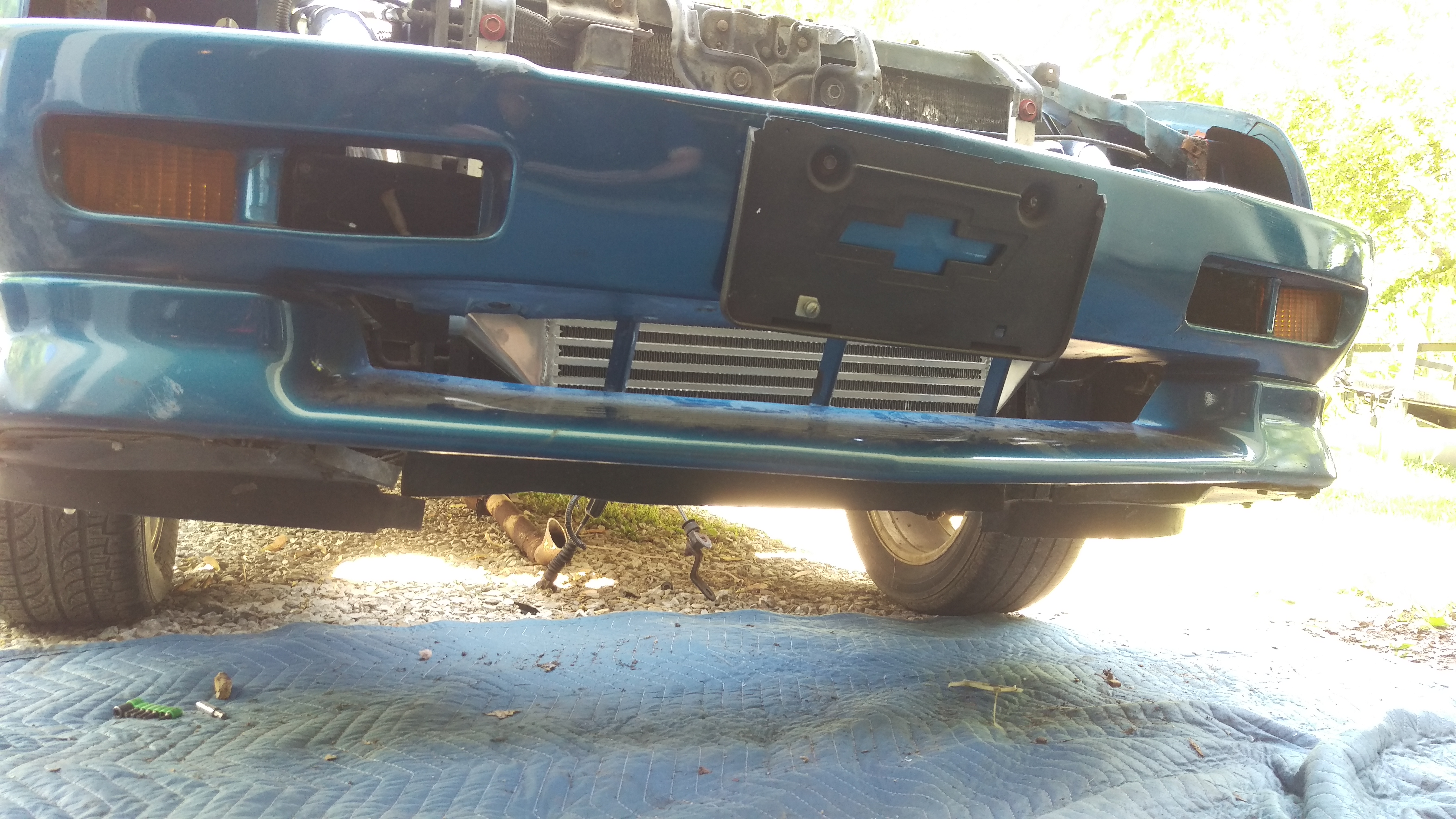

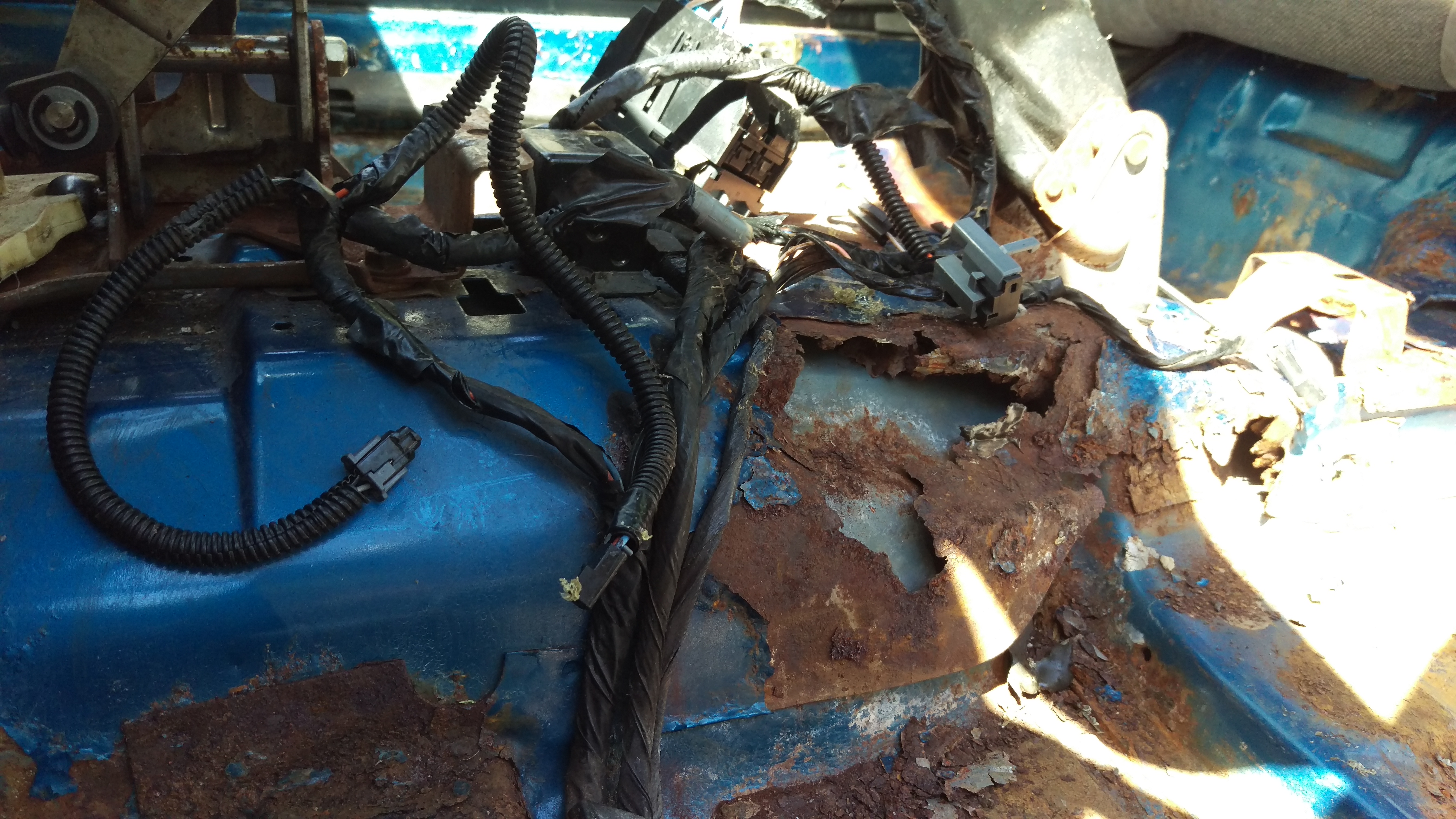

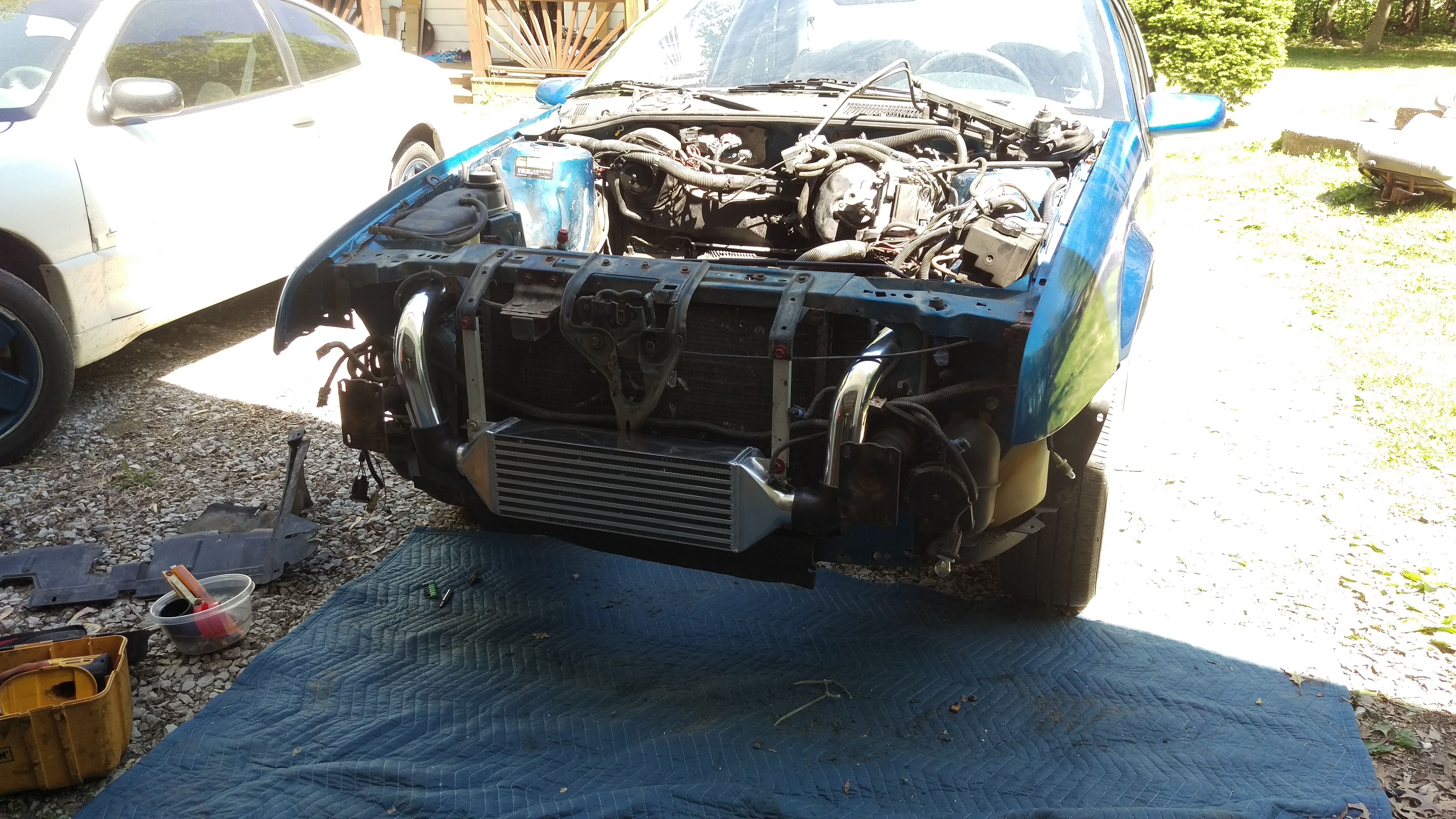

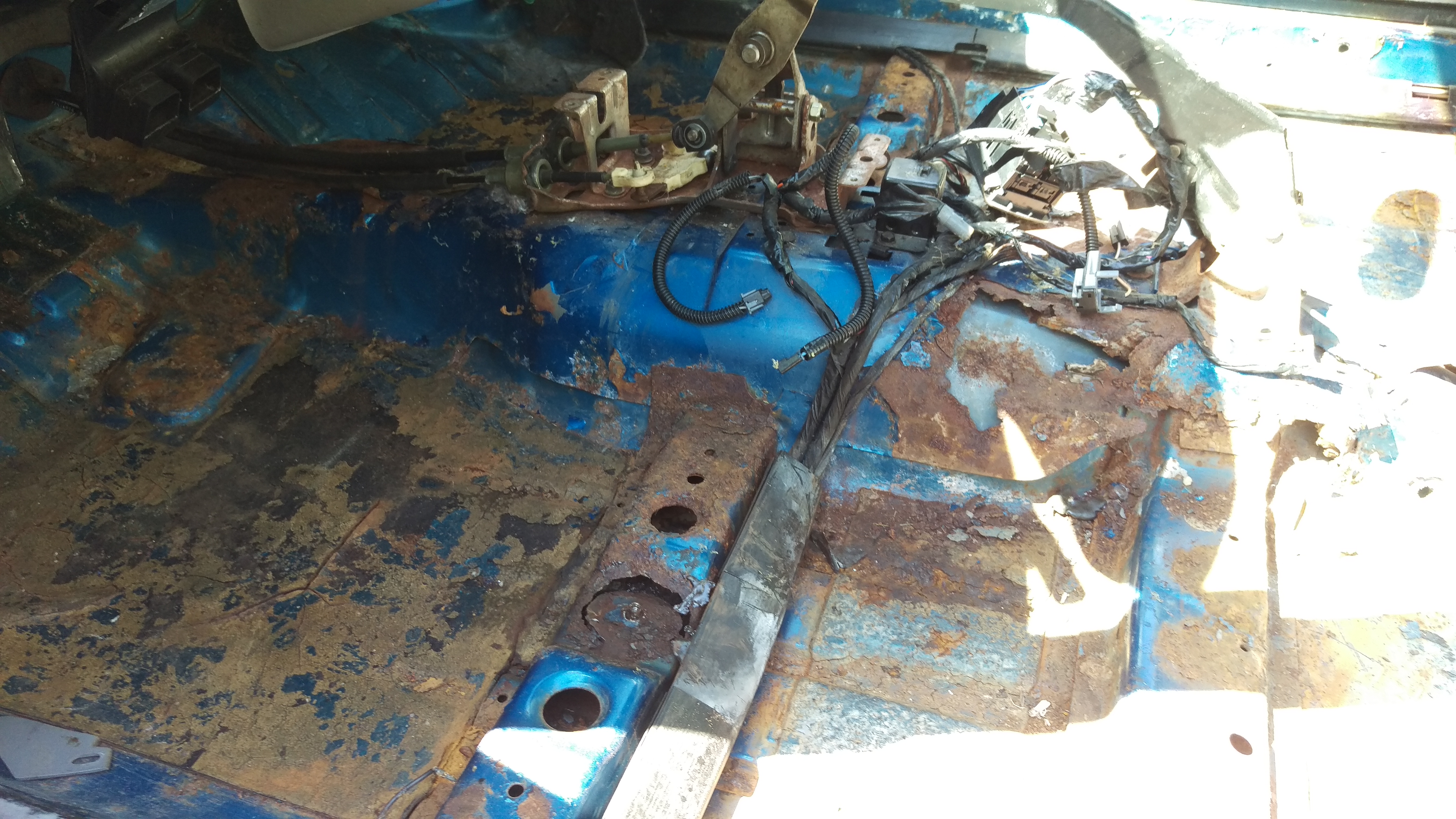

Ugh, the floor is worse than I expected. But the intercooler fits lol. Priorities.

GT_Indy
Posts: 615
Re: Its Quazy
Post by GT_Indy »
I like the way you did the Intercooler.
Gives me ideas for my sunbird.
