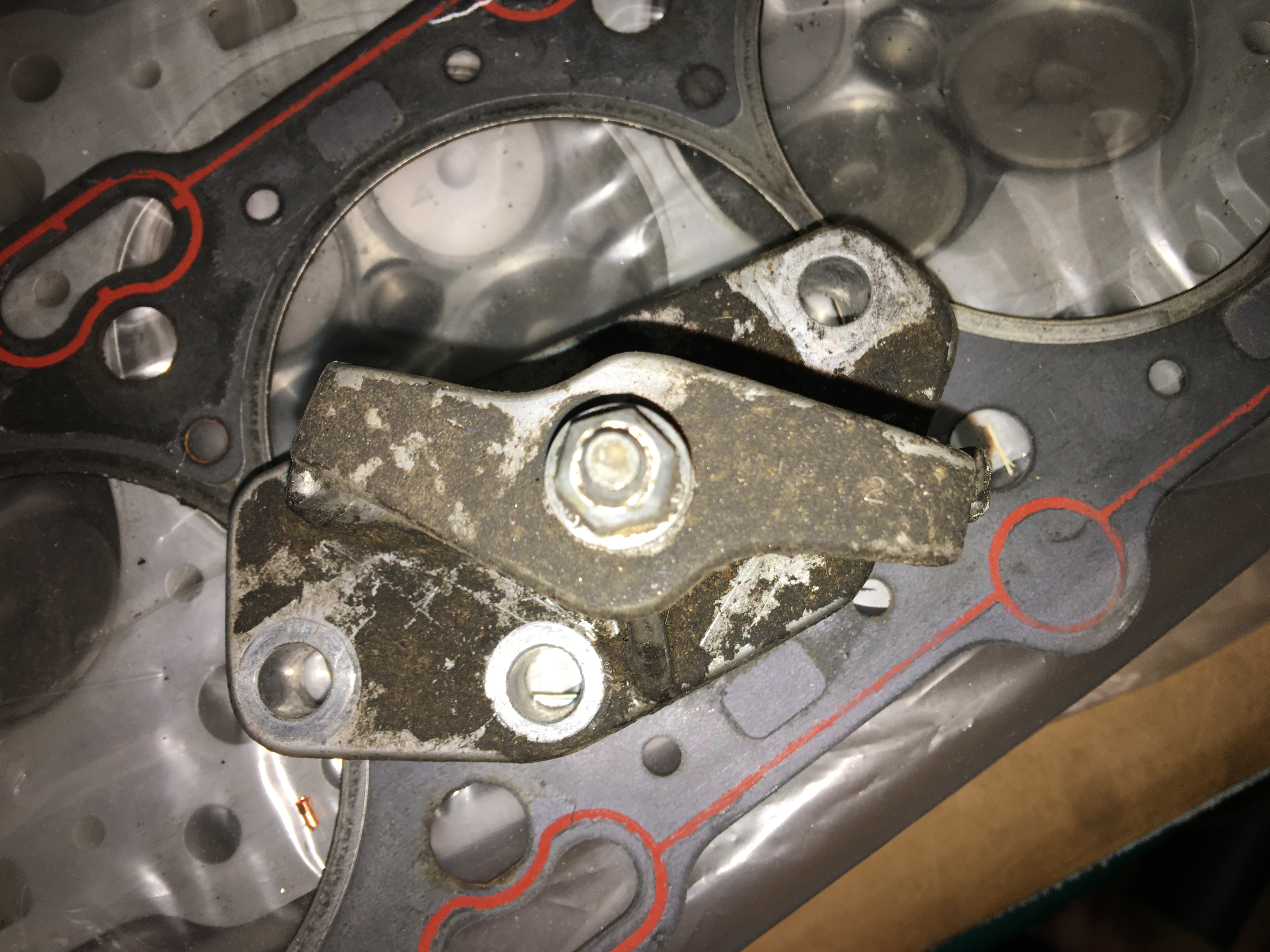

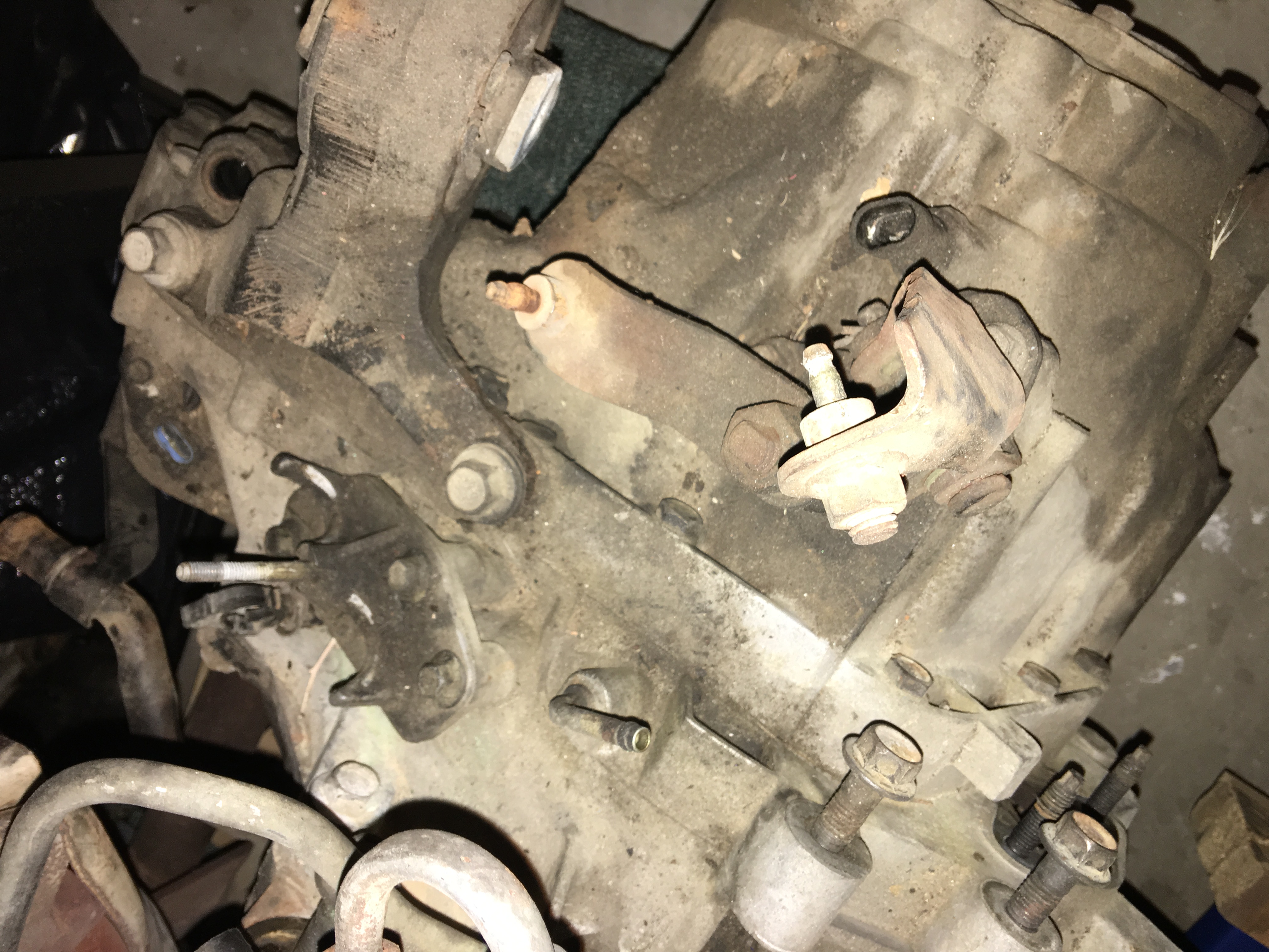

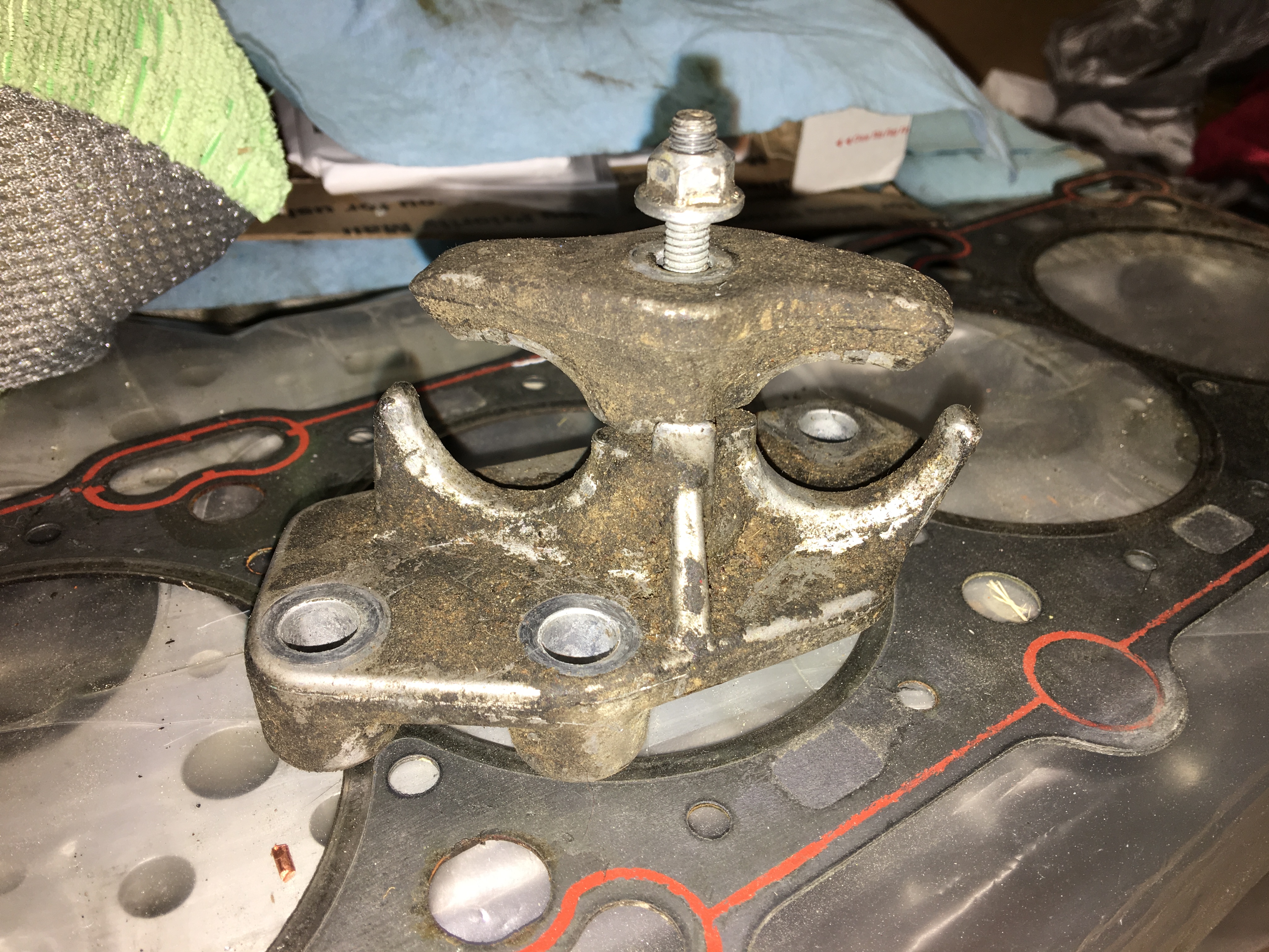

Re: Getrag shift cables
Rodney,
There is a small aluminum bracket which bolts to the transmission that holds the cables in place. Here are some pictures of one on the transmission and off the transmission. I could easily send one to you if you'd like for the reproduction.
If you have a shift or select (or both) cable on hand see how well the shifter end of the cable fits/bolts into this bracket. It should fit just fine. It is similar to the Fiero bracket where both cable end styles fit. If the shifter end fits well and secure it is settled that the cables I will make will have the same end on both sides and will be like the ends that attach to the shifter assembly.Stencil wrote:Rodney,
What we need to look at next will be lengths and travel measurements. I'll work on that soon.

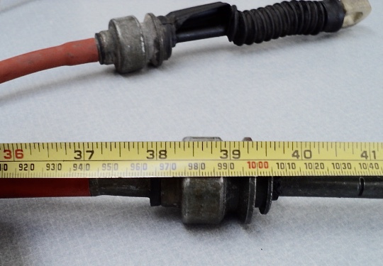

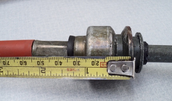

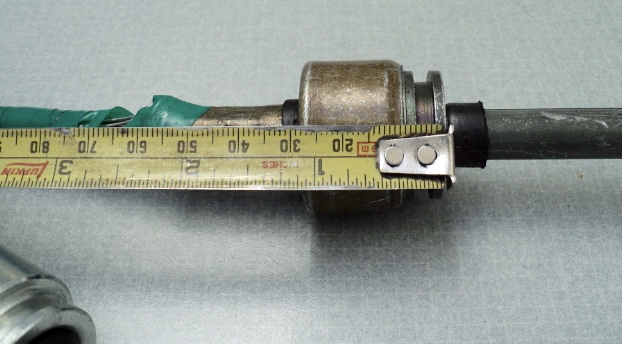

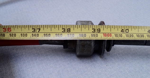

This is how to measure the length of the sheath. I need this measurement from as many of you as possible. Both shift and select.
For convenience I made them both 1000 mm. That is not the actual length of the cables I have on hand.
Thanks
Rodney

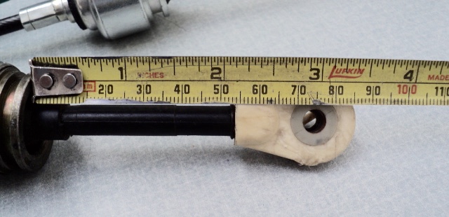

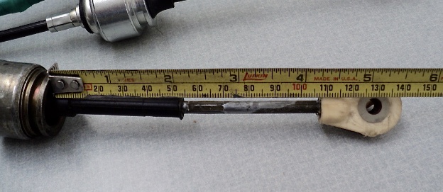

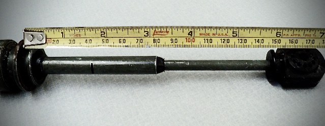

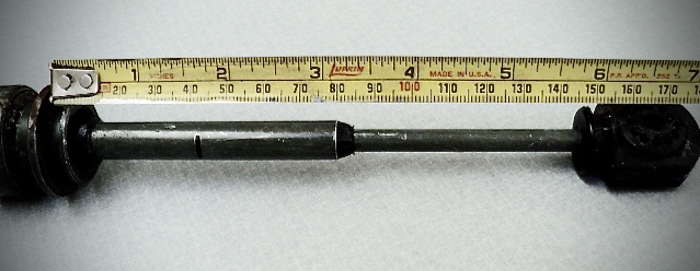

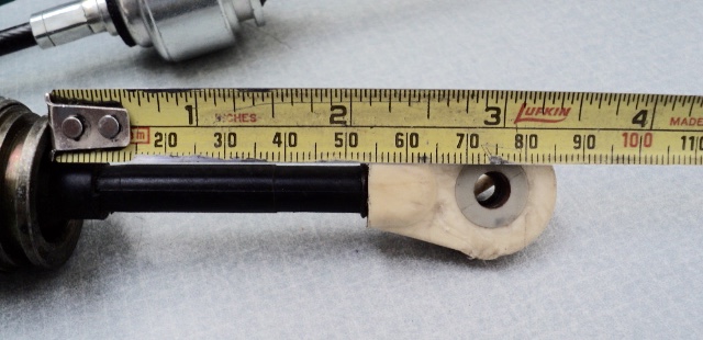

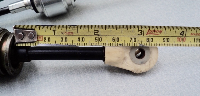

I also need compressed and extended lengths.
Compressed. The top one is about 103 mm. Measured to the center of the hole. The bottom one is about 75 mm to the center of the hole.

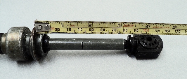

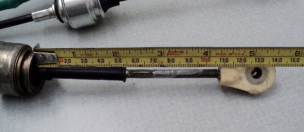

Extended lengths.
The top one is about 165 mm. The bottom one is about 128 mm.

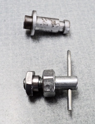

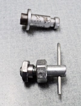

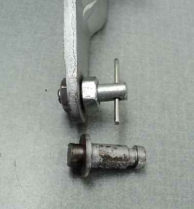

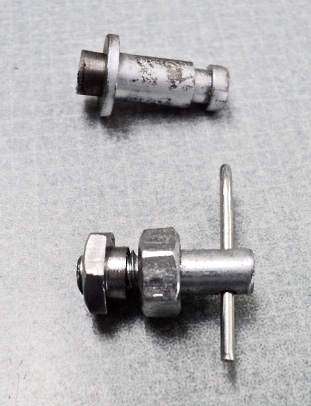

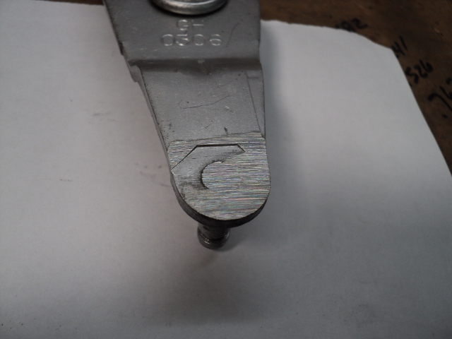

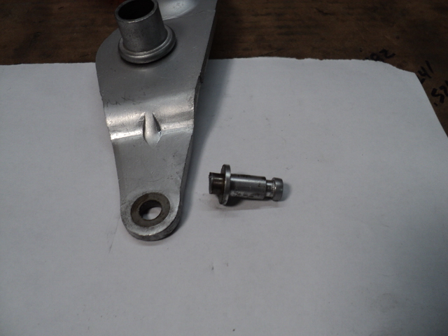

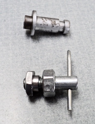

We can talk about the cable ends on the shifter end. On the Fiero they use a hair pin. I made a bolt in conversion pin. This is the same on the shifter arm and the select lever on the shifter. Grind the backside. Hammer out the old pin. Bolt in the new pin. Possibly this is the way I would make these cables. Everyone would need to change the pins on the shifter arm and select lever.
