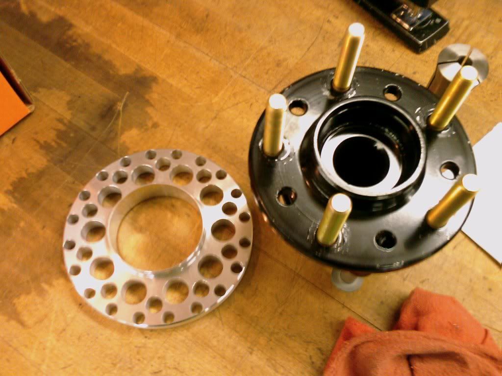

Hey Jon you got pics of the spacers you used and you put them between the hub and the spindle correct? I wanna see how yours is set up.

Here are some pics of them.
You need longer studs too if you do them.

Wait a min, i thought the hub had to be spaced to help with axle bind? I thought your spacers were between the hub and the spindle? Hmmm

No, thats just a theory... I think the spacing is perfectly fine. It's just that one of my boots was touching itself in one area and rubbing. But IIRC it might have done that on the Red car too. Might be the brand or assy of the axles I'm using.90GTZHO wrote:Wait a min, i thought the hub had to be spaced to help with axle bind? I thought your spacers were between the hub and the spindle? Hmmm
As noted in the big brake thread, these knuckles pull IN your rim so if you are running stock offset with a 225 tire you will hit the spring perch on the strut without a spacer. This does bring up the question that it may be shortening the distance between the bearing and the trans, but that is not verified yet, and since on my car the boot was only touching on the passenger side I really do not think its an issue because the drivers side looks perfectly fine.
Now that the snow is gone, I should have the chance to jack up the red car and measure that distance on a stock setup and then compare to mine when its all back together.

Cool, yeah man let me know what you find out. I think the wheels i just picked up have a lil bit bigger offset than the stock wheels as these 17s do not rub the strut at all.
