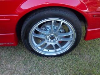

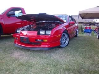

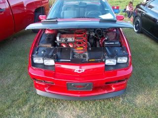

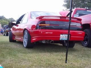

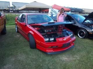

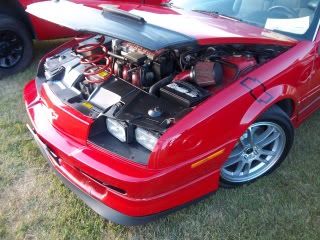

1991 GTZ :Updated Pics:
Post by Kris GTwhat? »
these pics are from a local car show we had yesterday. enjoy!!!
