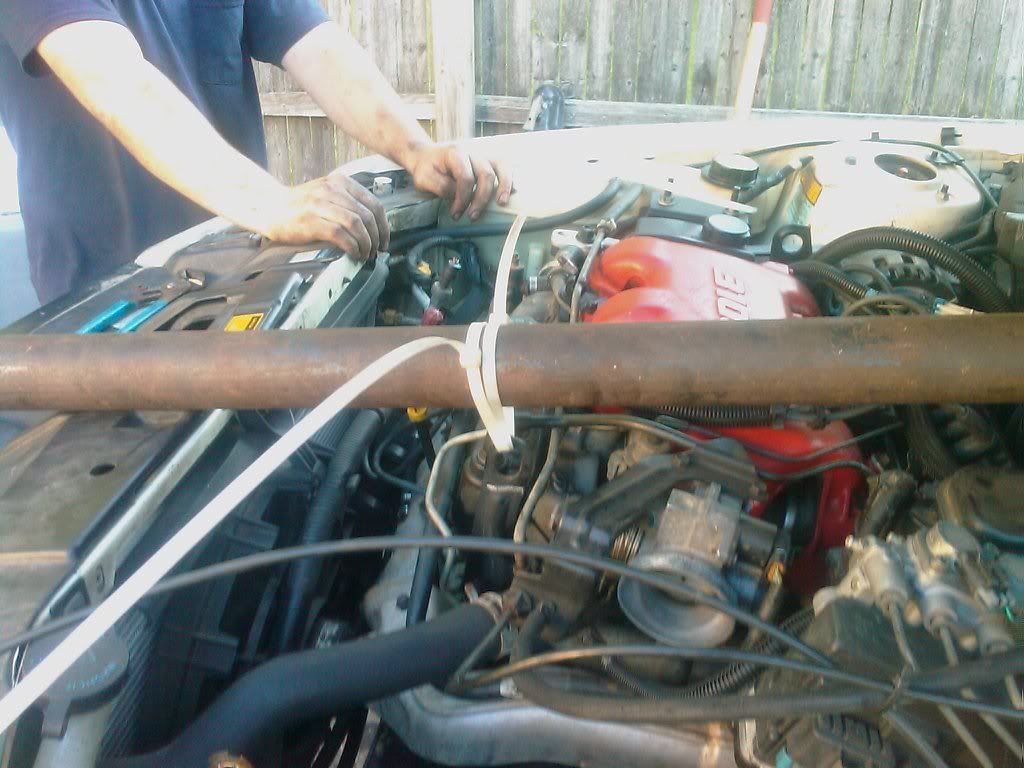

Well I pulled a trans out of a 95 corsi today with 70k on it. I also pulled the trans from the beretta. Ill throw the new one in tomorrow. A trans jack would be nice. With the 5-speed I just put it on my chest and push it up and in. With this 2 ton turd its gonna be a floorjack manhandle.
Jon, look familiar?
Posts: 10916
Re: I am doing a 4t60e swap
Trans jack makes it WAY easier
But I did the floor jack and piece of plywood for many years.
