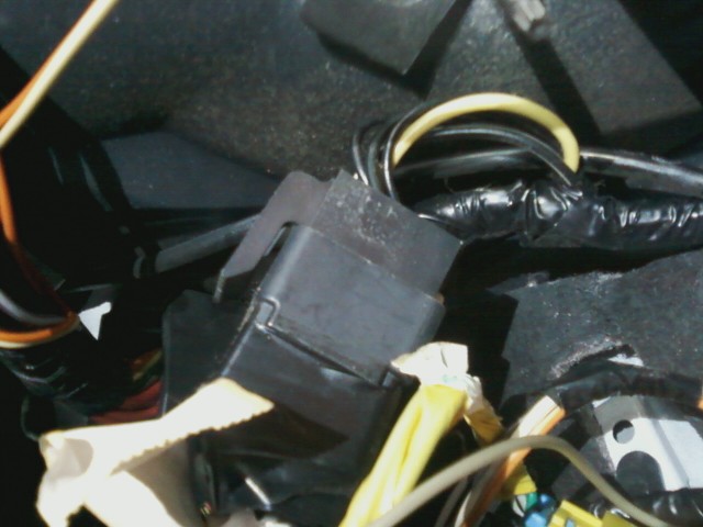

i pulled the flasher(round two plugs) and of course the hazard lights stopped. i pulled the square white one next to it assuming it was for the turn signals but it wasnt. where is the one i should be looking for?
i also noticed this morning that the slow down is consistent with when i begin to turn the wheel.

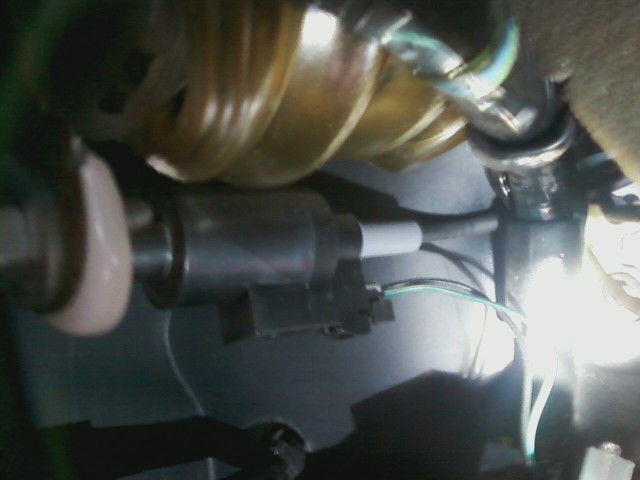

themadness
Posts: 885
Re: turn signals stop when i do......
Post by themadness »
it usually gets erratic below 1500. my wife says just live with it, my OCD tendencies wont let me.
which of these could be the culprit?

Posts: 10923
It looks the same as the hazzard flasher, its clipped way up ther, its round and silver.
This is what I put in my 95 when I did the euro tails.
