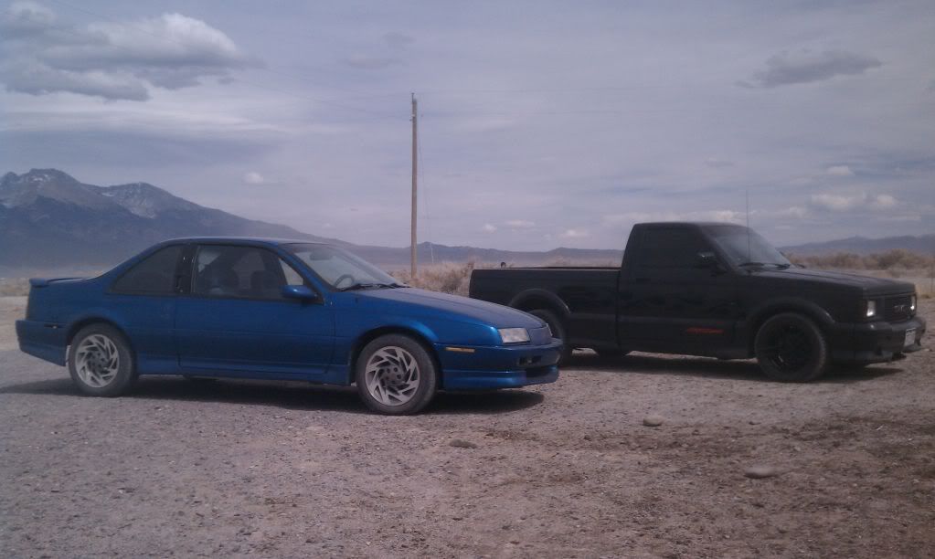

Pic of the quad with my syclone, I had to put a new trans in the syclone. the quad is running good, I've put about 400 miles on it no problems except for the shifter cable bushings. Got 36.9 mpg the last tank, I'll take some pics of the interior and engine bay next weekend once I get a free moment to snap them.
