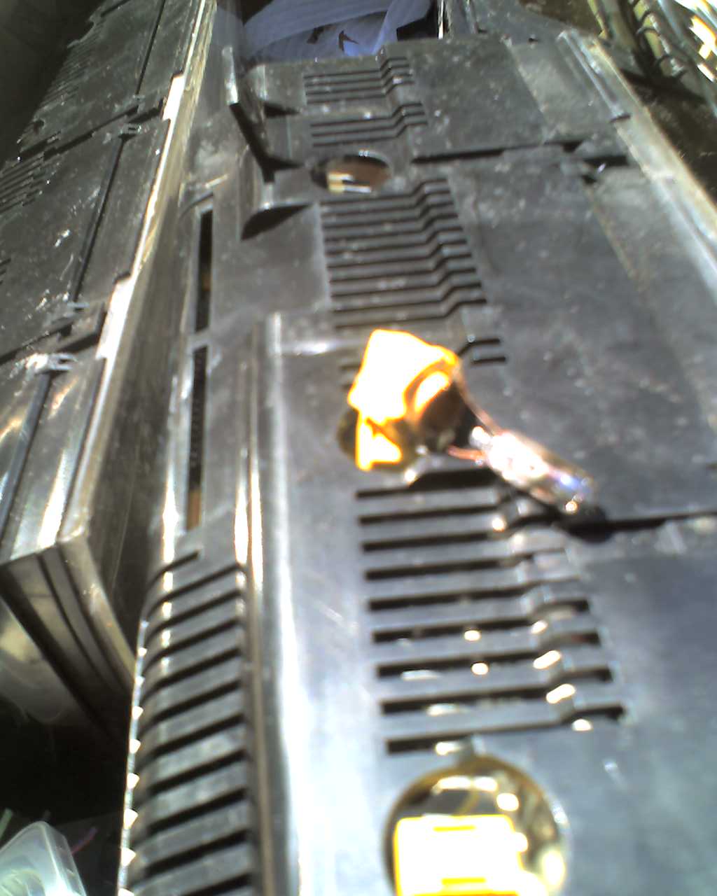

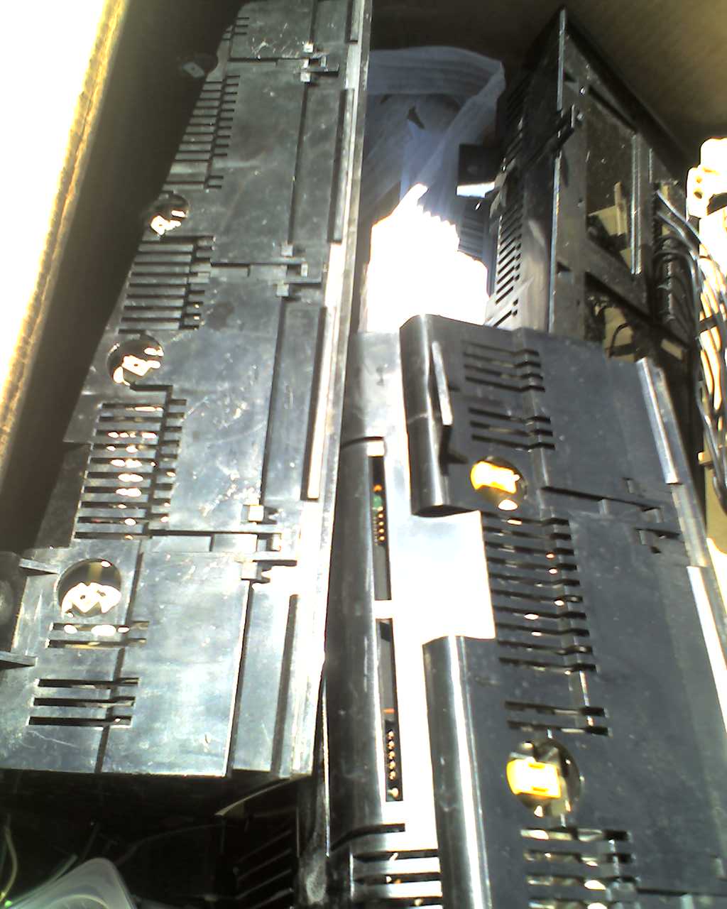

... And the winner of the worst photo is...
Uber-blurry shot of two different bulbs.  Slight difference in bulb size, but it looks like the circuit-boards have the same size holes.
-and guess what? Neither one is a 194! I am thinking those were in the '90 models, so it is looking like they changed them every year...
The difference in these bulbs are cosmetic, I would say.  The plastic twist-in socket is very different, but do appear to interchange.

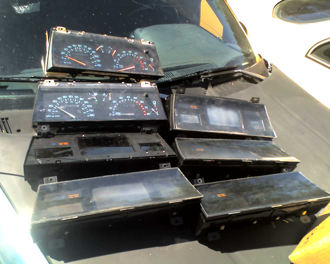

I will be pulling the cluster out of my '90 Yellow Indy here shortly to start testing these other clusters, mainly for Lespaul59. I will try to snap a pic of the bulbs in that one, I really could have sworn they were the T10 (194, 168, etc) style bulbs usually used in GM instruments, but now I am wondering, as that would mean that ALL of these clusters I have as spares are '89 and older:
Um, a cluster-junk?  Hopefully not junk clusters...

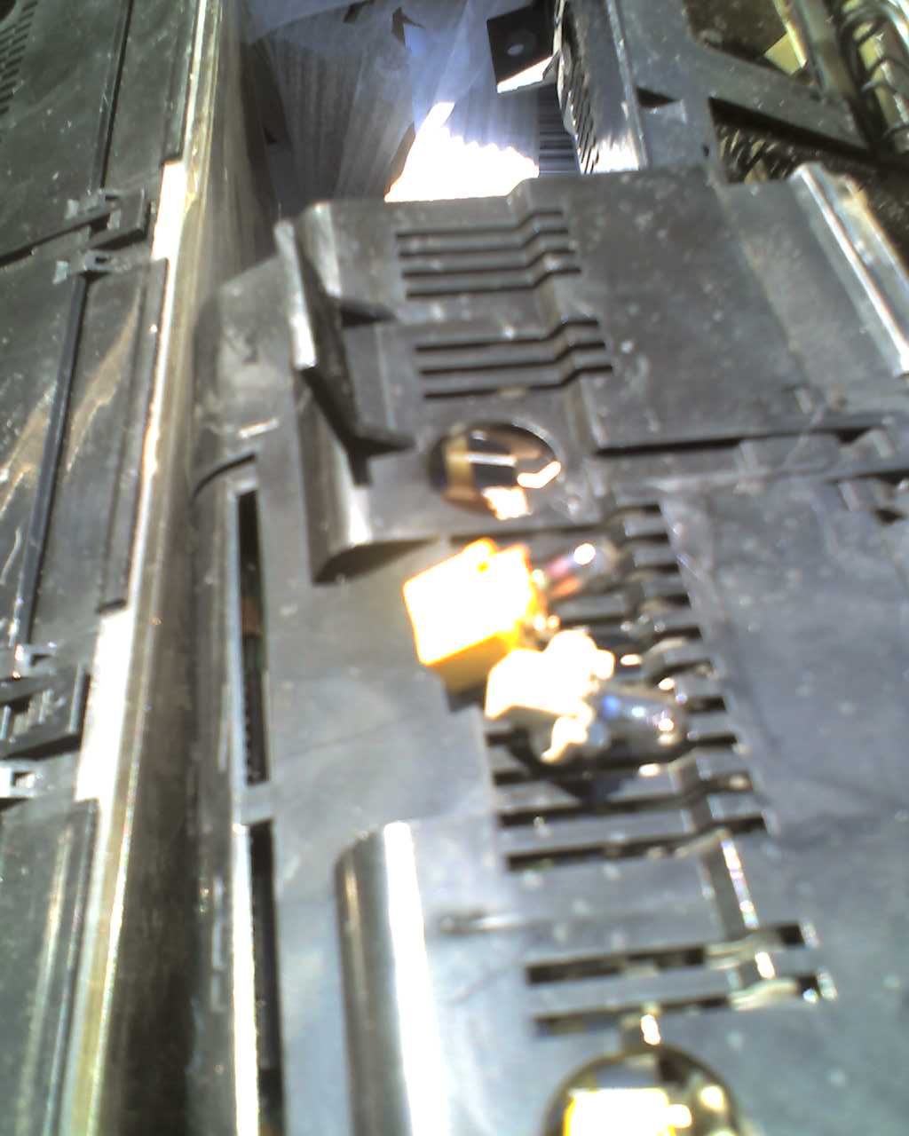

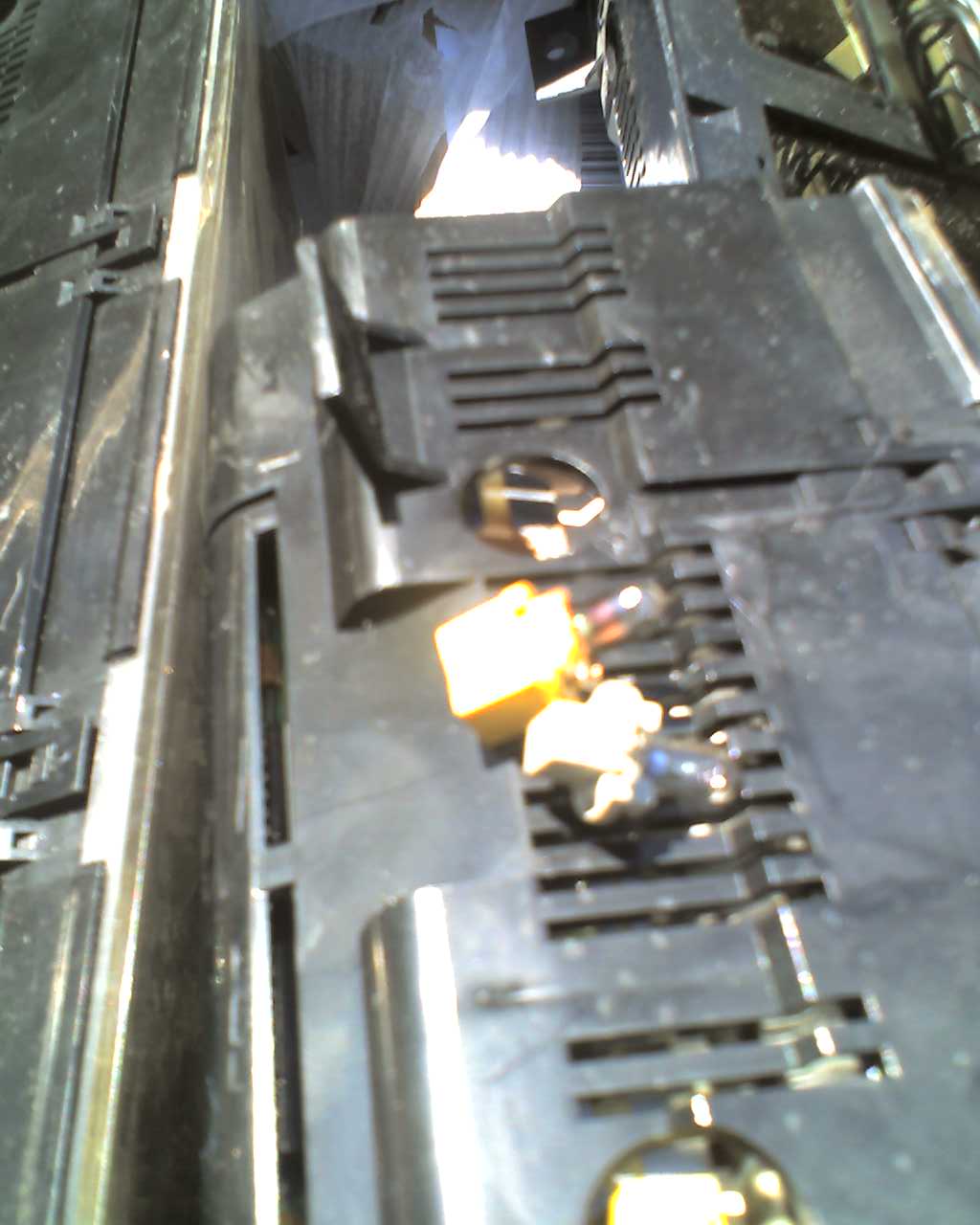

Here is worst-photo runner-up, but I think you can see that the bulb pulls out of the socket cleanly, with the wires fused to the metal tangs of the socket...
