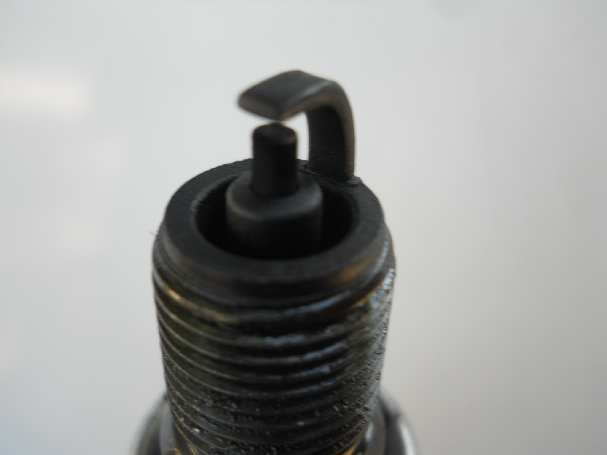

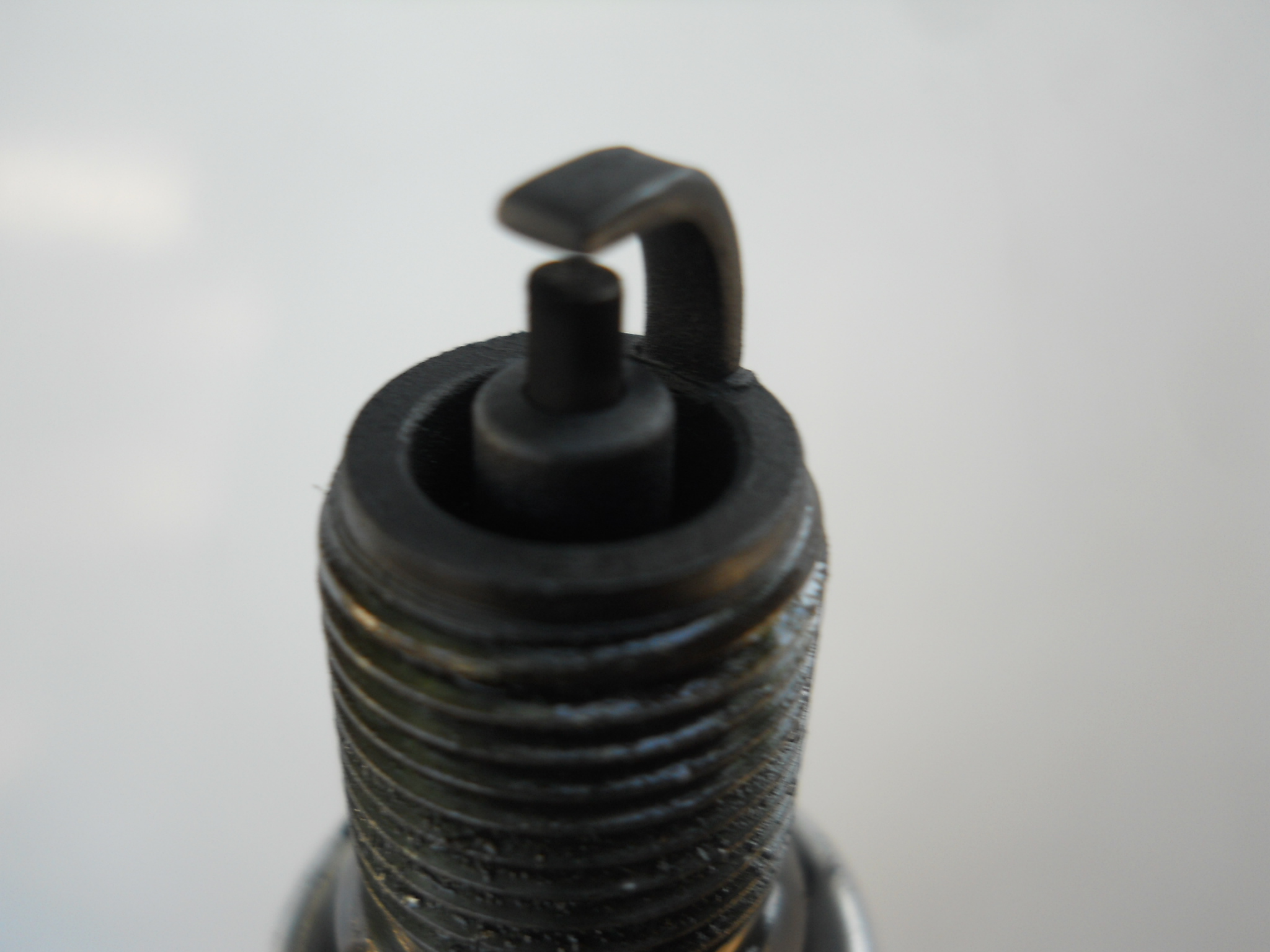

Well I replaced the ICM and no change but I got a code 44 and my old spark plugs were black what do guys think?
Chevrolet Beretta GTU/GT
Posts: 10916
Re: Automatic 2.8 GTU Hesitating
Did you swap the coils too?
Code 44 is lean condition detected... Have you checked out the O2 sensor yet? You may have coated it with carbon and thats affecting its reading, but I would try coils see if that cures the dark plugs, then look into injectors.
I'm not sure how well that O2 is after being drenched with fuel like it sounds like it has been, or at least judging the color of the plugs that sensor has to be caked.
