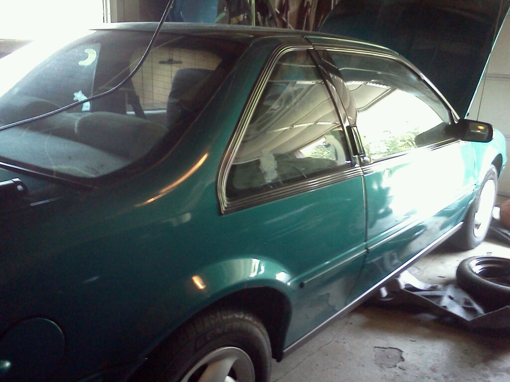

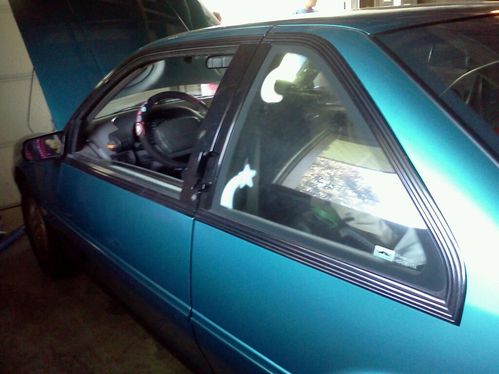

sorry it took so long to get some pictures up, i've been super busy!
& they're not the best because my car is stuck in the garage at the moment.

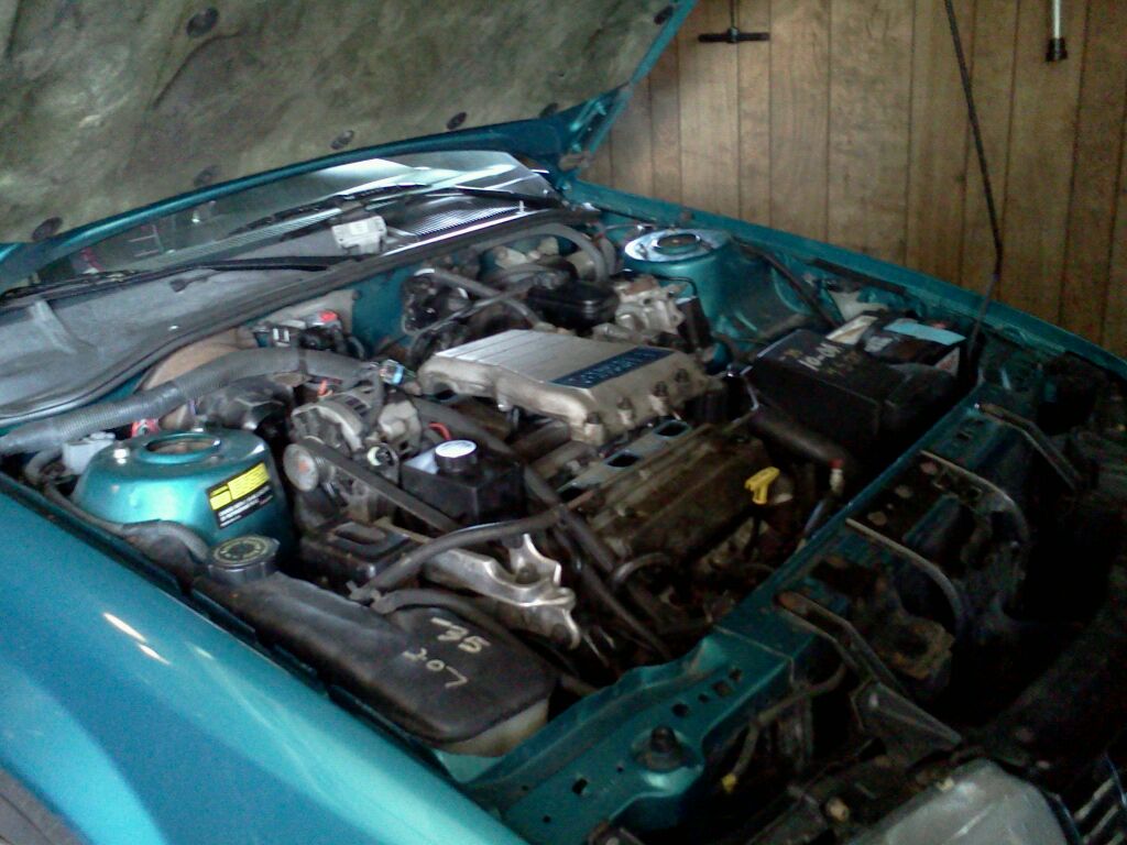

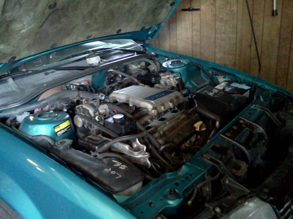

Engine bay is very clean for sure. From what you posted the rest of the car is just as clean.
Water leaks in at the back window because the little strips that seal that area fell off(something that happens alot). It is the gap between the top of the door and the rear glass. You can put some windshield sealer in there just under the trim for the back glass.
Pic #3 shows that the strip is not there. That strip does two things: 1. it is for looks. 2. the back of it dips down to seal said area.

the strip is there, it's just definitely not sealed.Money pit Beretta wrote: Pic #3 shows that the strip is not there. That strip does two things: 1. it is for looks. 2. the back of it dips down to seal said area.

Ok Challenge time! One pic is a 93 Aqua, one is a 94 Bright Aqua, but which is which? LOL
Re: hey everyone! new here!
That would depend. Daytime or evening pics. Bright Aqua changes color with the intensity of the sun. At night it looks like GTZ Quasar Blue. In broad daylight it looks almost green enough to be a teal. Hence the confusion. And cameras usually don't capture the color correctly either.
- scd88ga
- Posts: 1828
Both pics above were taken at the same time on the same day and the cars are parked right next to each other. Figure out which is which yet? lolDTMAce wrote:That would depend. Daytime or evening pics. Bright Aqua changes color with the intensity of the sun. At night it looks like GTZ Quasar Blue. In broad daylight it looks almost green enough to be a teal. Hence the confusion. And cameras usually don't capture the color correctly either.
