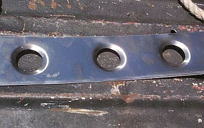

Re: Camaro paint job...after almost 10 years
Needs dimpled speed holes:
