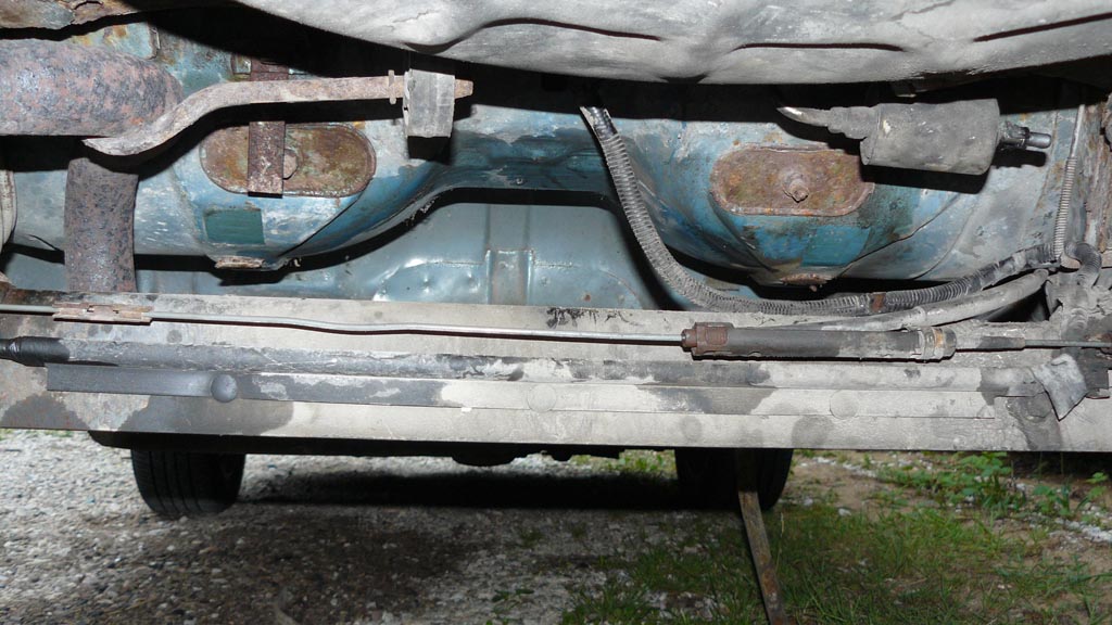

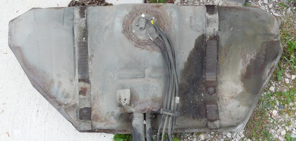

OK, I managed to brave the rain and the mosquitoes and put the car's rear end on jackstands. Crawled under there and pulled the gas tank. We had a heck of a time getting to the straps, it appears the bolts are simply f'ed. So cut the straps with tin snips, pulled the hoses and dropped the tank.
After looking at this thing, heck it could be leaking from several different places to be honest the scale rust is so bad on this tank. Most likely spot is on the passenger side where the seat well sits into it. Anyway it is just junk. Here are some pics.
This is the old tank. May not look like it, but it has a lot of rust around the seams and the filler neck, etc. It is fubar.

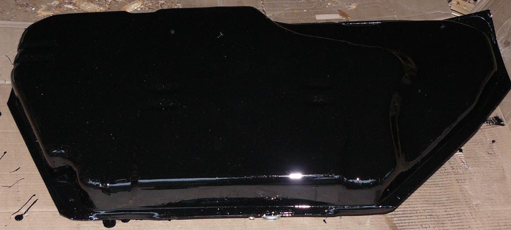

New tank, right from RockAuto with a fresh thick coat of Rustoleum black. I did wipe this tank down first with several rounds of wax & grease remover to get the oily slime off of it before painting.
Just a shot toward the front from under the bumper

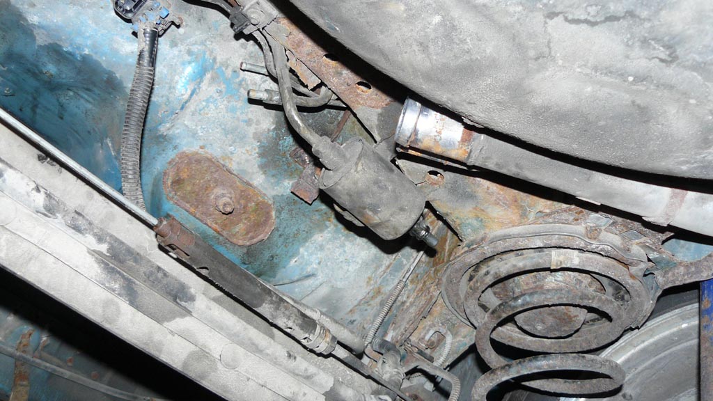

Picture of the hose fitting area, filter, etc.
Once the new tank finishes drying, I will move the pump and stuff into it, then install it. Before I do that however, I have to cut the old bolts out with a cut-off wheel or a torch, and ready some new bolts. Bout' the only thing under the car that bothers me rust-wise right now is the crossmember on the front side of the trunk. It is rather scaly, but other than that it doesn't look to awful bad under there. Few spots in the floor pan but will be fixing them later this year when I pull the carpet. :p
Anyways, will try to have this done sometime later this week/weekend, as my next 2 days are solidly booked, unfortunately.

Looks like that fuel filter has served it's time.

Yeah, good point... might as well replace it while your in there.

Eek... that cross frame looks pretty skeevy.

I have a new filter already, ordered from Rock Auto when I ordered the tank, along with new straps and a new strainer for the pump.
That is the original filter btw. Never been changed.
Actually everything with the fuel system is original. But then I always ran premium till now too so who knows it may have helped keep the system cleaner, even if it didn't do anything else...
Anyways, yeah the crossmember is not the best. But it seems solid yet, not rusted through anywhere or anything, just looks nasty. Fuel lines are in better shape than I originally thought too. Won't have to change all that yet. Yay for small miracles.

Well, gas tank is done and installed as of the 3rd. Works fine, no problems that I can find. Went fairly smooth, was even able to salvage the original strap bolts and stuff. New straps though of course.
