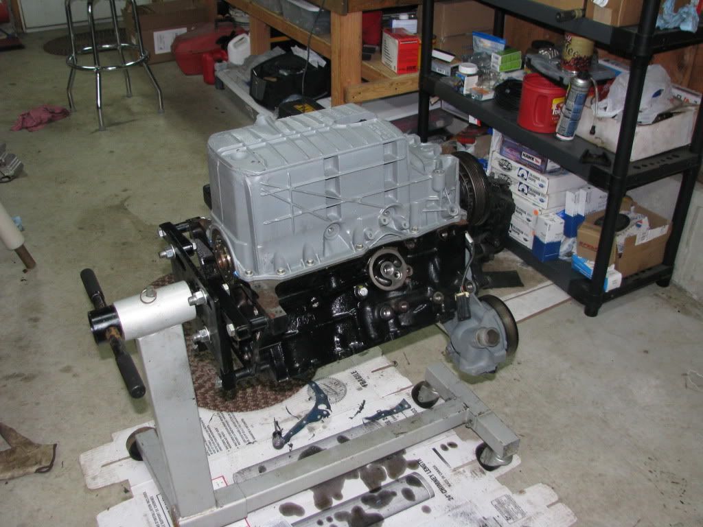

Installed crank scraper,
Timing cover and oil pan, and then wrapped it up till I get my 8 short studs from Ben when they comes in. And I need to bring my heads to the shop to have them surfaced and a valve job cut.

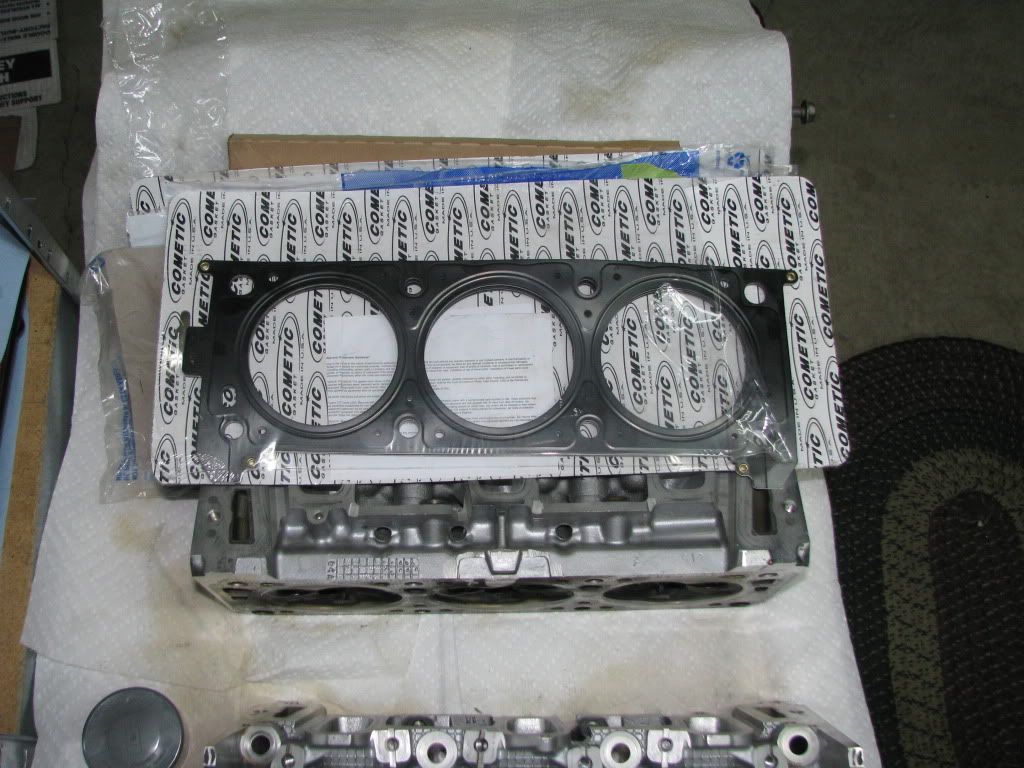

Cut a new set of stock gaskets to fit the headers.
The Cometic gaskets

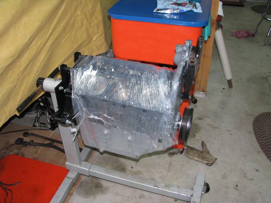

Well when you CC the chambers then they will all be the same size.
I'm not big on shrink wrap..... it could hold mosture in. It may be better to use a towel or two to keep crap out of the engine.
Re: January 2010 Project Begins (Raspberry)
The whole motor is soaked with oil.. I'm not worried about moisture. Also my garage doesn't get damp.
Plus its open on each end so it's really just there to keep crap out of it.

If shrink wrap keeps hose clamps out of the motor its worth every penny.
Very true Barry!
I do still have thoughts that there may be some moisture building up in the holes for the head bolts. But if shrink wrap wasn't used before the ARP's started to rust then what I just said is useless. Well, I was just thinking that the garage is cold and then was heated to do work.
Dehumidifier and dry heat would solve that 99% .
