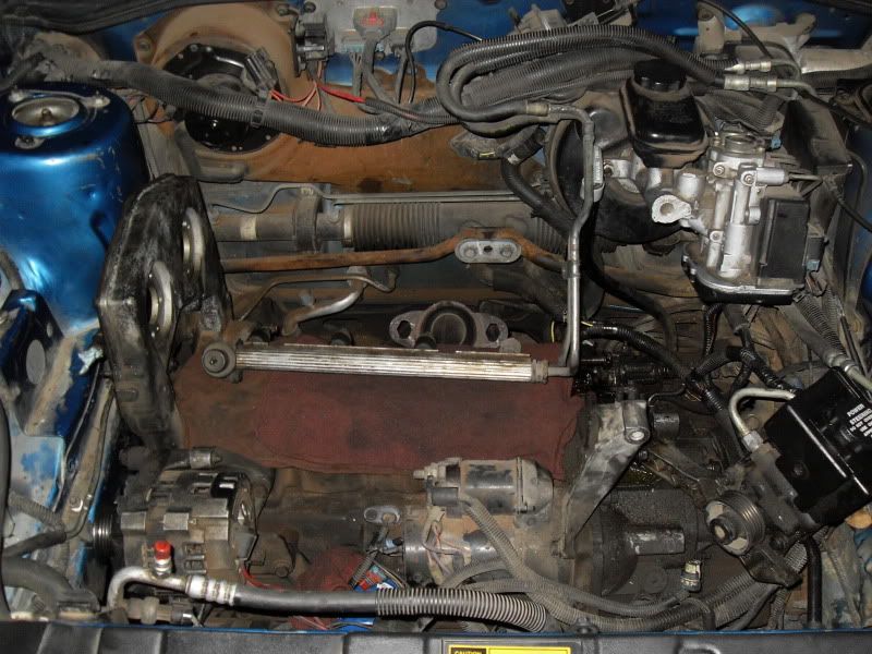

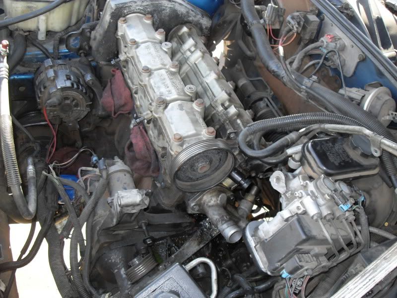

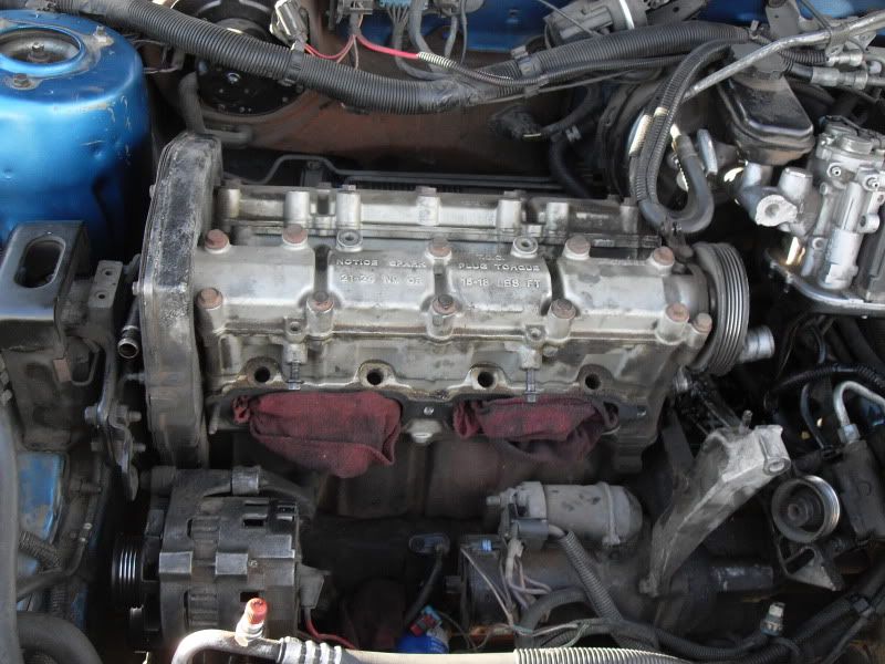

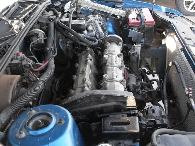

Ok, so basically made it to where I need to be to finish tear down tomorrow. Got a late start when I decided to rip the head off the car. Was only gonna do t-stat, water pump and heater core.
So, the only things I've got left for tomorrow are:
Motor mount removal. Outer timing cover removal. Crank pulley removal. Remove chain, tensioner, guides and chain. Unbolt cam gears. Remove head and cam towers. Pretty straight forward. I'm pretty well "there" at this point.
Gonna remove that nasty looking alternator and clean it as well as the intake while I have it out. I intend to replace the timing chain PVC hose that caused the mess in the first place too. So what started out a simple cooling system update turned into putting in an 086 head, HO cams, new Felpro headgasket, new Felpro head bolts,new timing cover gasket set, HO pulley, new water pump, new t-stat, and a heater core.
LOL!
Kinda reminds me of going to Walmart "just for milk" and coming two hours later with hundreds in groceries........ Sigh.....
Pics:
LOL!
Pics:

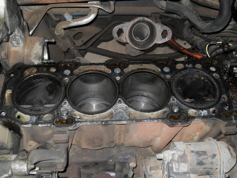

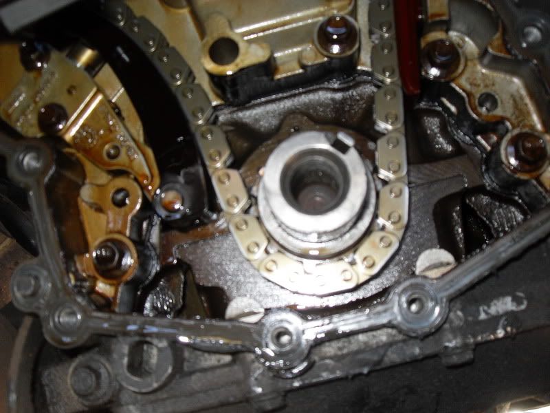

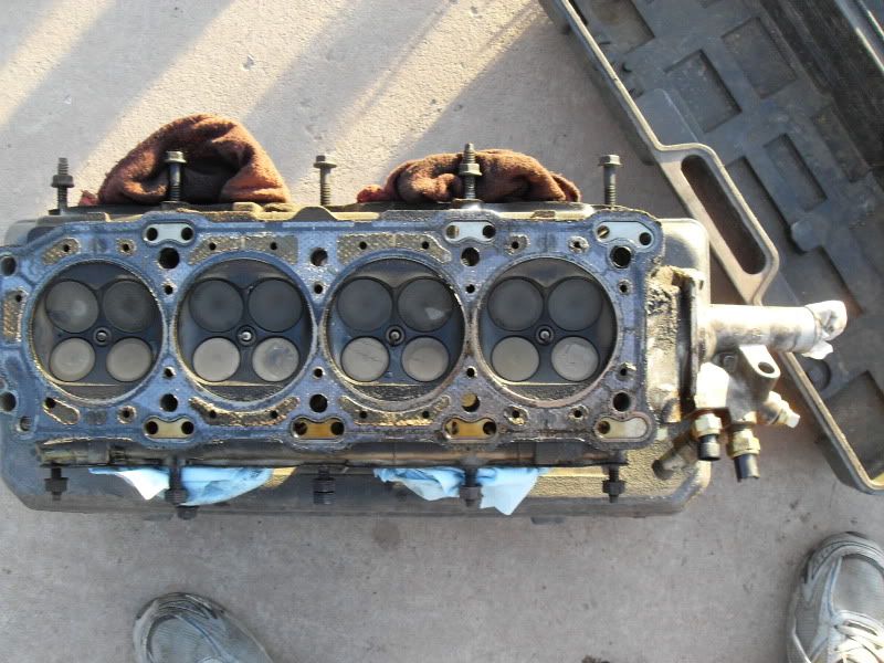

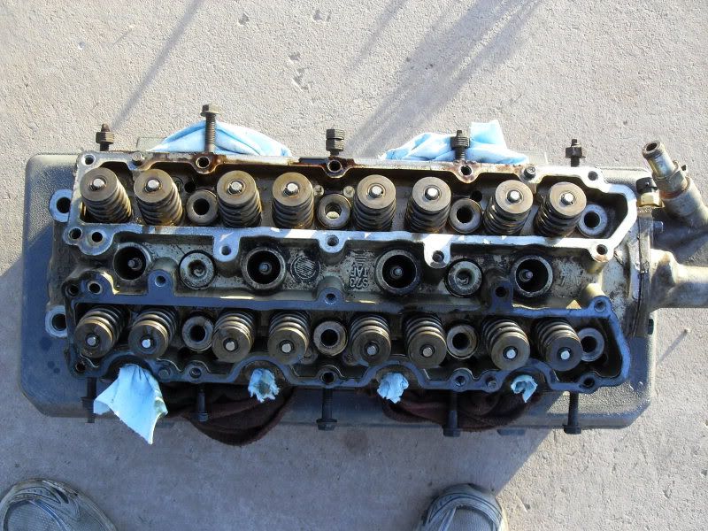

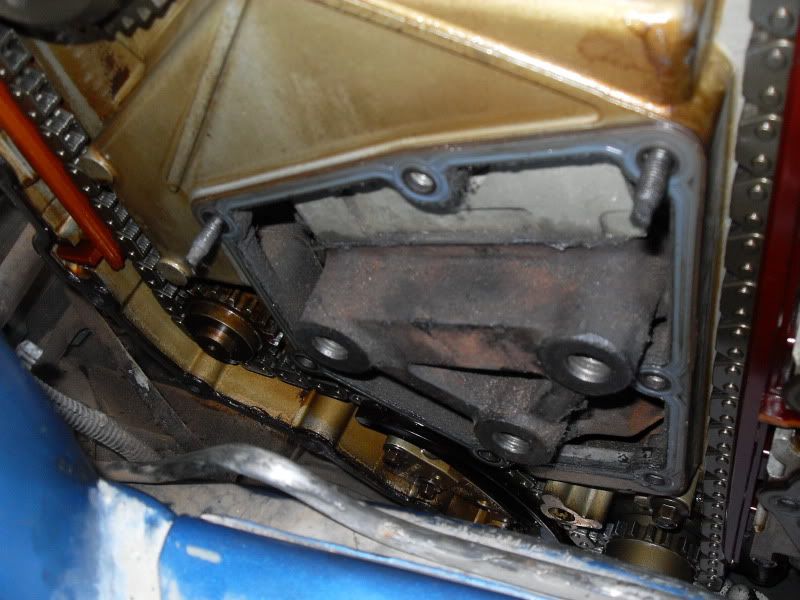

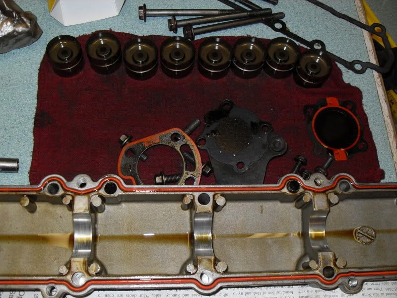

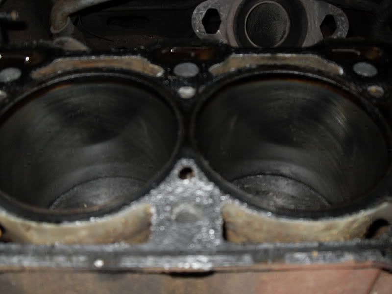

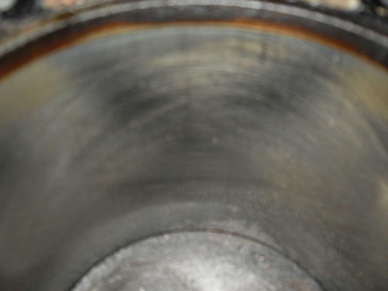

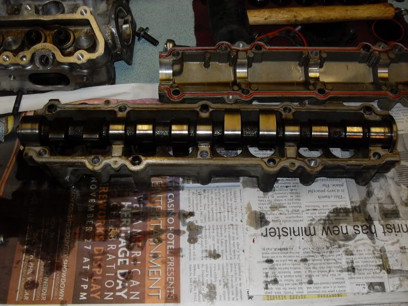

Ok, so day two.

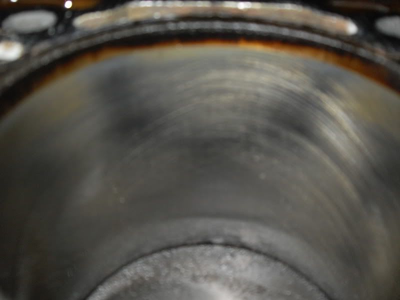

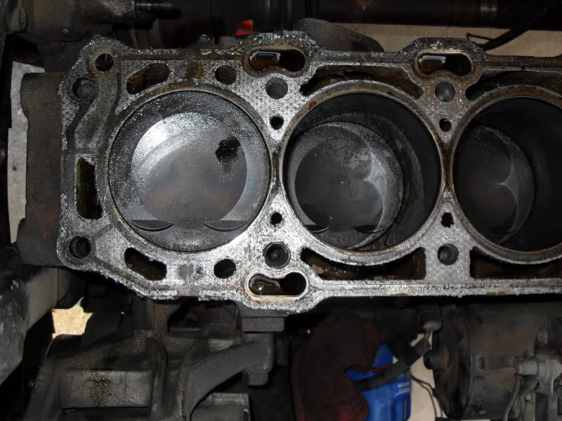

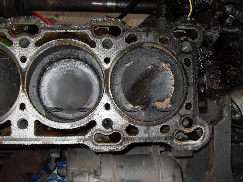

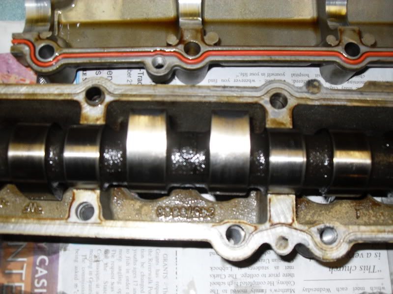

Today was a good day! Great day! Got the outer timing cover off to discover what is basically a BRAND NEW set of cam gears, crank gear, 3 guides, and tensioner! Very pleased! I also got the cams and towers out, head off and was ECSTATIC when I looked into the block!!
HO pistons and crosshatching!! WOOT!
Note the two valve reliefs in the pistons on the intake side in the pics below. Also pictured , the timing set.
I also got the cam housings apart and measured the cams. They ARE HO cams. Thank god for that. I have a few sets here , but still.....twas more good news. In fact they look to be VERY low mileage. Maybe 30k-50k. They look as nice as the 30k set I have for sale.

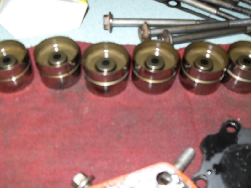

Lifters also look VERY low mileage. Pics below.
So.... while ALL signs pointed to an LO motor it is indeed and HO motor. Was being strangled by two things.
1. Shittiest head , maybe EVER , to be put on a Quad motor.
2. Poor torquing made for an apparent poor seal on the head/block. Looks like I know why I had hell bleeding this thing now and why the compression tests DEFINITELY came in lower than they should have. I BET when I get my 086 head on and torqued down, we see alot different compression numbers with ME torquing the headgasket. And with the MUCH better flowing head, power will be nicer!
Pics below of all, including cams from the engine,lifters, timing, cylinders , block and my girl tucked in and bedded down for the night.
And check out the cross hatching in cylinders 2 and 3. WOW! I about crap.
I'd say the head went, he bought the cheapest head he could find, that being the LO 456 head that has NO business on an otherwise HO engine. That is being rectified now obviously.
I would say this motor has no MORE than 50k judging by the shape of all seals, the condition of the head, cams and timing. Shame they fucked up the end game with a VERY poor flowing head and a bad job torquing the head gasket.
I'm TRULY looking forward to driving this again when completed!
Enjoy, and feel free to comment.

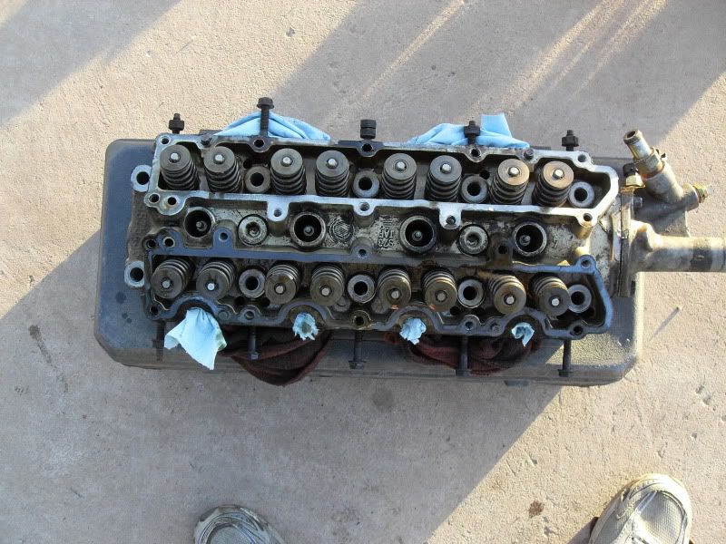

Re: 1992 Quasar Beretta GTZ - Top end swap in progress. Upda
456 cylinder head that was on then engine until today. Cams and lifters that were on the car and indeed HO. Also , last pic, all tucked in for the night.

So, I know I've been kicking back and forth on this, but the more I think about things, the more convinced I am this was a reman motor install with "slapped together parts.
I haven't actually eyeballed the crank casting number, but since ALL Quads (sohc, dohc LO , and dohc HO) all shared the same crank from '90-'94, I'm quite sure it's a 690 crank.
The block is a 661 casting number which was '92-'94 so it is technically the "correct" block. 927 blocks were also used '92-'94 for LO and HO. Both block numbers were "shared" by the LO and HO motors.
Head was WRONG. 456 heads do NOT go on HO motors. They used them on '94 LO motors ONLY.
HO Pistons (as witnessed by the intake valve reliefs).
HO cams , as micrometered out. So they are correct.
LO pulley. INCORRECT.
Cross hatching in the cylinders, indicating a fairly recent hone or bore.
Pistons look newish minus the carbon burn up top.
Head definitely looks "new" all around. Burning very clean, no buildup whatsoever as seen in pics.
To me, this all spells typical reman company cutting corners to save money by going with the more easily obtainable head and pulley. So, my logic and guessing, leads me to conclude this was a reman motor sometime in the last 50k or less.
I'm putting the correct 086 head and HO pulley back on the car, so in effect when I'm done this week, the car will be a full on HO as intended , meeting ALL '92 HO specs. Including the t-stat (only ONE this time,lol) in the correct HEAD location.
Car is also getting the brand new water pump.
Anyhow, bored and droning. Chomping at the bit to get her buttoned up, but I have some work to take care of tomorrow first. Gotta make a living to pay the bills and support my money pit and all that jazz....
I think the major difference between the heads, is how they flow. The HO's breathe better, if I recall correctly. lol
Not to mention all the small details that can cause performance differences. At least you will have it right when you are done.
