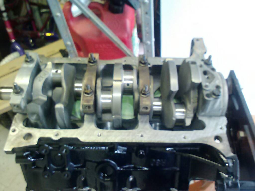

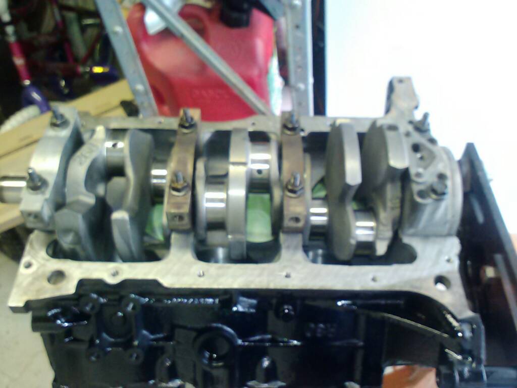

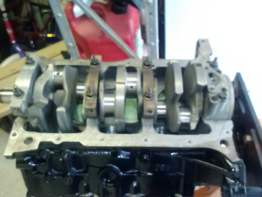

90GTZHO
- Posts: 1068
- Location: Paulden, AZ
Re: Project Second Chance - More On PG14!
Got the block mounted, cam plug installed, painted, crank dropped in and 2 slugs dropped in last night. Dont have pics of the pistons in yet though. More happening today.
- Posts: 10923
I have to say at least the shop appears to have done a decent job cleaning the block and crank... I know it was not that clean when you started.
