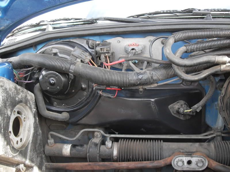

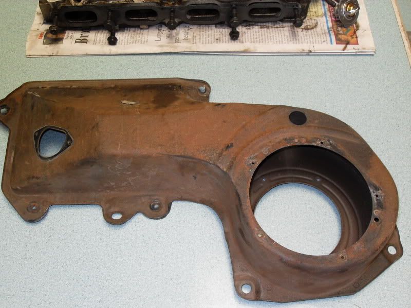

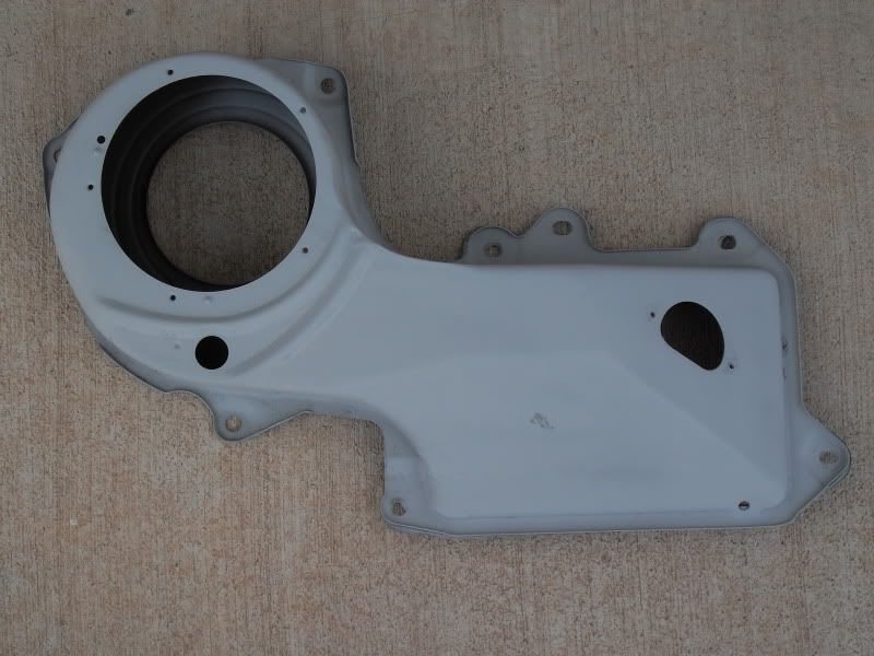

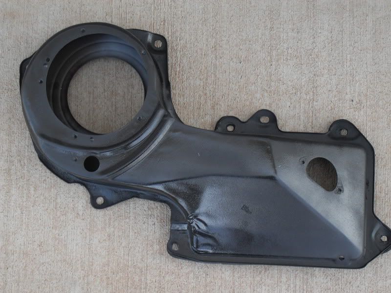

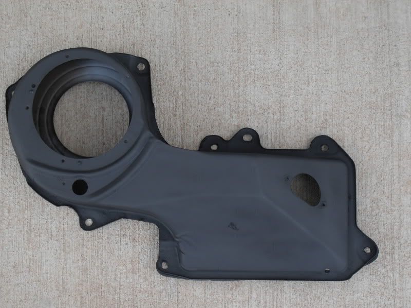

I took the blower cover off, and below you will see as removed (before) pic, primered, painted in black, clear coated, and two re-installed shots.
Quite happy with how it came out. To the critics, I'm no Ar-Teest, but I did pretty good I think.

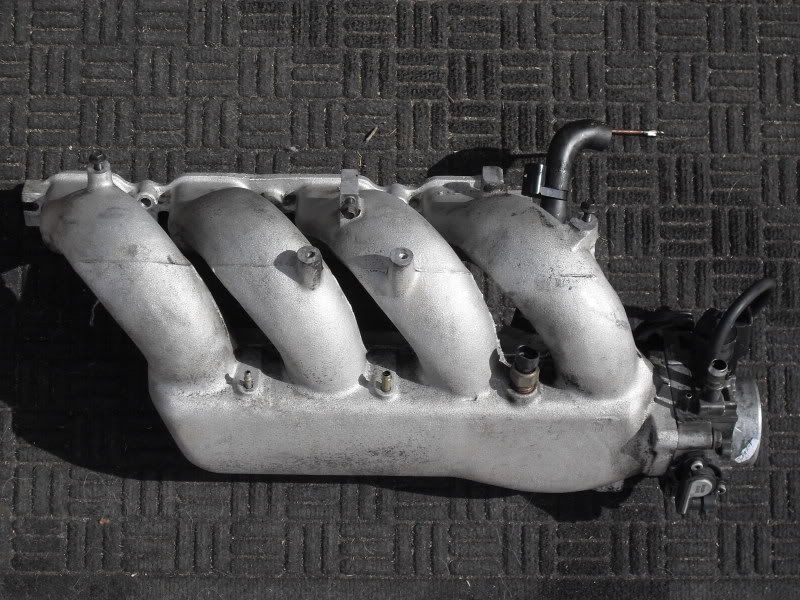

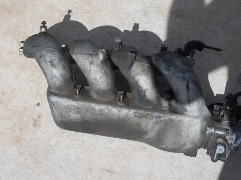

Also, cleaned up the intake. While it's MUCH better, I'll be doing a little more "detail cleaning" to it prior to re-installation. One before, one after pic. I should have taken a shot of how much nasty crap was in the rinse puddle as I was hosing it off. NASTY! Wonderful what a $2 can of walmart degreaser can do along with a tooth brush and some elbow grease!
Pics. Enjoy.

Re: 1992 Quasar Beretta GTZ - Top end swap in progress. Upda
I was looking at the inner timing cover and I do believe I will do it tomorrow. It definitely could use new paint. Get that done and my motor put back together and I'll be one happy mother trucker!
I gotta say though, I think that painted blower motor did WONDERS for the under hood looks!

Painting the blower cover is the biggest change you can make on these cars, Granted mine wasnt bad, but I sprayed it with a textured paint and it worked out great. I used textured stuff because I did not feel like trying to get a perfect finish on it.
Obviously a bit more changed, but to not have that rusty hunk back there looks much better.
