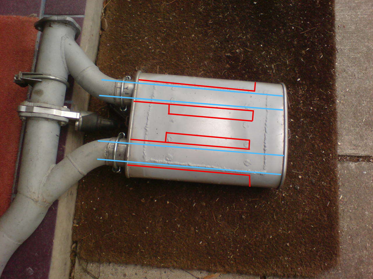

- In need to make my car actually to be silent on my 'silent-mode' exhaust, i cut open the sideways muffler to see how it can be modified.
This is how it was constructed, no wonder i didn't reach the sound level i was hoping for, and Dynomax calls this a street muffler... HAH!
With limited options to make the muffler actually silent, I stuffed in 80cm of 2" muffler pipe, this Should really do the trick. Lets see what happens.
Also with the muffler re-welded shut, it will most likely only last couple years before rusting.
Then I can just order new one, and modify it with only drill & screws, since I'm now familiar with the design and solution.
Now... Where are those damn bushings, i could already be driving this thing...
