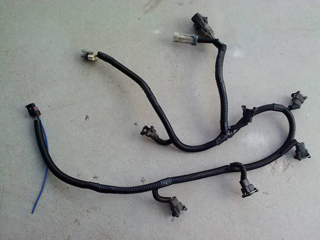

Pic of the nearly completed injector harness. I now have a weathpack connector on the gauge signal wire from the CTS.
I am going to be re-looming the CPS harness to the coil pack and getting that attached as well. Dont think theres much of anything left to do but install

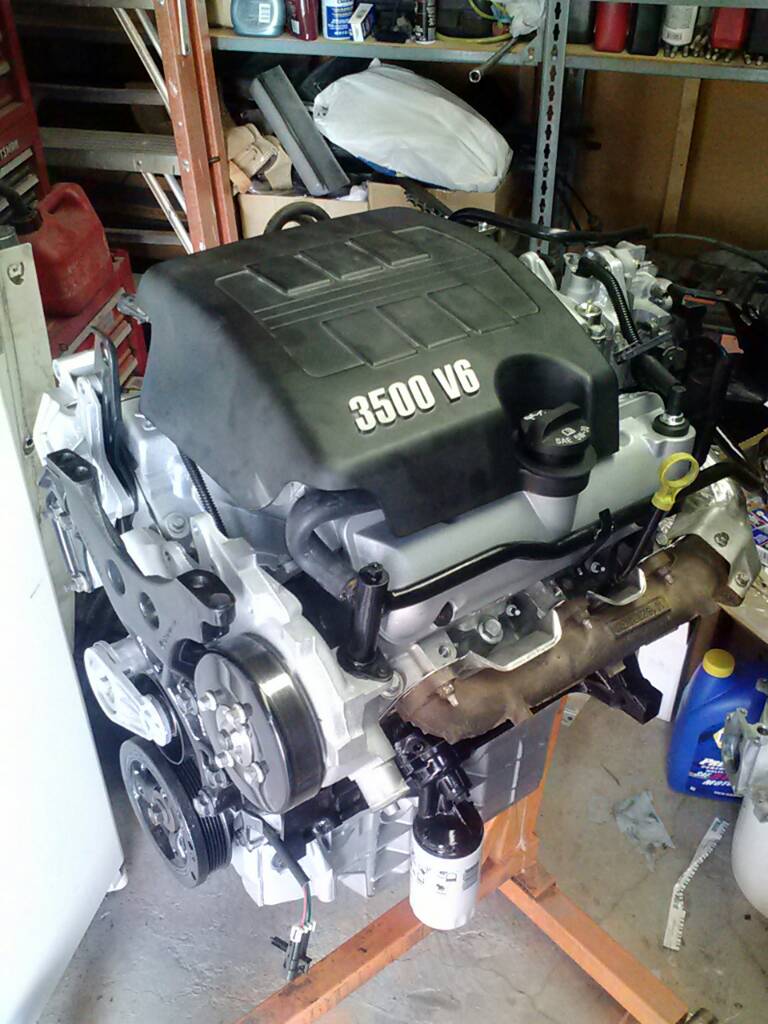

So, once again, i put a percentage value on the completion of the engine. I now i have all parts, but one. I was at the yard and picked up a heater to water pump pipe from an 89 V6 Corsica, and that was not so fun to do let me tell you lol. Once i figured out how the hell the damn thing came out, not too bad. I also pickup the A-body heater tree, which as mentioned, is the same as the 2nd gen Venture/Montana vans. Lastly, pick up the fuel rail support bracket that bolts to the rear head. I can finally get the engine 100% to drop in. Im excited. However, my head gasket "repair" has failed, so time to get the swap done.
Injection harness installed
Intake Manifold back on
Vacuum line routing off the TB. The one hanging out is for the vacuum line that used to go to the trans.
T-stat and housing installed, and tapped the threads for heater fitting.
Crank position sensor wired in
Removed the heater tree for the A-body style, that will be installed tonight most likely.
Got the belt tentioner installed finally. Was able to find the right length bolt to mount it.
Its go time! IT...IS...GO....TIME! Woo hoo!!
Re: Project Second Chance - Fresh Update PG 17!
Wow. That engine is amazing. Everything looks so clean and professional. Will be awesome to see it dropped in

Thats cause pretty much everything on it is new lol. Obviously the engine is rebuilt, but i dont like dirty engine parts. If my hands touch it, it will be clean and painted.
