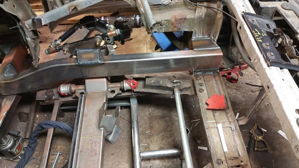

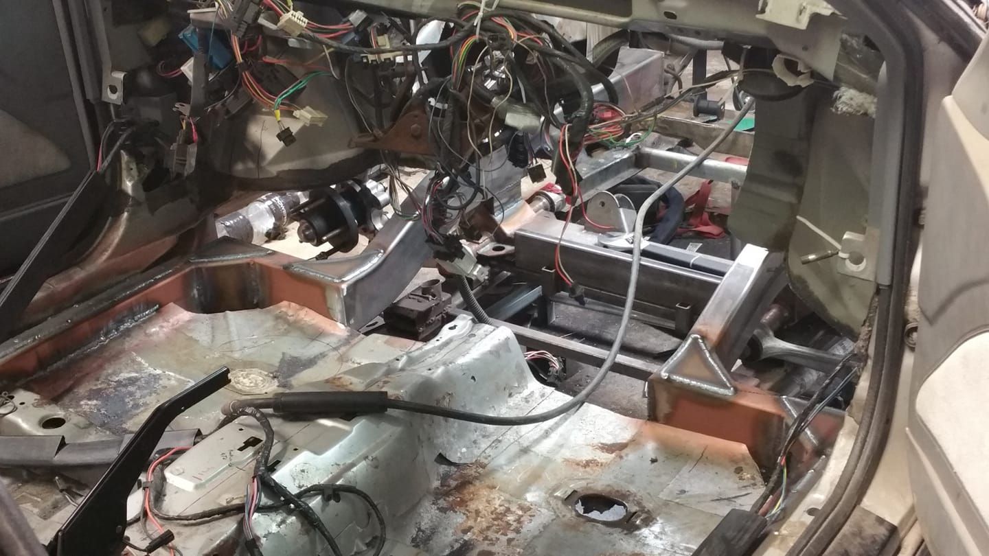

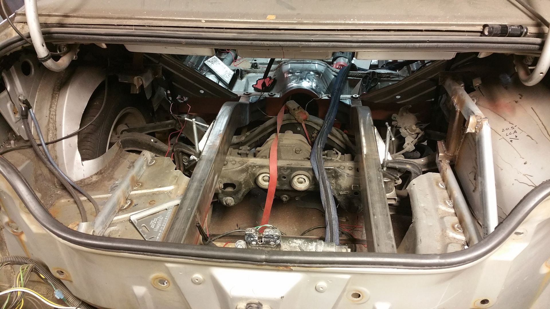

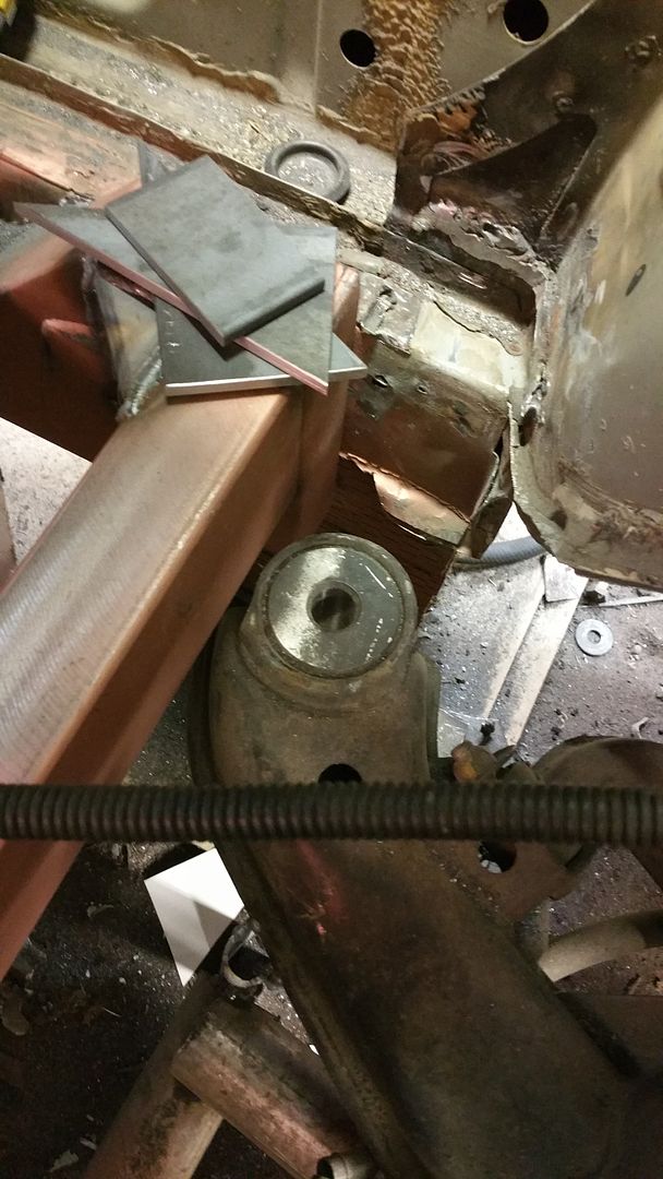

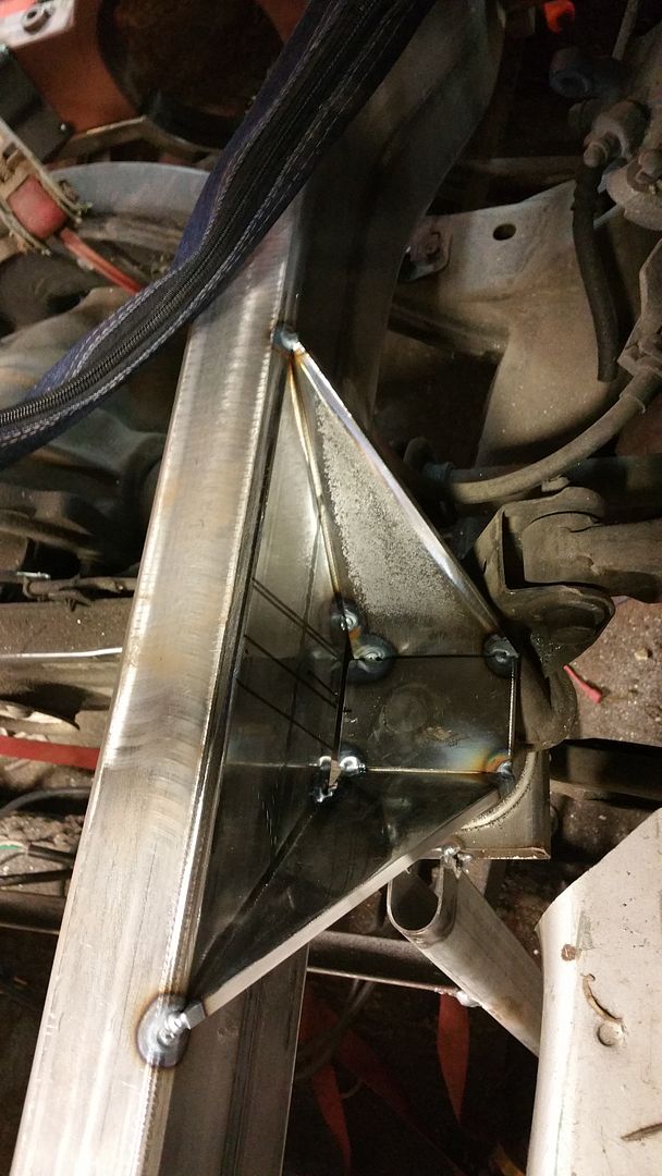

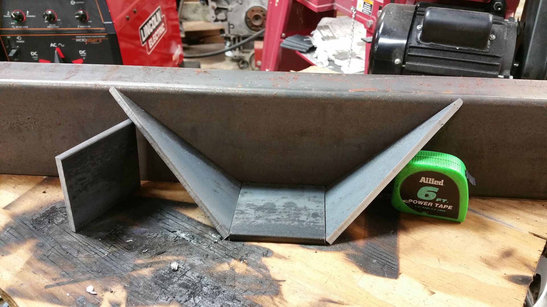

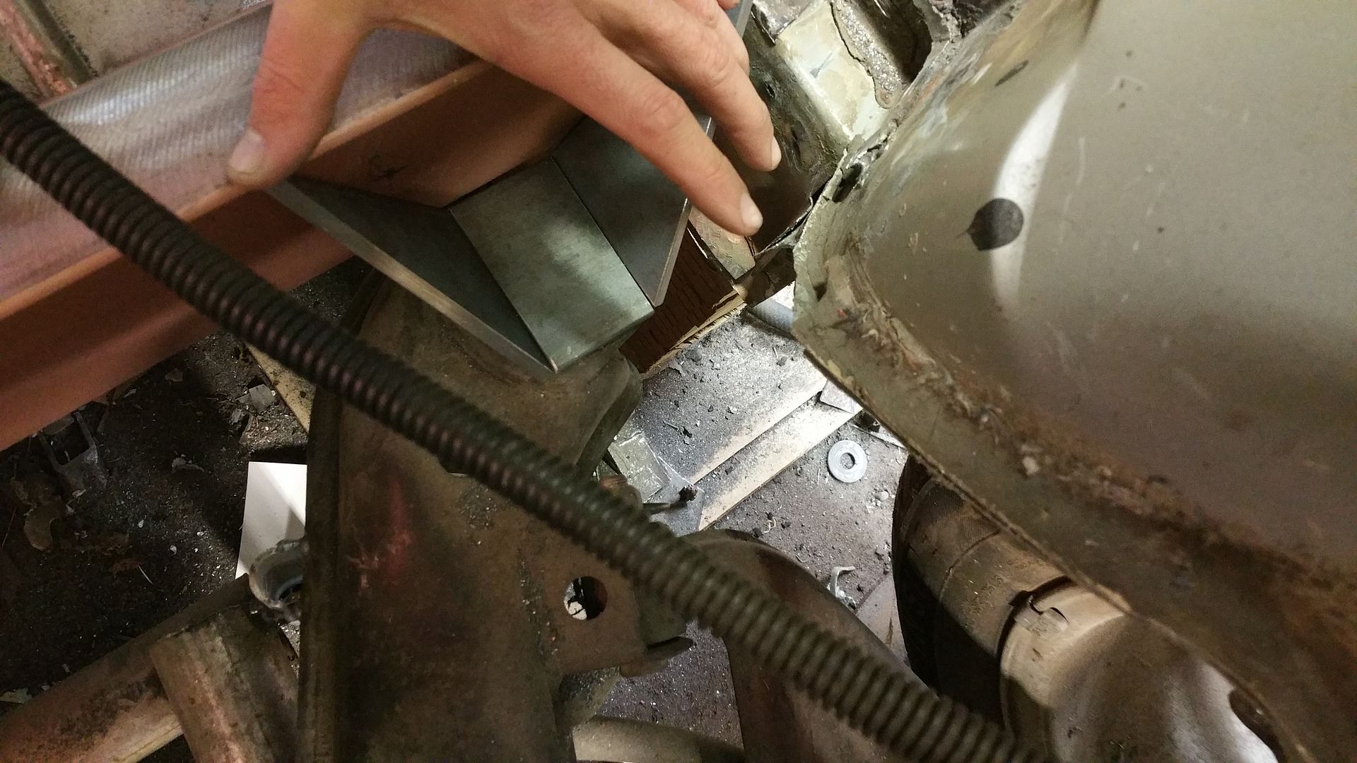

This is the theory on my rear subframe mounts. Made from 1/4" flat stock.
tacked in
front side

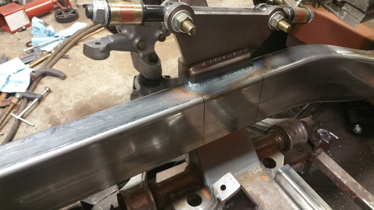

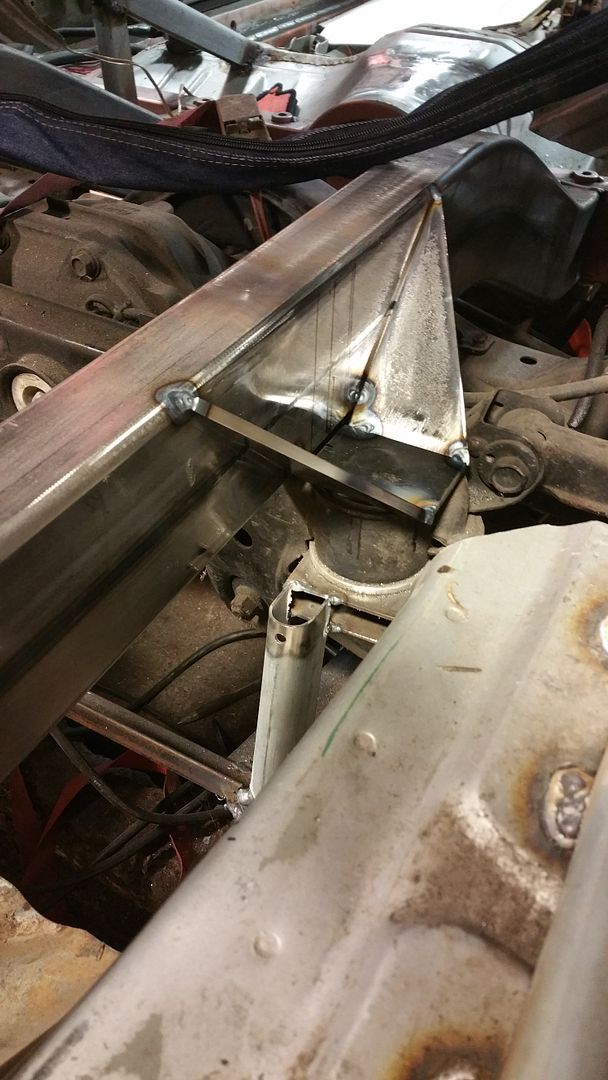

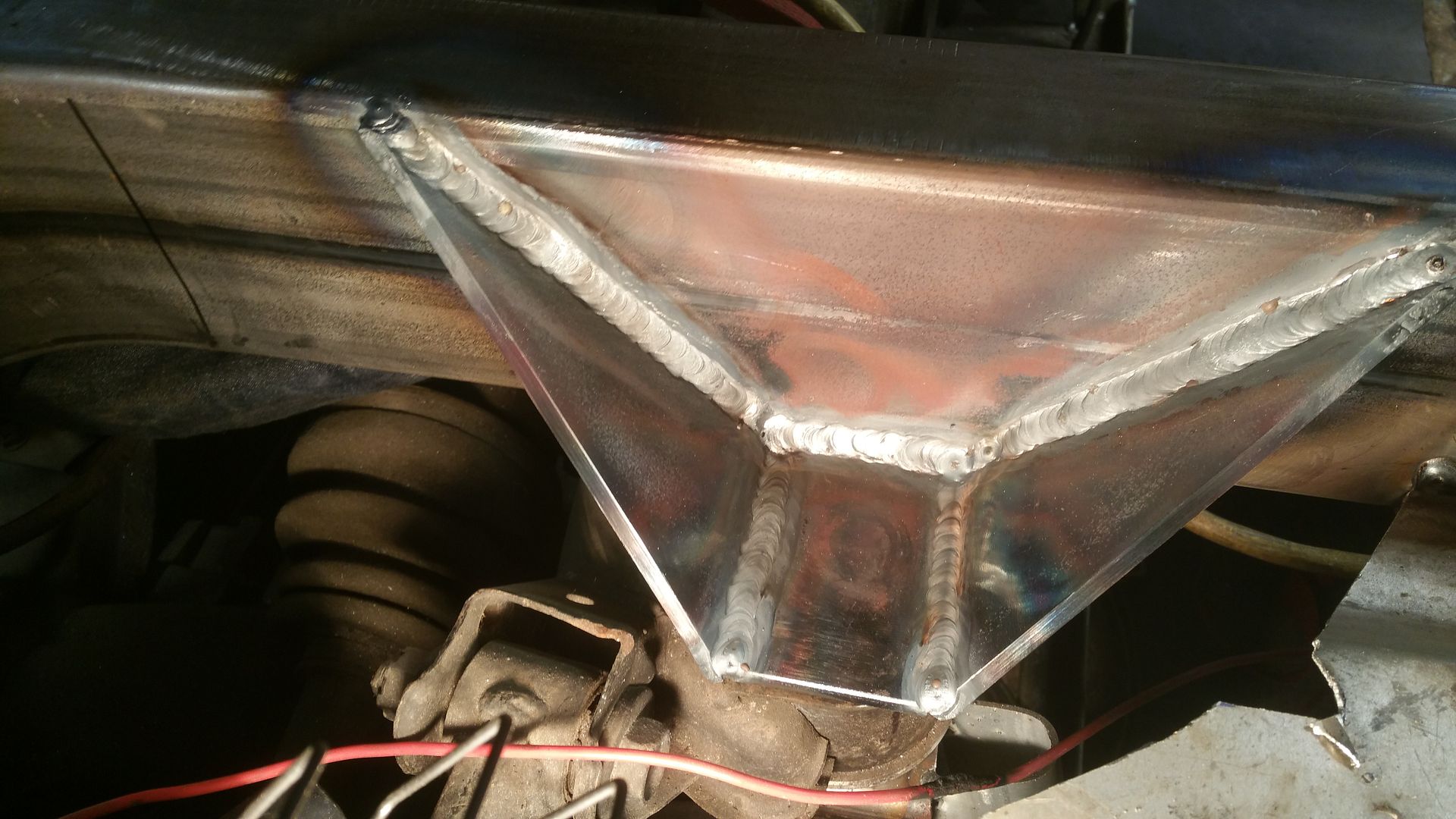

tigged in! it is an absolute whore trying to lay in the trunk of a car, control the pedal with your elbow, feed filler rod, and work the torch.

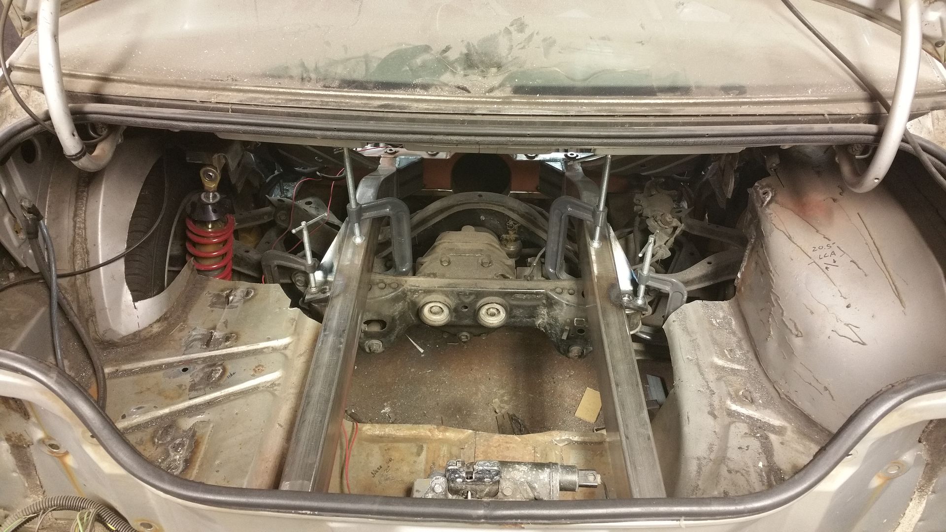

and this is where it currently sits!! subframe is held in by C clamps, I have all my hardware to bold it in except for my weld on nuts which are in the mail. I might add a few extra mounts on the subframe for good measure but undecided at the moment.

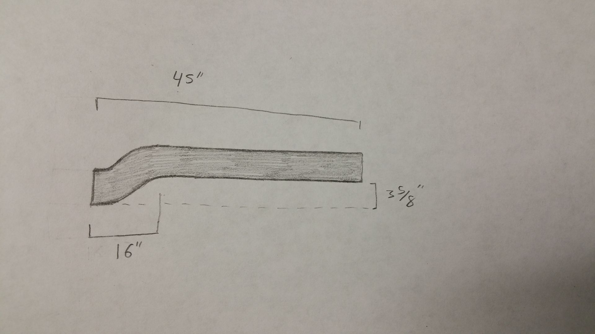

just got confirmation from Art Morrison today that they can bend this in there mandrel bender. I will be placing my order for 2 of these next week. This is the front frame rail section!
tacked in
front side

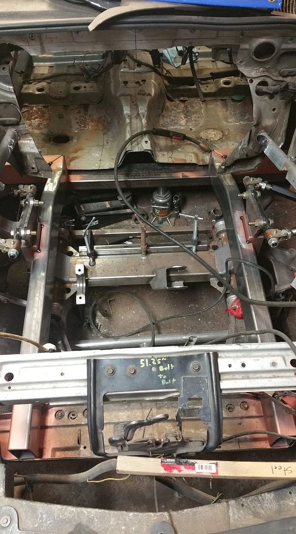

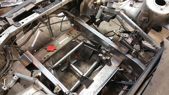

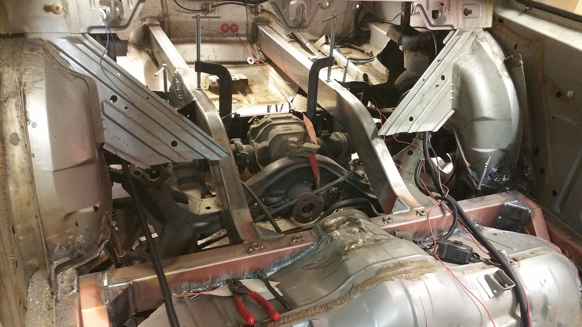

little bit of an update..
Rear subframe is bolted in.
Making sure everything is still squared up.
Frame rails!

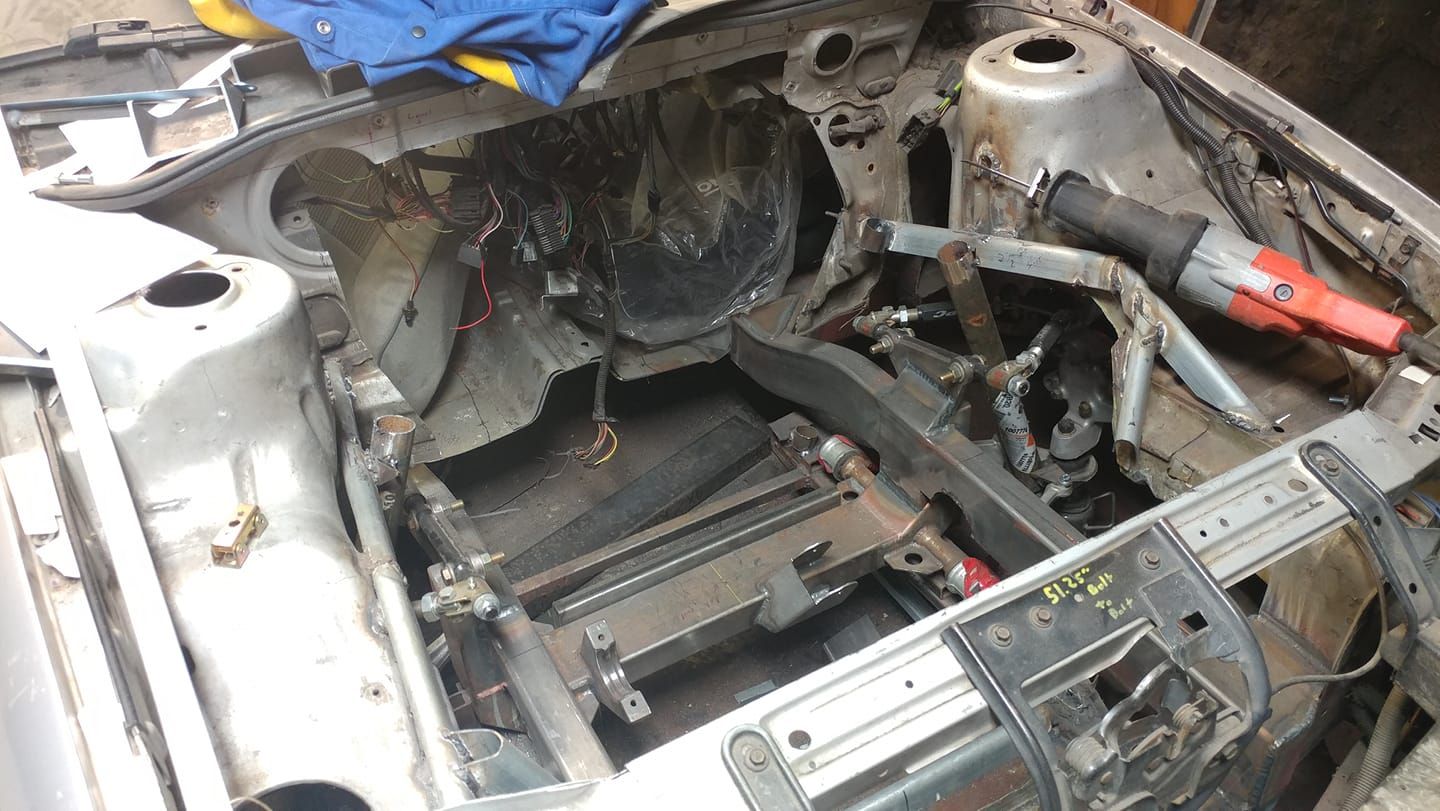

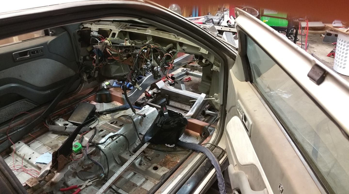

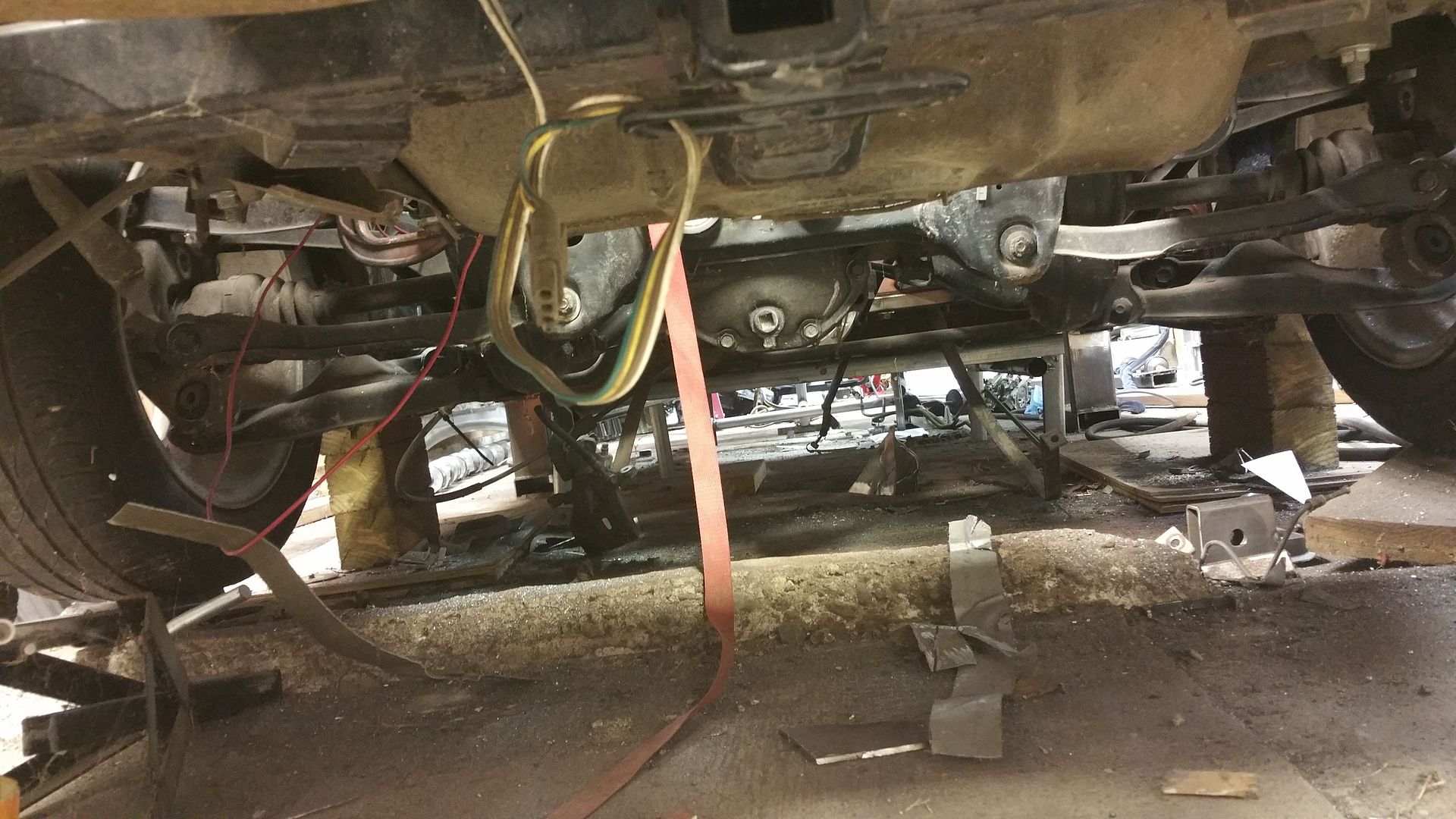

Cut more of the floor out
More test fitting and mockup.
It begins.
Notched out. Ended up deciding to give the tires 1/4" more clearance, which will make the headers a bit more of a challenge.. but I think its the right choice. Support is in the way so it doesnt fit in this picture. Wasnt ready to cut it out.
Closer.
and it fits.
The current state. Very minor tweaking, little bit of prep to go. I could have welded it up tonight but im not sure what to do with the front of the frame rails to tie it all together. Have to put some thought into it.. Its VERY close to rolling. Very close to getting engine and trans mounts..
One idea is to cut the front off and put my cage through it. Not sure if its a good idea yet...
Frame rails!
It begins.
Closer.
and it fits.

Finally doing an update! I thought I had more pictures but I guess not... had to take a break to get my gambler500 car ready and do a bunch of work on the house. I feel like ive made pretty good progress tho, getting back at it again!

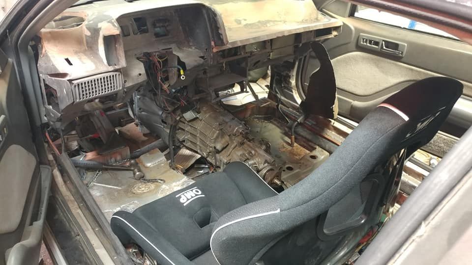

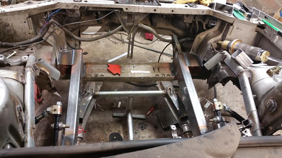

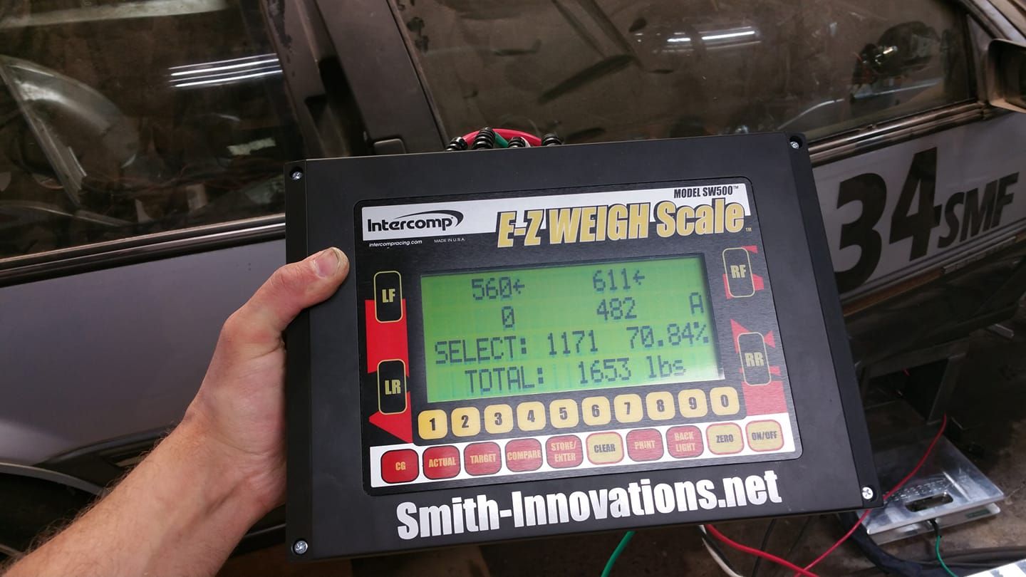

put the car on the scales just because. No engine, and it was just 1 scale in the back.

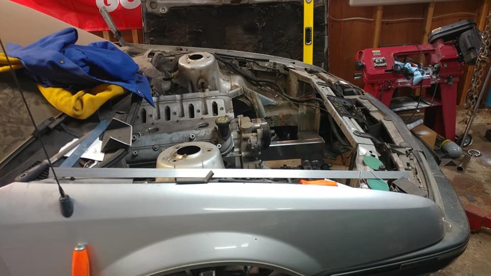

you can somewhat see bracing finished up by the control arms, upper and lower. Also got the frame notched out for the steering rack and boxed back in. The steering rack is a bit tighter than I had hoped... Guess I did something wrong on that lol. It does fit but not easy to get it in place!

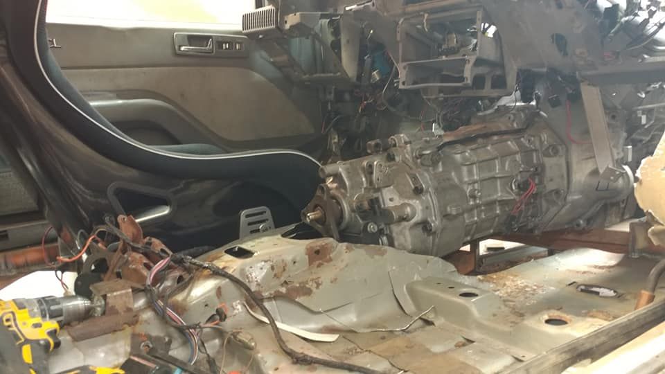

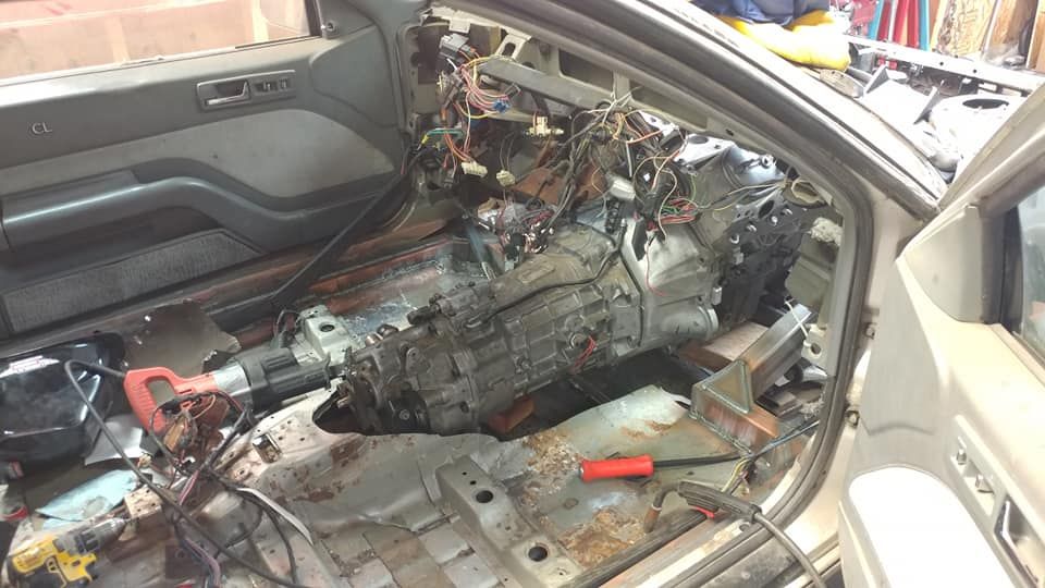

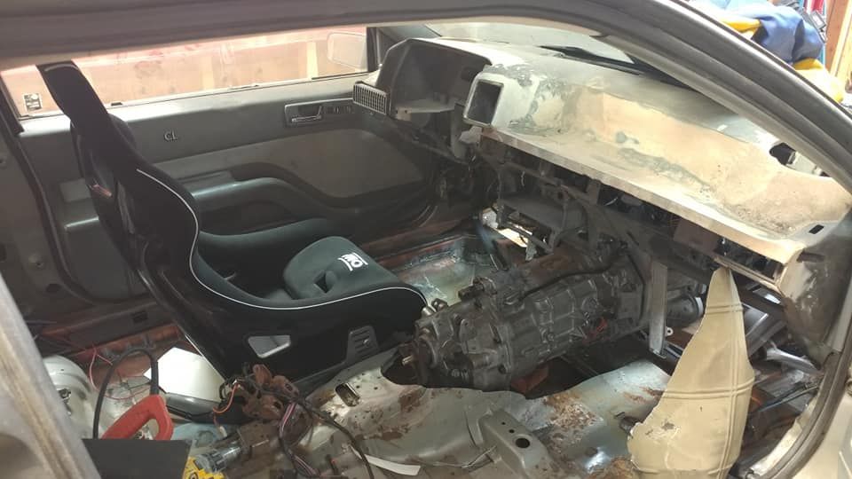

JUST about where the engine and trans is going to sit. Its currently within an 1/8" side to side, angle is within 1* with the rear diff. Just need to get a measurement on the driveshaft angle still but I think it will be correct.
Just a quick mockup, I was curious. That transmission is massive...
I have parts to build engine/trans mount parts in the mail, Need to swap my tail housing on the transmission to the fbody style before I can do the trans mounts tho.

Yeah, those T56 are huge. I had to cut the piss out of my Camaro tunnel to fit it, and that was already RWD! Loving how this is turning out. I see it's 5 years from your initial post. How much of a head start did you have before posting? Just curious.

It was 2811lb with full interior, stereo, and me @ 150/160ish. I have no idea how it was so light with that and power everything. I didnt really do much to reduce weight I dont think

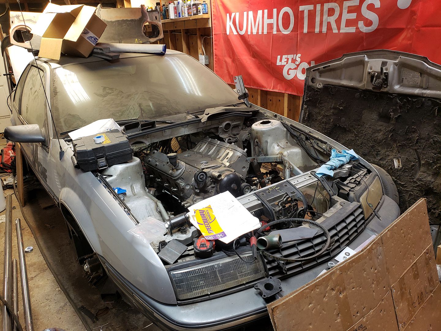

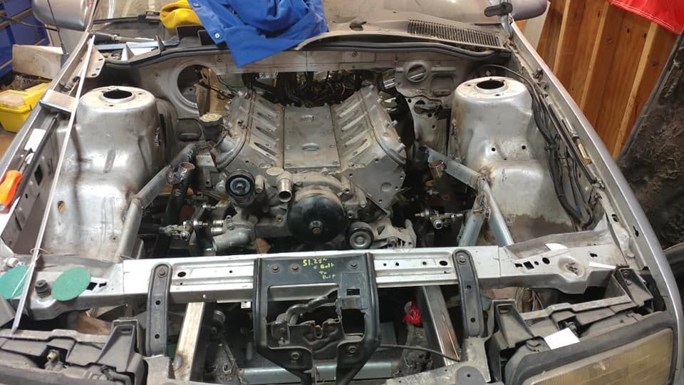

I don't have a huge update, But Its been a long time since I've even had a chance to work on the thing. My life has been consumed by work and sleeping for almost a year now.. plus all my many other small projects I dont have time for.. had a small break working 50s for a month or so but its back to 60s next week lol. But its a good thing for the car in a way. I have been collecting stuff for it, and im pretty confident it will be getting an LS3 when the time comes.
the engine is ready to mount, I just need to pull it out and clean off the minor surface rust before I weld the mounts in. Thats a day ordeal.. I just havnt been able to commit myself to it sadly..

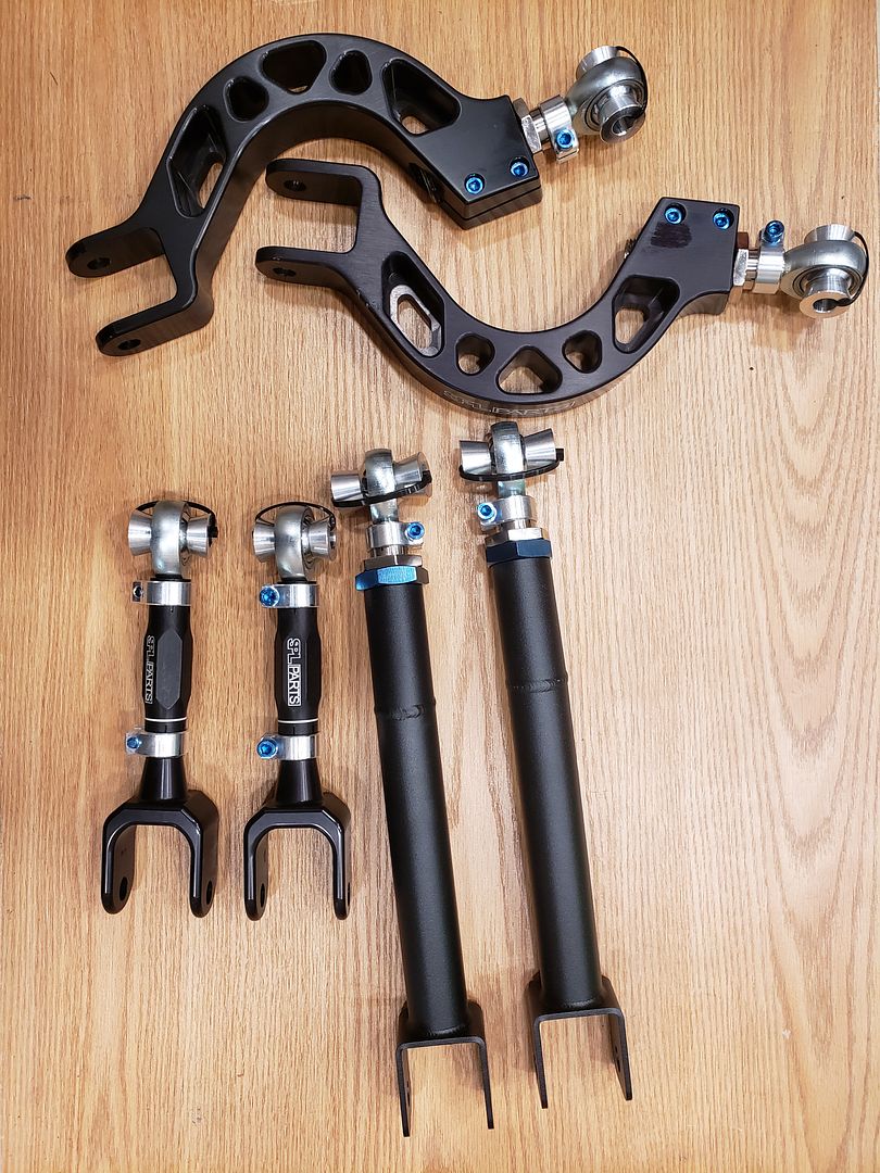

SPL rear suspension components, titanium hardware, billet, and chromolly. I still need to decide on the lower control arms, SPL does not make them sadly.. Best stuff you can buy in my mind.

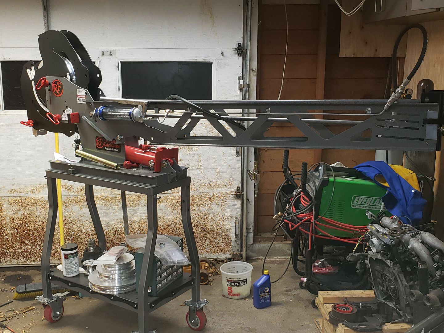

I also was able to add an upgrade to my bender. Its now a mandrel bender! So that means.. mandrel bent roll cage! Just need to do it.. but having the equipment is half battle!

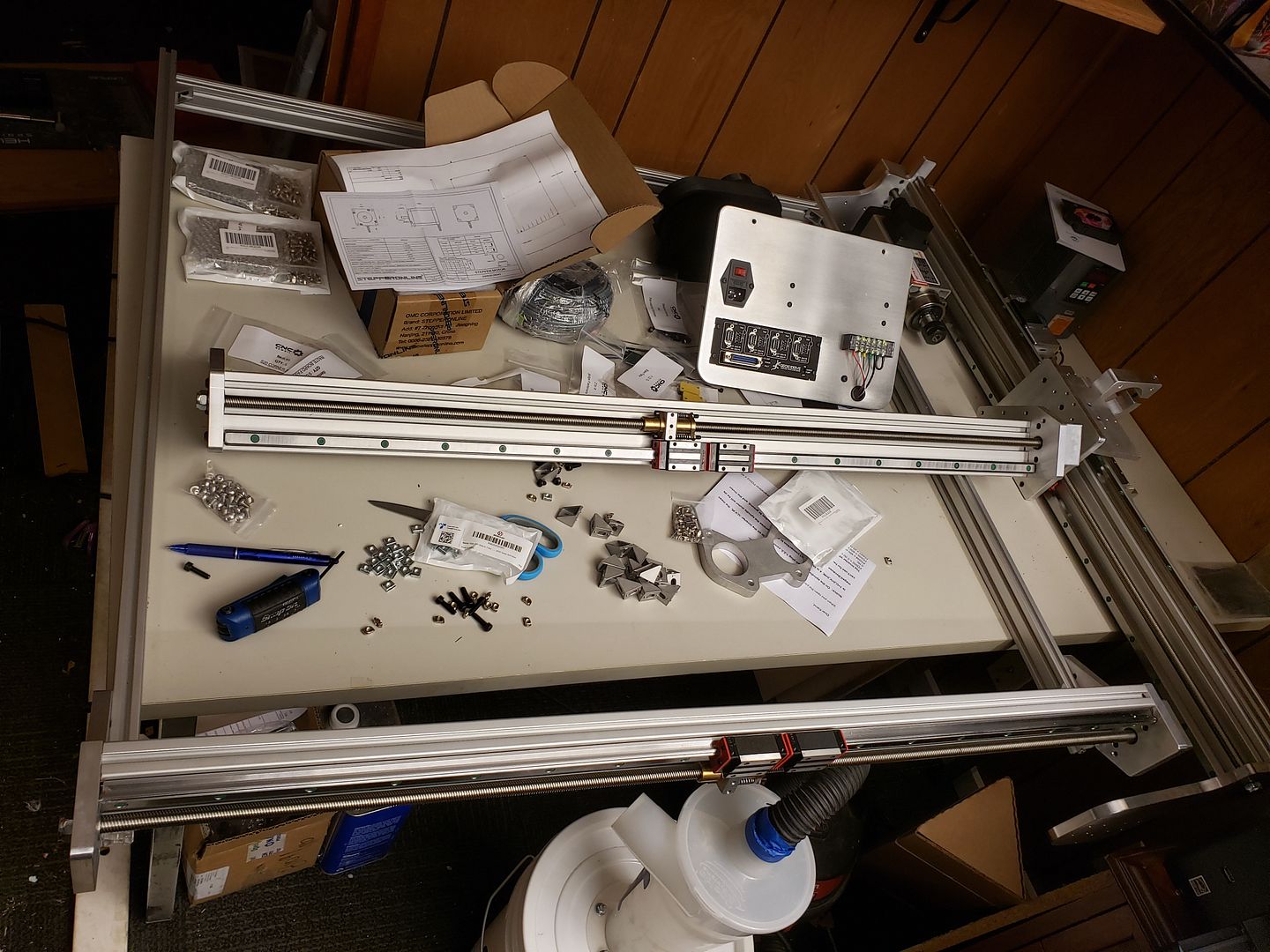

also working on building a cnc router so I will be able to make my own parts out of aluminum and take the build to the next level. I dont know what im going to make yet for it.. but ill find plenty of things im sure. Actually got it for a few projects on other cars.
yes.. it gets better.. I have a cnc plasma cutter on order too.. ill be able to design and cut all my own brackets and anything else I might need. Pretty excited about it!!
once I get my garage cleaned up again (working on it now) I'll be more motivated to spend an hour here and there working on the car. Engine is getting mounted this winter.. It has to happen.
